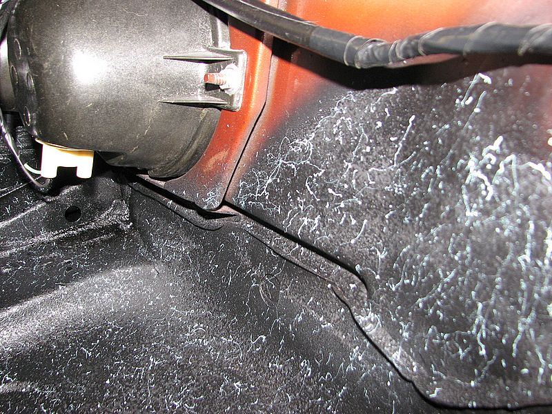

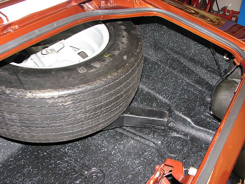

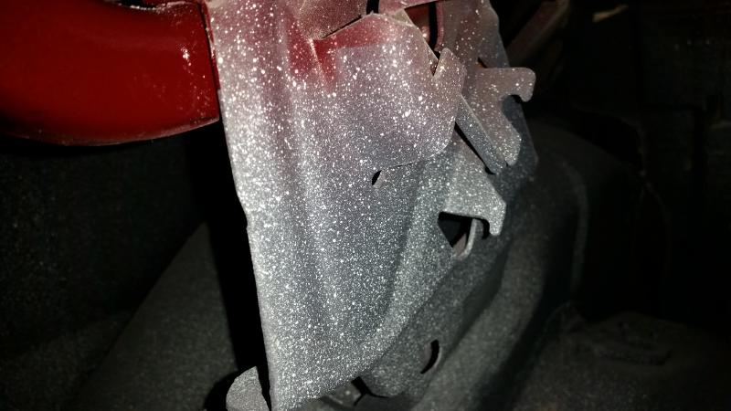

Anyone have any experience with this product? I dont have anyone local that can do an authentic trunk spatter paint.

I used it. I was not happy with it. I felt the color gray was too light and the splatter was hard to control. It would spit out large spots that you would have to go over and re-do.The video shows the car on it side on a rotator. This would probably be beneficial so you could keep the can up right/parellel to the surface you are spraying. It seems the large splatter spots came when the can was tilted. My two cents.

This is how the strings looked after spraying this 70 Camaro with the Berlage product. After a recent conversation with him he told me that the EPA forced them to reformulate it and it does not spray out as nice if you are wanting the stringy look.
