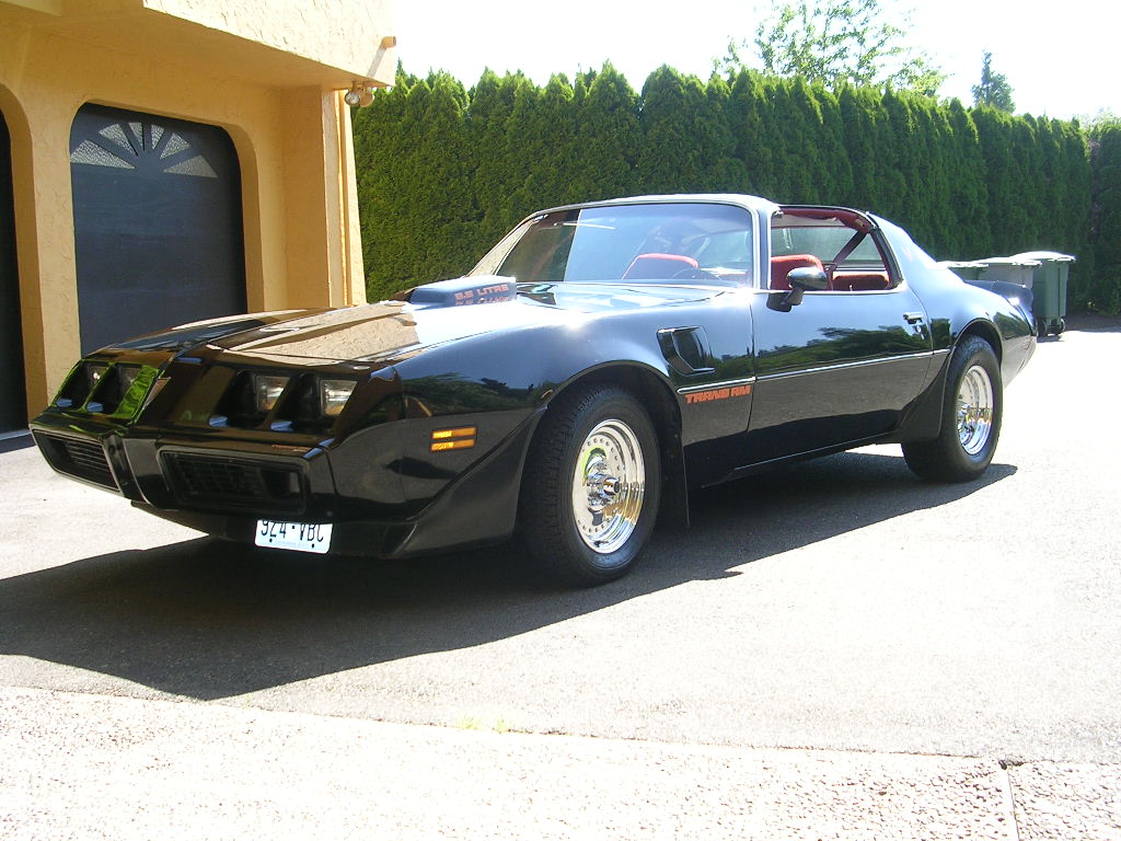

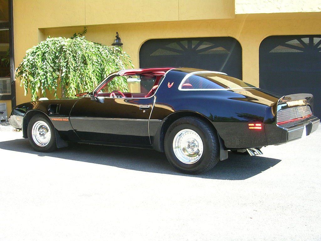

you can fit allot of tire under the back of them...I think...been awhile... a 265 60 15 fit nice and tight and didn't rub if you offset the rim about 5.5 to 6 inboard....here is that tire on a 15x8 5.5 backspace on the 79 TA I had

side shot.
