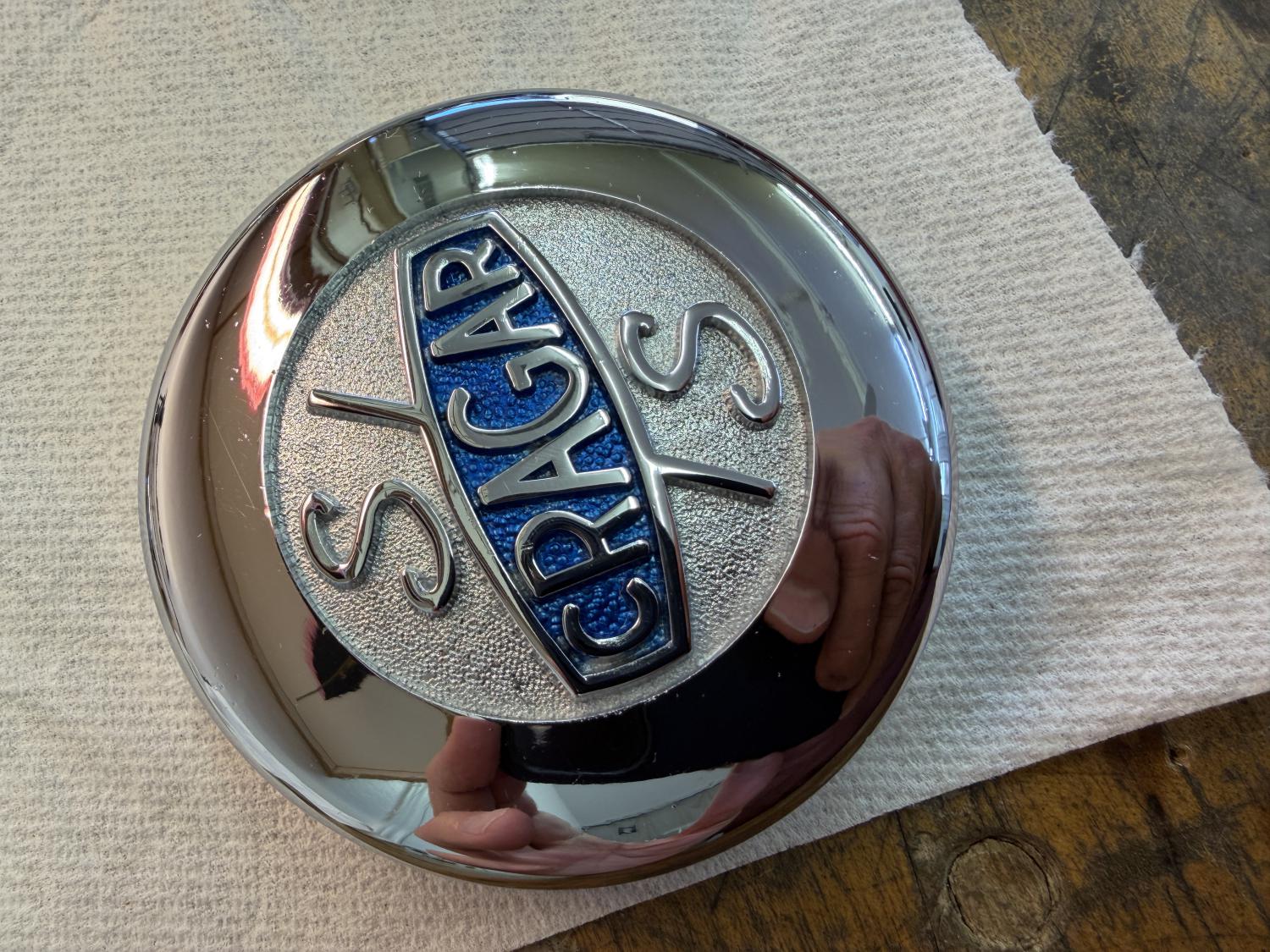

Default Cragar SS center caps paint
Have original Cragar SS rechromed. But does anyone know the correct blue paint and where to buy it?
Tks. Doug

I use a testor's "sapphire blue". Not sure the number, but there's probably only 1 choice at your local hobby store. The 8 are repainted, the single is original untouched.

Wow. Perfect. Nice work.

DRC Bowtie, after replating your center cap was the center texture look still intact? Got a picture of one of your replated caps?
Originally Posted by 1967 4k View Post
drc bowtie, after replating your center cap was the center texture look still intact? Got a picture of one of your replated caps?
Thanks
See pics. I'll get the name of the chrome guy also

The key to doing these caps is to NOT compromise the inside pebble grain area. Hard to do, but doable. they always have to put a layer of nickel and chrome over it, and it does lose some of the grainy look. Here is an NOS one .
