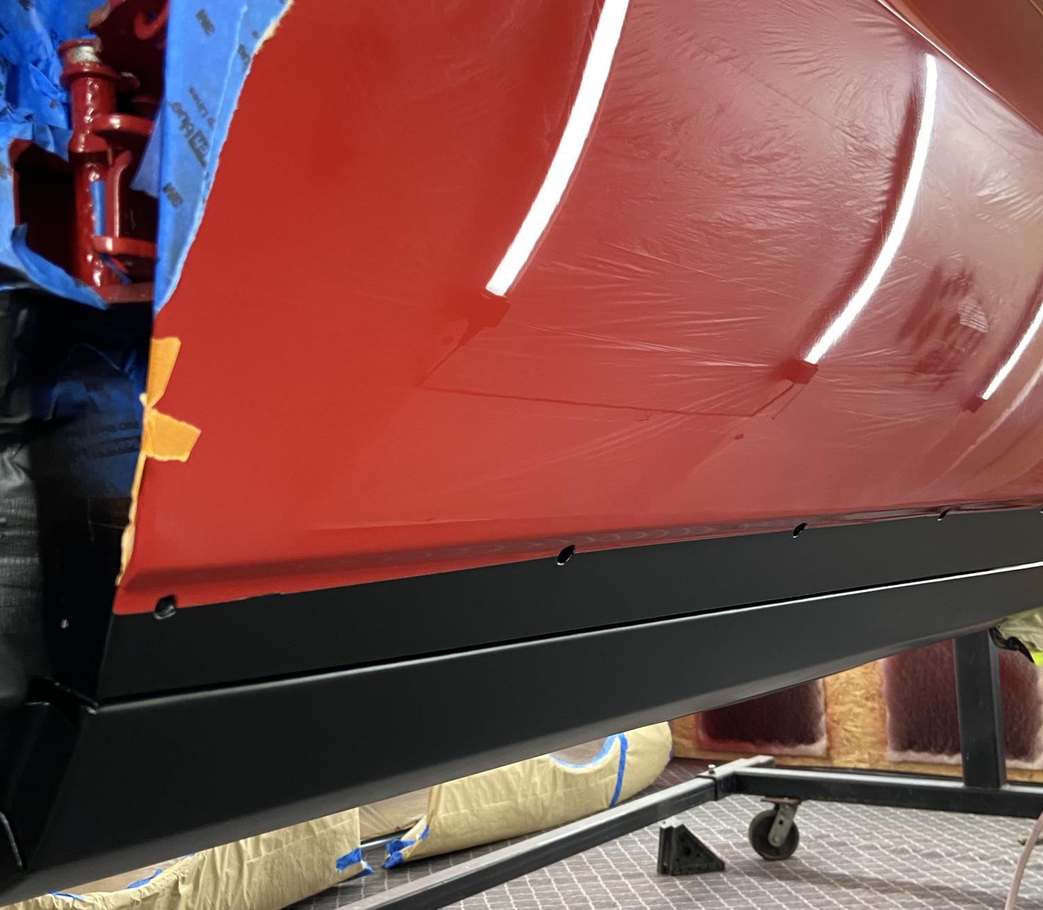

Blackout done. This is SPI Matte Black single stage paint. Mixed 4:1. The mix ratio controls the level of flatness. From 4:1 to 8:1 which is totally flat zero gloss. This should dry to a nice semi gloss eggshell.
