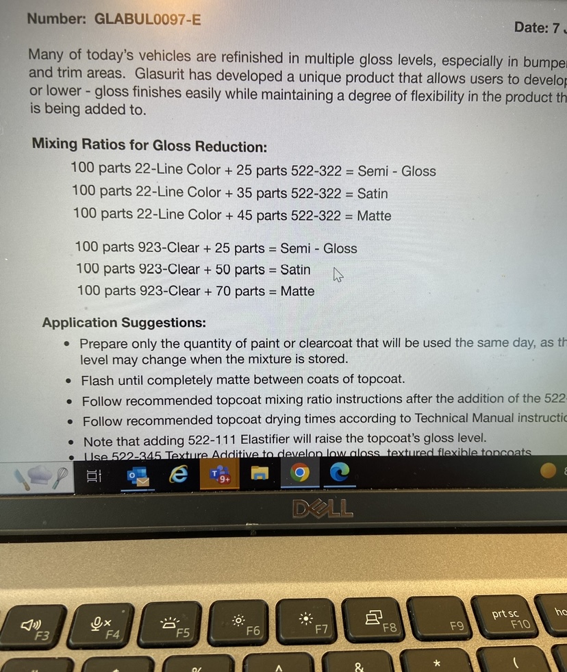

Yes. This 1968 chart shows the gloss level for the various interior components and what colors go with the trim tag number. The ones I marked happen to be for my 725 interior for the dash top and general interior paint.

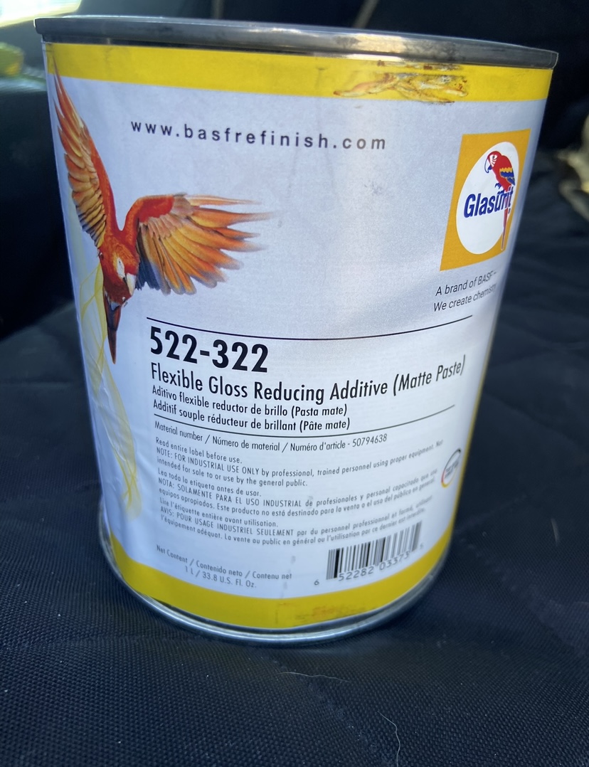

Also this is the flattening agent I used on the dash face and glove box door.

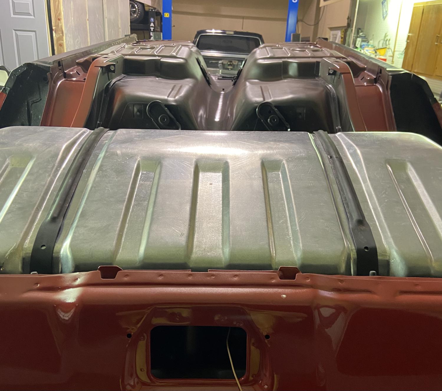

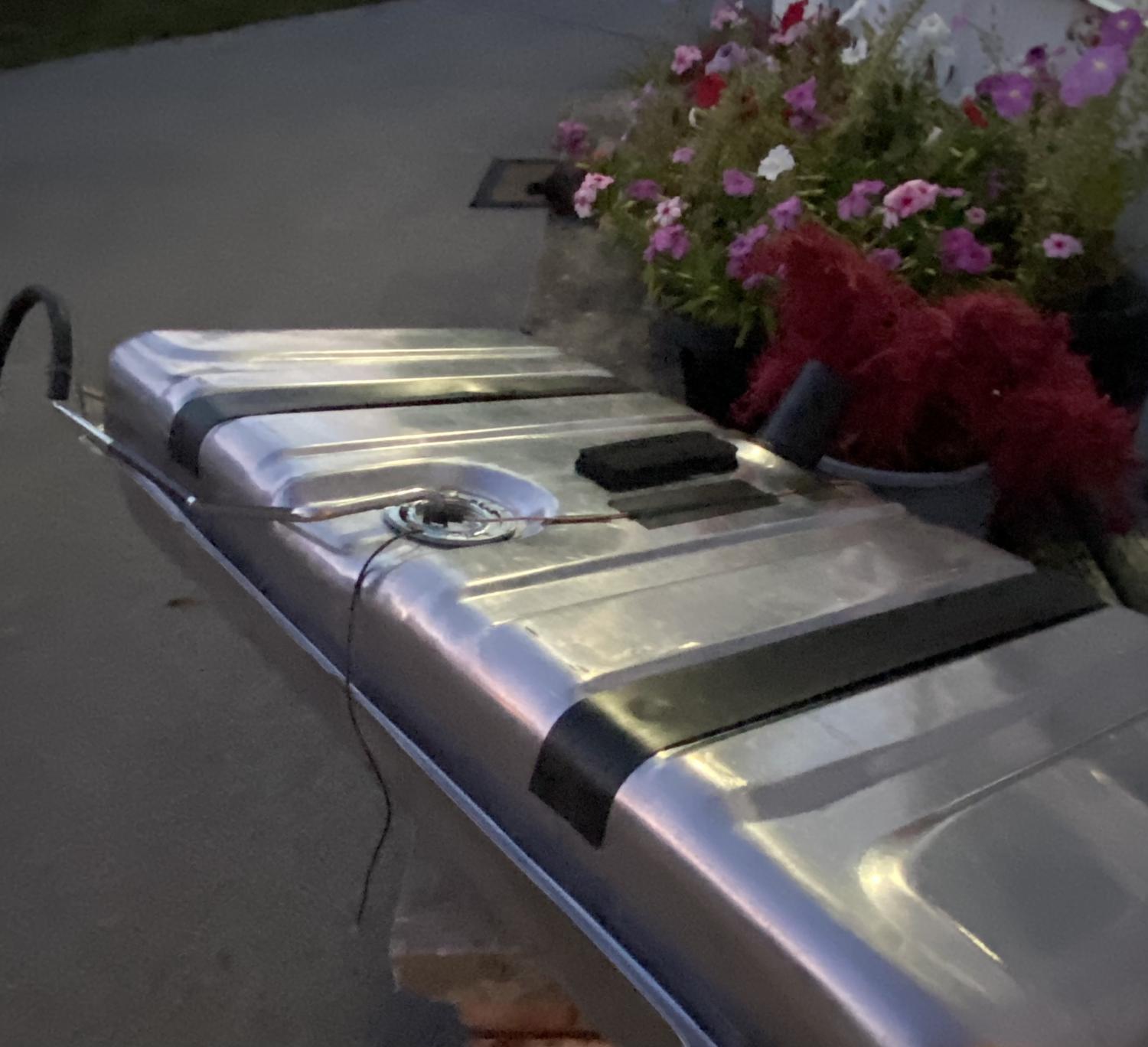

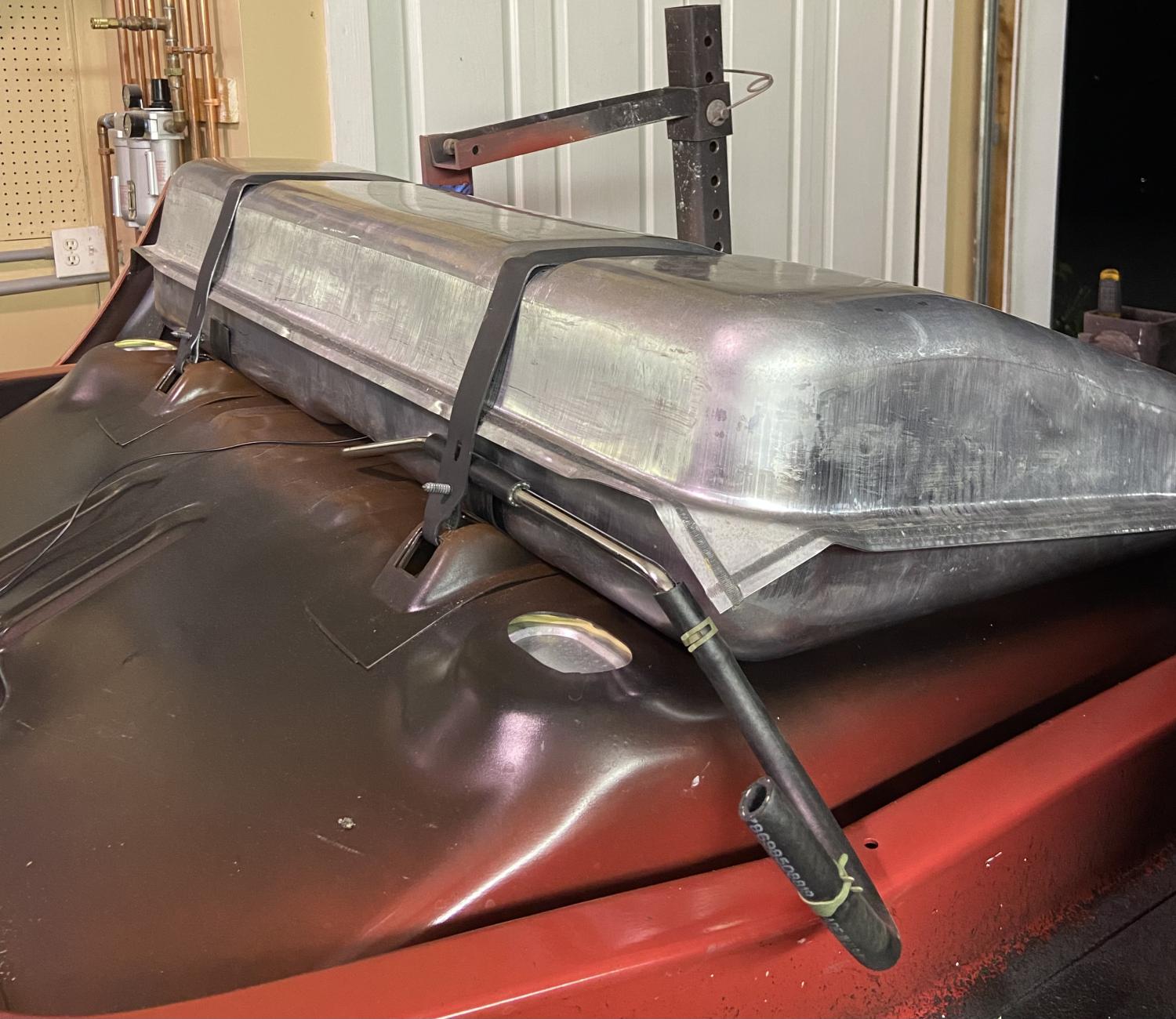

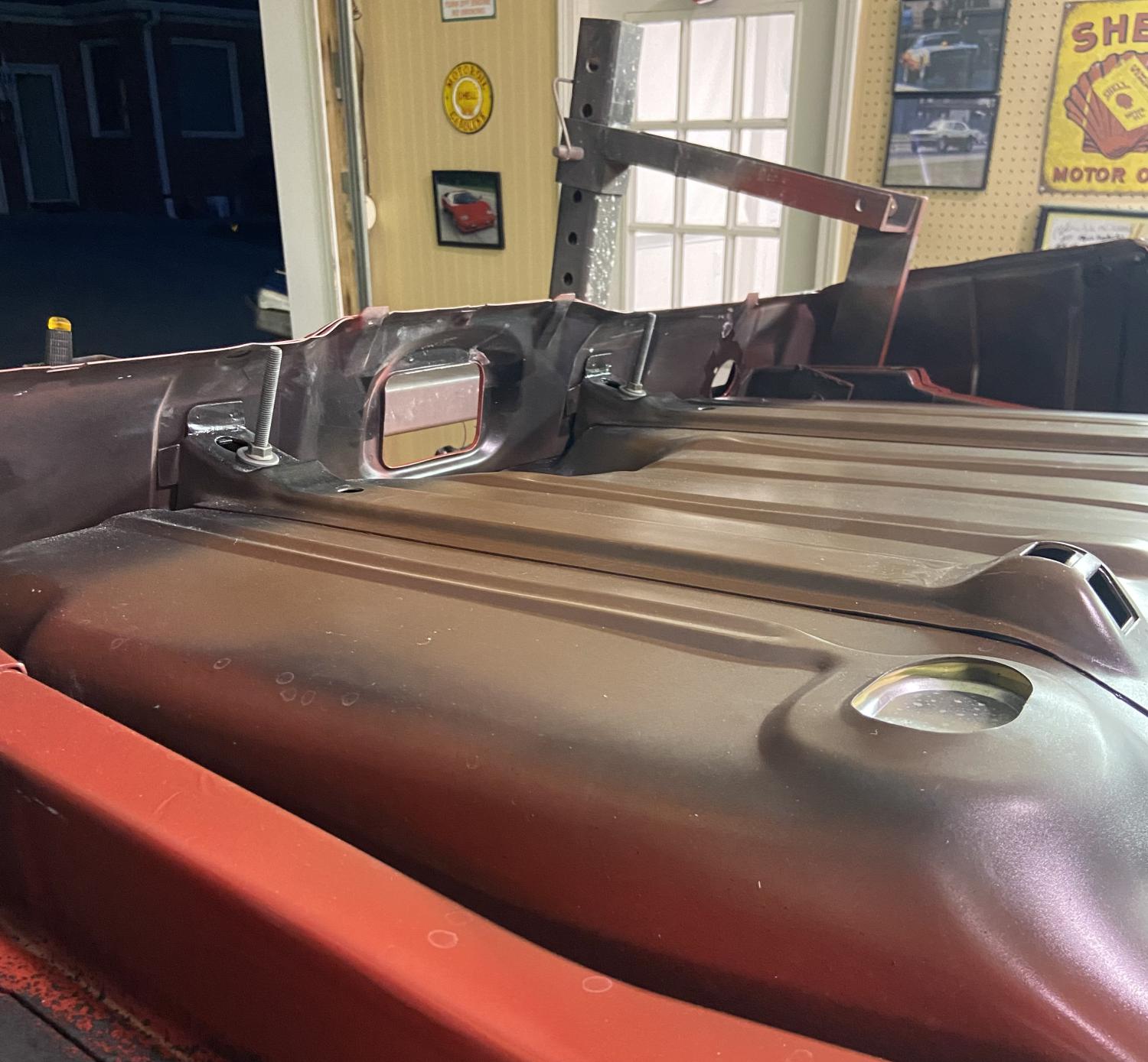

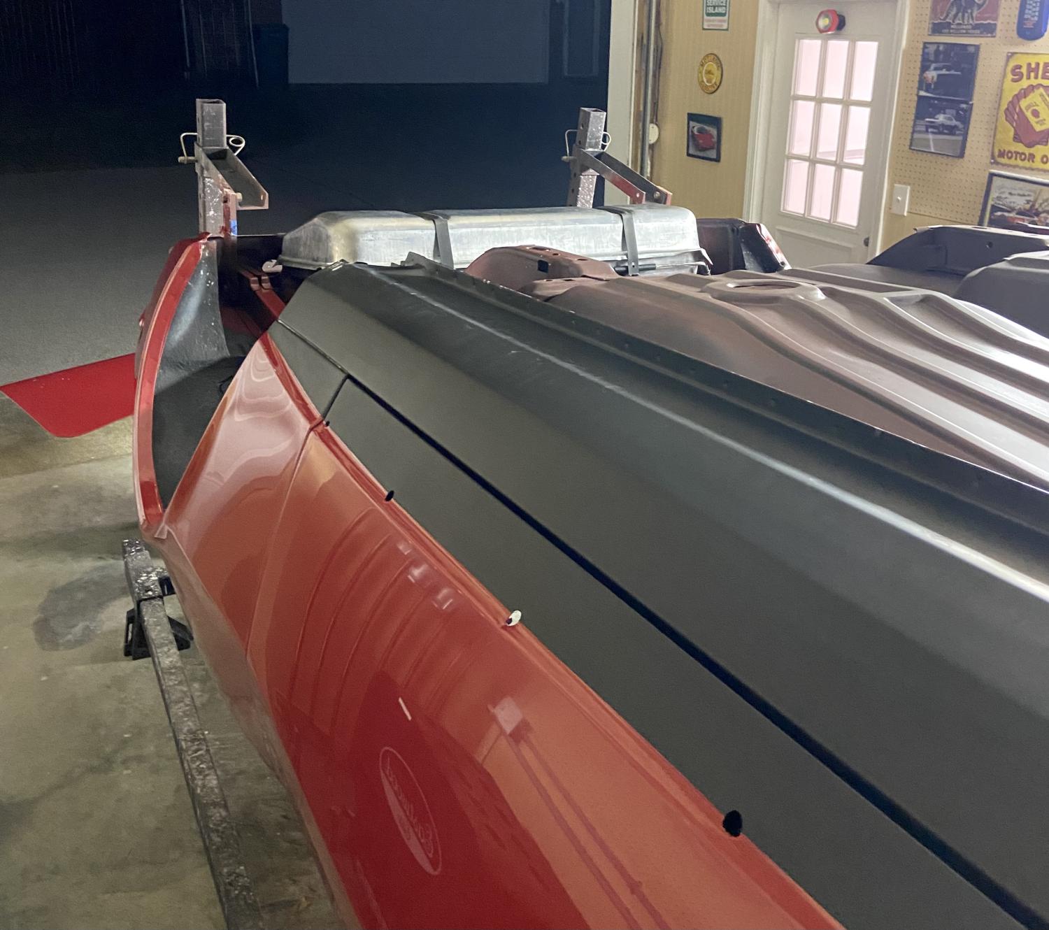

Had dreams of it being in the ground for the next update, however it seemed like a good idea to do the tank, bumper, rocker trim, exhaust hangers and such with it all upside down. That seems to be working out ok so far.

Yep, I did that and fuel and brake lines while mine was hanging upside down and sideways. Went a lot better than laying under it later. The fuel line is a little long and will get caught on the upright of the roto, so watch that and you can flex it enough to go around.
