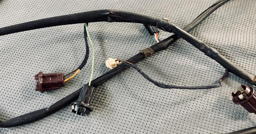

Been a little of a dry spell in the garage but I took advantage over the long weekend to finish up the rear body harness. Previously I THOUGHT I had a good replacement harness for the car but while I was busy repairing it I failed to pay attention to the fact it was a RS harness.. So my search continued for a replacement. With no original replacements out there (at least in my searches) I went to my other parts stash location and rounded up 2 other junk harnesses and managed to secure the sockets and terminals I needed to make the repairs to the original harness which had been butchered up many years ago. Now the mini project begins with repairing the old harness. You can see its pretty tired but the wiring is still good and has no bad insulation throughout the wiring and it ohm'd fine so I will use it.
Photos 700 - 703 - Of the harness before repairs.
Photos 704 - 705 - After cleaning, repairing and retaping.
Photos 706 - 707 - Continued harness repaired - Ignore the one terminal that's missing its backup light socket. Our own Bentley helped me out (which he always does. Thank you) and is sending me the one socket I need to fully complete the rear body harness.
Photos 708 - 710 - Harness installed into the clip under the dash and installed into the tail light housings.

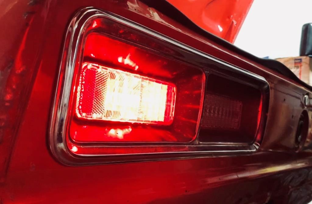

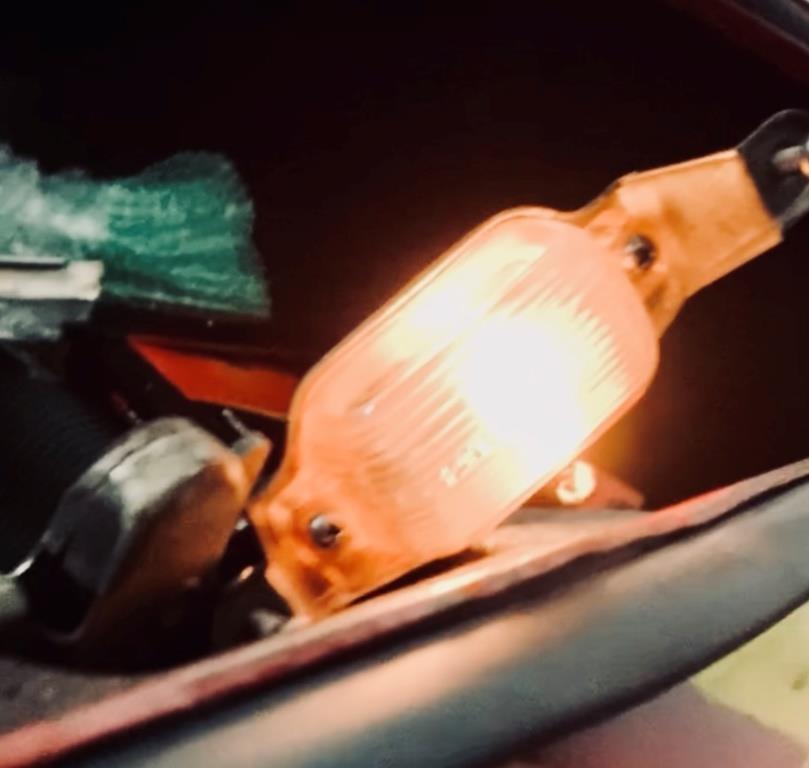

Finally once all was installed I wired up the car to a battery and tested all the connections including the headlight harness.
Photos 713 - 716 - Headlights, side marker & license plate light.
Photo 717 - Tail light
Photo 718 - Brake light
Photos 719 - Reverse light

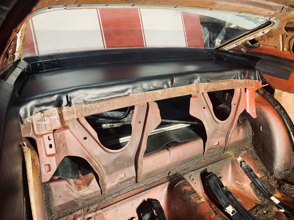

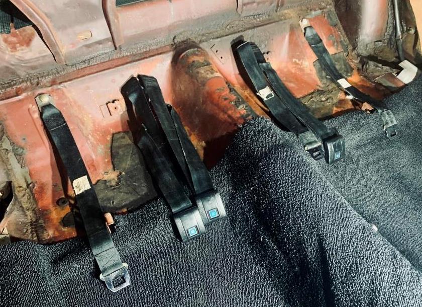

Got the package tray installed and glued into place as well as the rear belts. Ignore the bunched up carpet. It was from my big ass rooting around wrestling with belts.
Photo 720 - Package tray
Photos 721 - Rear belts

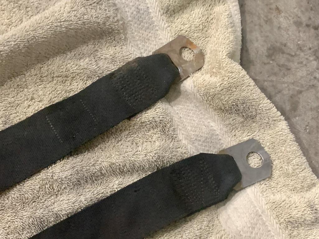

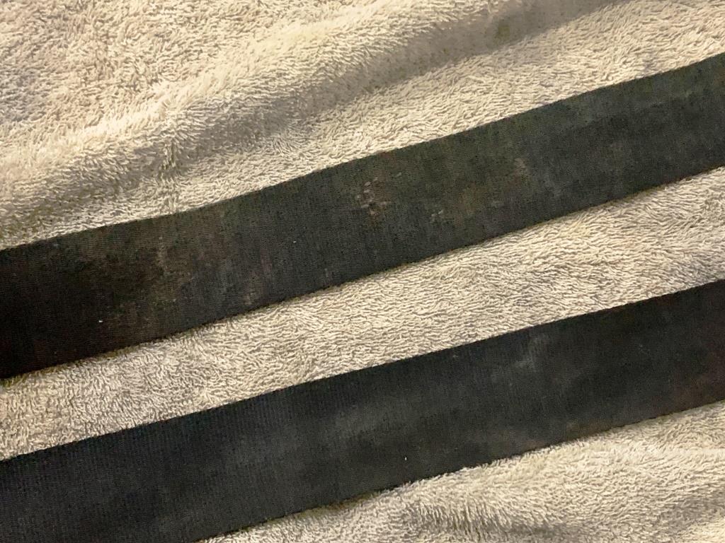

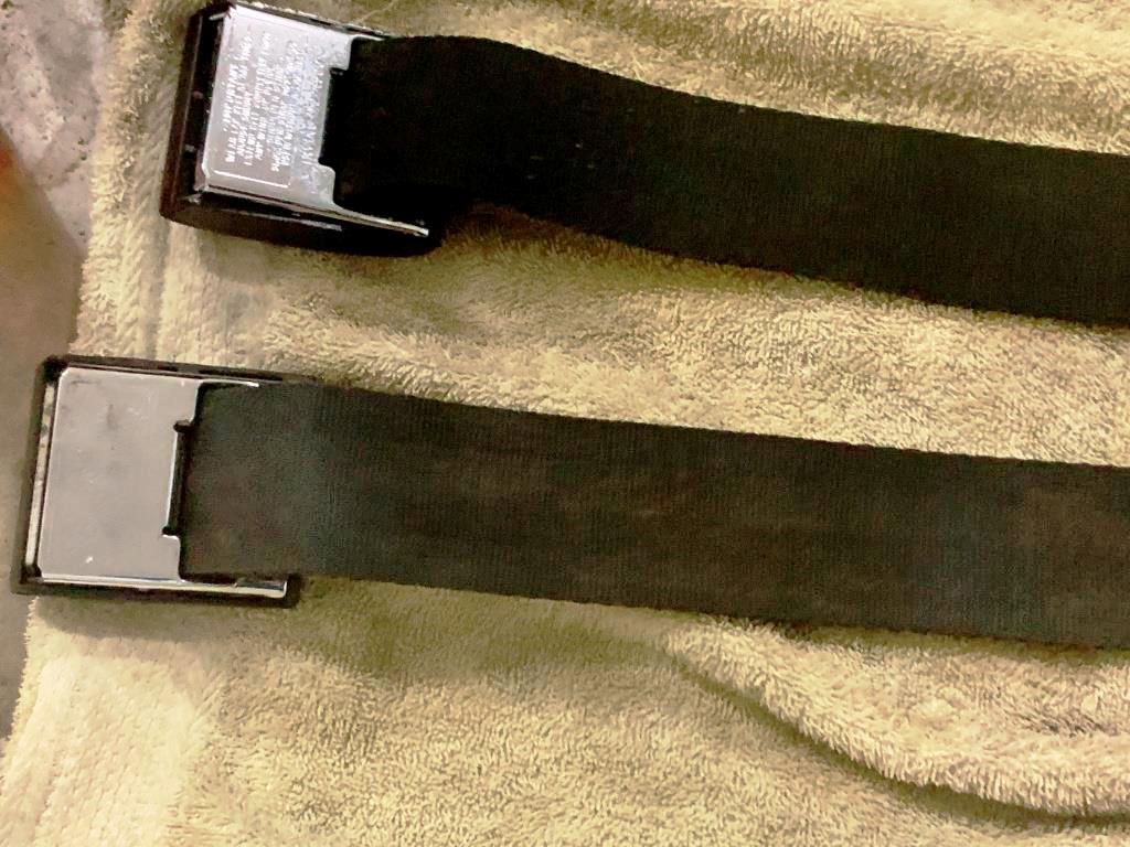

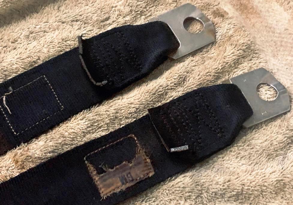

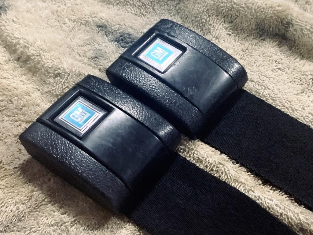

While on belts I had previously cleaned up the retractor side of the fronts but still needed to clean the clip sides.
Photos 722 - 724 - Lap belts before cleaning.
I went with my ole tried and true method of cleaning. Citrus degreaser and a blue scotchbrite pad. If you decide to do this make sure not to bare down on it while cleaning. Let the degreaser do the work and just massage it into the material. Rinse and towel dry and hang up to air dry.
Photos 725 - 728 - Belts after cleaning.

Bentley came through with the backup light socket. Got it cleaned up and installed. Now both backups work. Ignore the led light as I didn't have a standard on hand when testing.
Photos 739 -740 - Socket
Photos 741 - 742 - Installed and working
