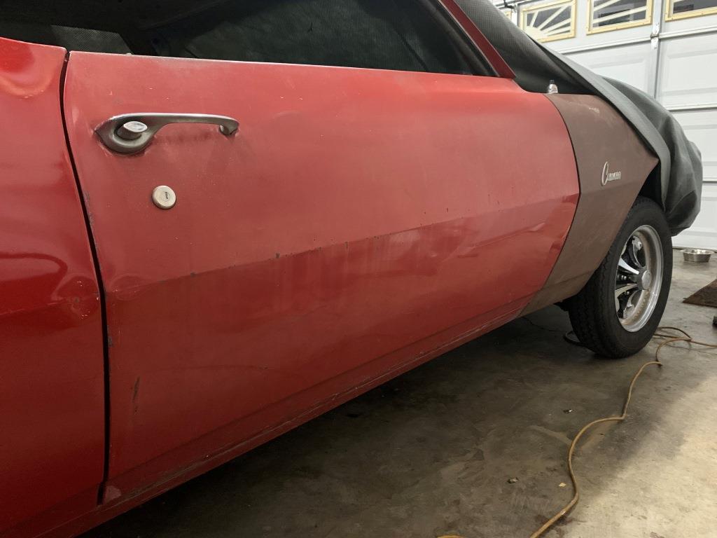

Photo 10 - After washing and clay barring the application of the #7
Photo 11 - Roof after after wet sanding and #105 & #205 (steps 5-9)
Photo 12 - Sail panel after wet sanding and before polishing
Photo 13 - Sail panel after polishing

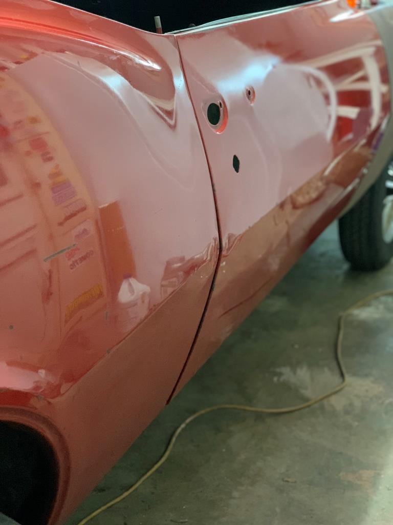

Photo 14 - Pass quarter before steps listed in previous post
Photo 15 - Pass quarter after
Photo 16 - Pass door before
Photo 17 - Pass door after
Photo 18 - Quarter and door after

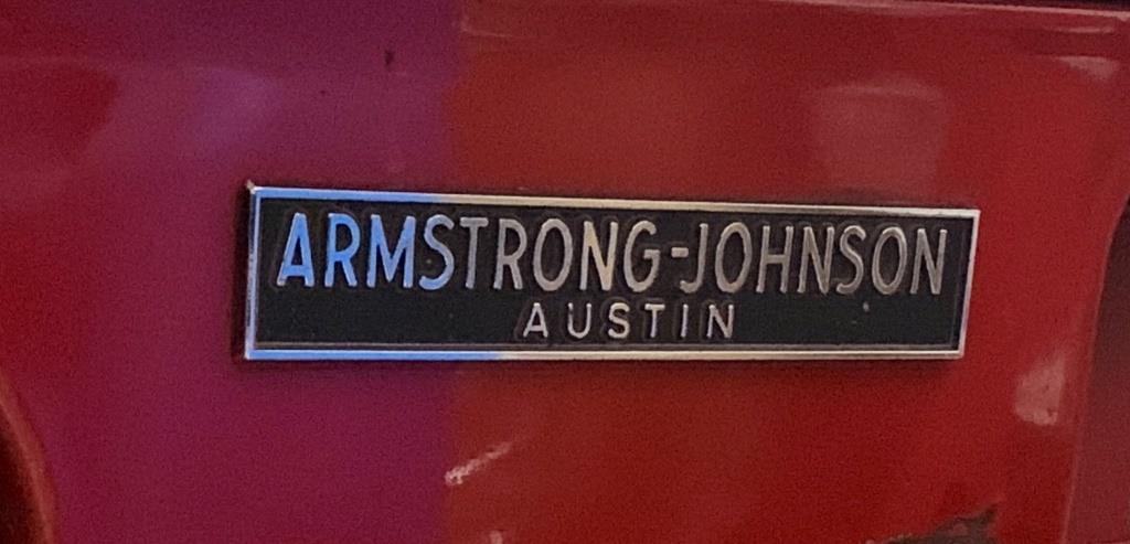

I was fortunate enough for a good friend to have a good eye and located me an original dealer emblem from Capitol Chevrolet. Thanks Bentley. As you can see although the emblem is a newer design without the attachment pins for the emblem which would have been later replaced by adhesive the location of the ejector pin locations match up perfectly with the original holes that were placed in the tail pan.

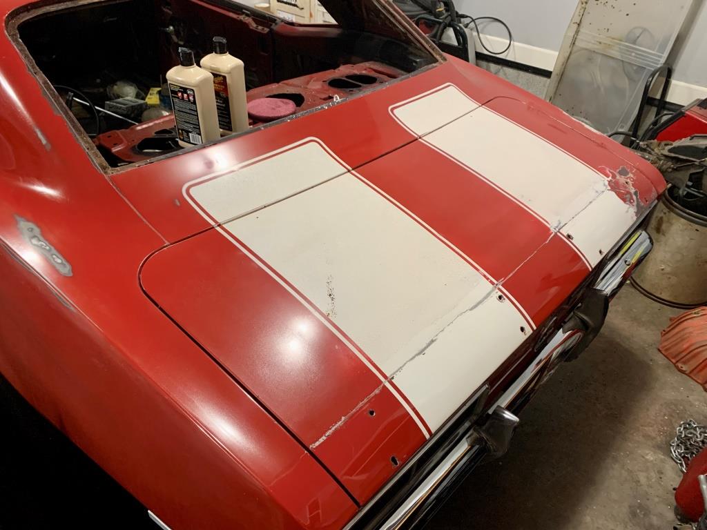

Photo 20 - Trunk Lid before.
Photo 21 - A little sanding brought out the original stripe under the repaint on the lip of the lid.
Photo 22 & 23 - Trunk lid after. You can see how the reshot did not hold up well over the years. But again will not refinish. You can also see that the pass side bumper guard does not sit flush on the bumper. This is due to what I believe was also part of the rear end bump it obtained. I will have to replace it with an original replacement due to the lower bracket that is welded to the guard broke its welds. I have several used guards so this will not be an issue. The primer sprayed on the drivers quarter and upper quarter and sail panel will be addressed. I will remove this primer and keep whatever is underneath up to the surface.

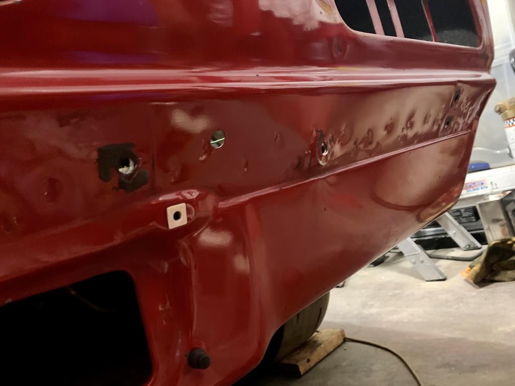

Photo 29 - you can see how the panel was popped outward around the guard mounting hole due to previously discussed tap. I will address this once I am ready to reinstall the components of the tail section. Also not that every bumper to body bolt and bracket had dum dum around the opening.

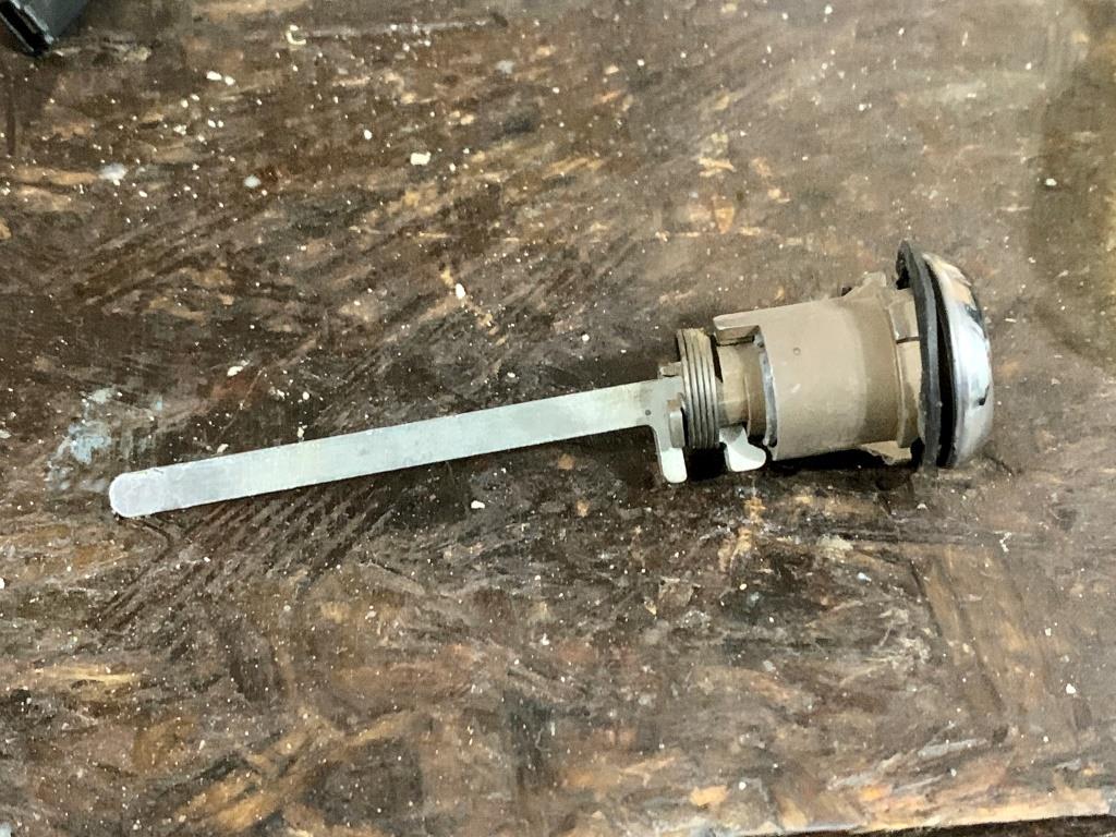

Photo 30 & 31 - While the trunk lock is out I went ahead and did a cleaning and polishing of it. Granted there is some residue in the key hole after polishing but will be removed and clean when reinstalled.

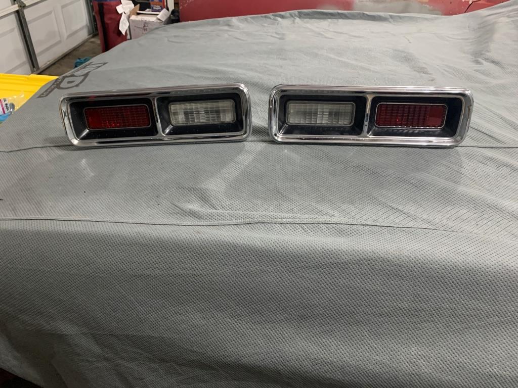

Photo 32 - 33 - Also while out I cleaned the tail light bezels and housings. Bezels were done with Zep Citrus Degreaser (can be purchased anywhere I'd assume but I get it at Home Depot) and a hand polish. Then the housings I did the same Zep cleaning and after wiping them down I used #0000 steel wool and a soap water solution and cleaned the galvanized. I think they turned out ok being originals.
