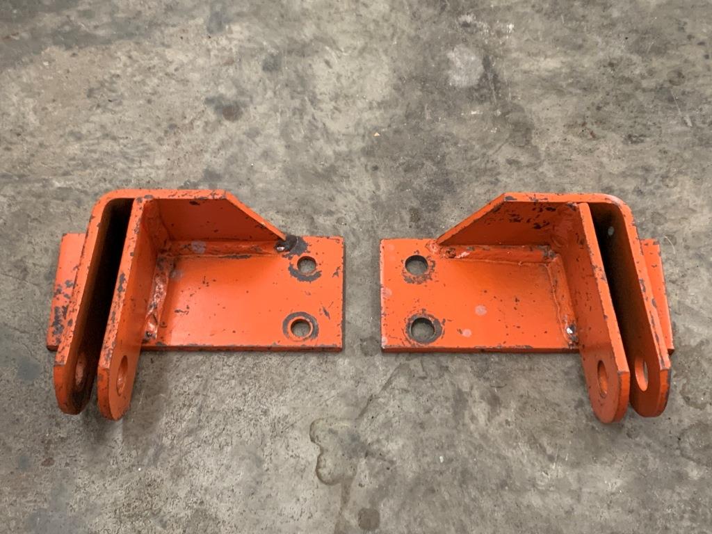

Last item is another Day 2 piece secured from a member here. This car originally had tow tabs (homemade) welded to the front ears of the sub and later were removed. So I felt I should at least at something similar back to the car.
Photos 540 - 541 - Tow tabs
