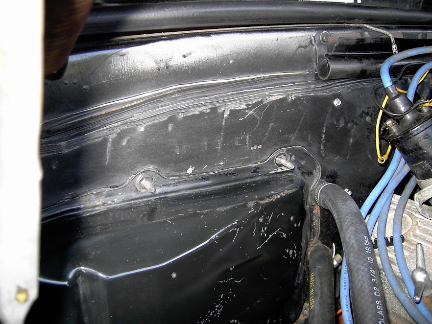

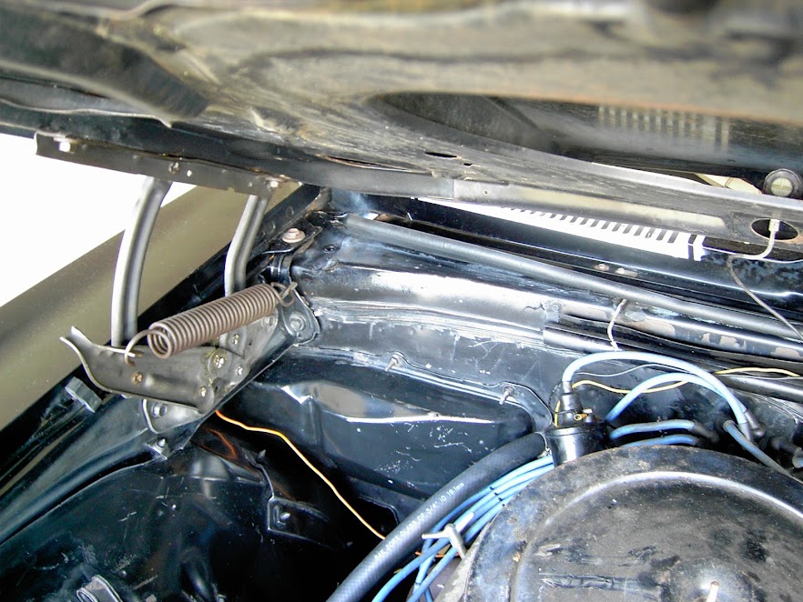

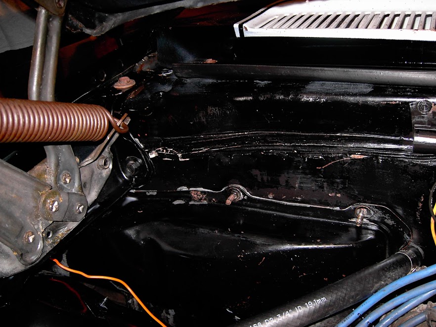

Anyone have a suggestion on what cleaner to use to remove black spray bomb paint from a firewall? Don’t want to disturb factory markings. Thanks
