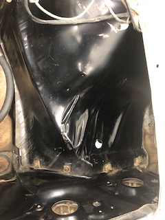

Anyone have a suggestion on what cleaner to use to remove black spray bomb paint from a firewall? Don’t want to disturb factory markings. Thanks

I used enamel reducer and paper towels to remove the rattle can paint...
Soak the paper towels in enamelreducer and spread over the area... allow it to penetrate then wipe off using paper towels and "chip" brushes.
IT is tedious nasty work.
