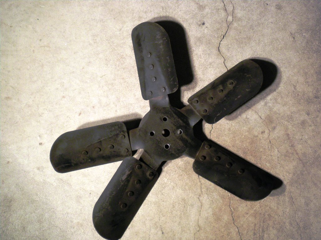

Contrary to all the repro catalogs and other mis-information; the L78 and L34 came with a staggered 5 blade fan...there was never a spacer. I understand the references to AIM info...but, I have never seen or heard of a factory 4 blade on any big block car. happy to be shown different..

Both engines used the same fan...these fans were notorious for the noise they made as the rpm's went up...most of them were replaced back in the day with a flex fan. Interesting thing is, they actually worked pretty well at cooling the BB motors.
Again, there is a lot of stuff out there about what fan is correct...based on all the info I have seen, including survivor cars, there was never a 4 blade on these engines.

I'm with Tom, in all my years I've never once seen a 4 blade fan on either the L34 or L78 Novas.

Its definitely a 5 Blade, non clutch(there was no room for one).

Not a 69, but some looks at an original 1970 if that helps.
