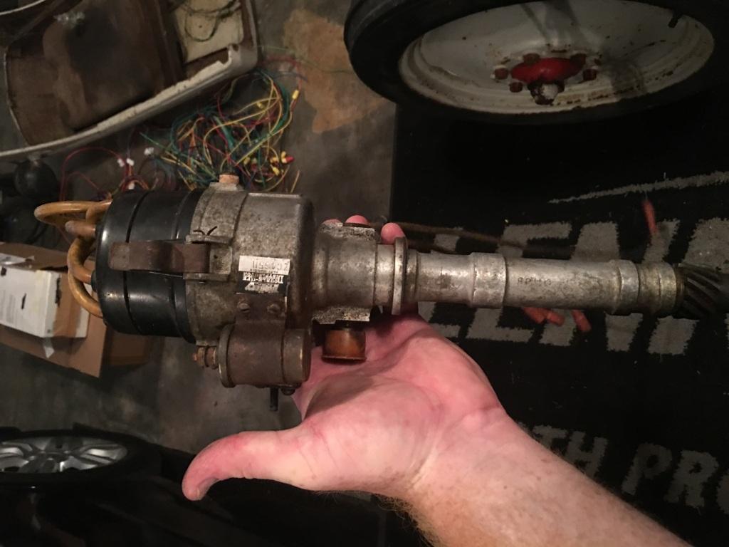

On my L89 heads and intake I used a Martin Senour Metal etch and a stainless steel toothbrush type brush and they turn out fantastic, I use this same product to clean alternator cases and distributors, just another way to make it happen if you don't have the tools for the other techniques listed here,
