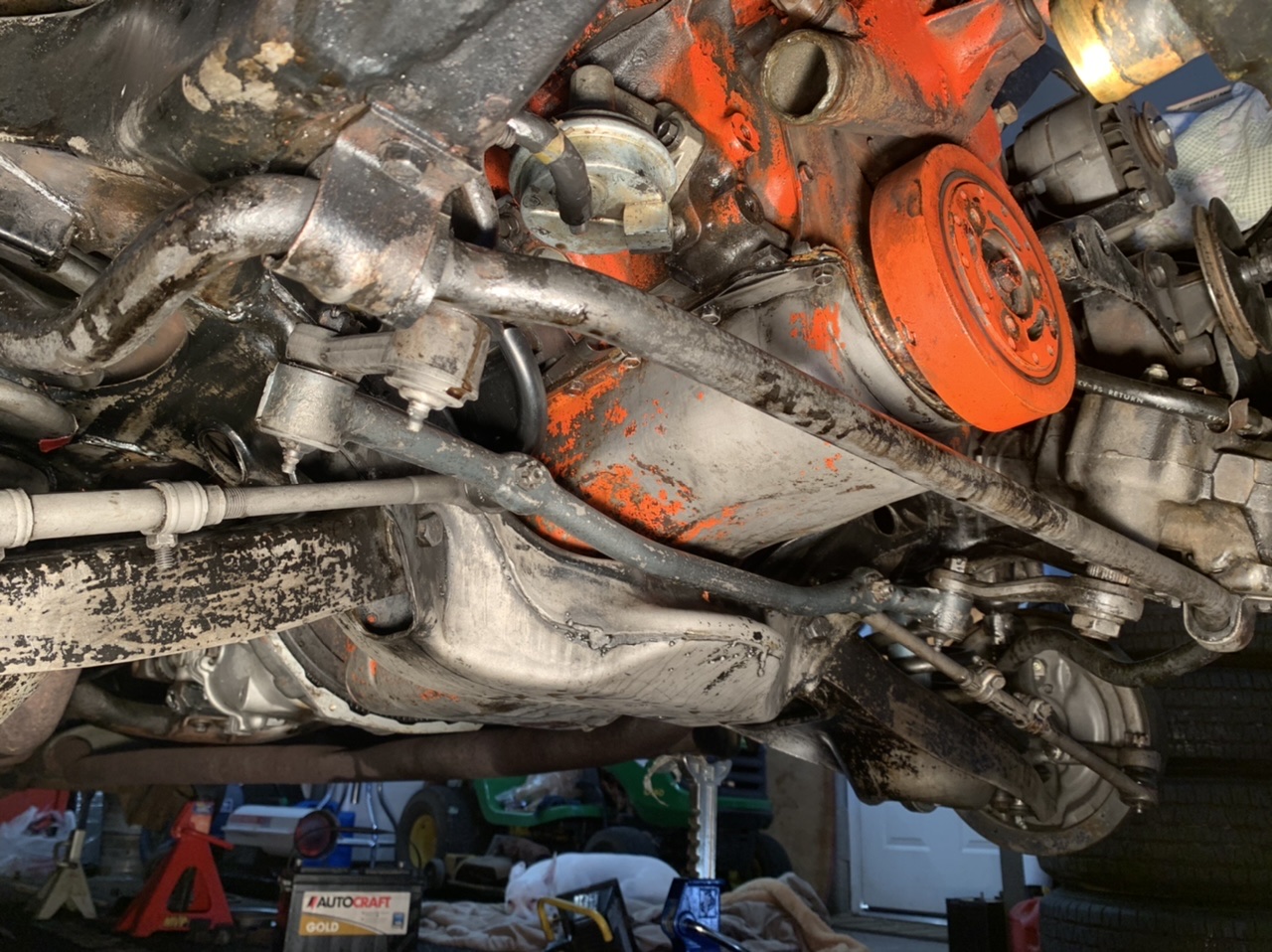

Anyone have a suggestion on what cleaner to use to remove black spray bomb paint from a firewall? Don’t want to disturb factory markings. Thanks

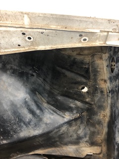

Here is before and after. Before had been scrubbed with full strength Simple green and Purple Power.
