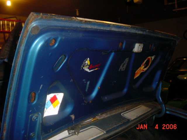

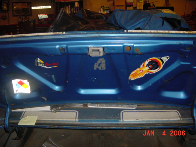

Old 12-11-2007, 09:52 PM
Seattle Sam Seattle Sam is offline
Join Date: Apr 2002
Location: Lynnwood, WA USA
Posts: 1,669
Default Re: 1969 Camaro Trunk Lid Question
Here is a '67 decklid. Only had holes in teh underframe to mount the emblem, none for the spoiler.
