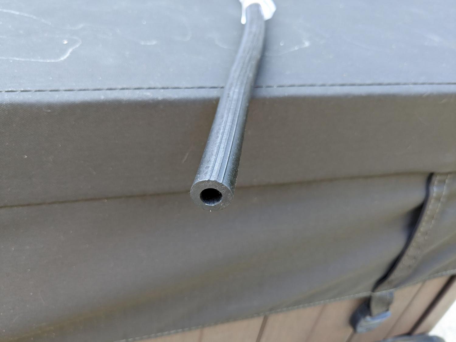

Hello all. I'm resurrecting this post to ask what length is proper for the ribbed PCV molded end hose. I've been communicating with someone there at Dr. Rebuilds just today and he is unaware people are buying his hoses for the Camaro, and he can't honestly say which length he has that is proper since he's a Corvette parts supplier. I'm guessing 23" but I don't know for sure. What are y'all buying? Thanks.

When I bought mine from Doc, he didn't ask me the lengths. I think he said they come one length & you had to cut to fit. The 302 was way longer than the 396 325hp.....Joe
The big block with a Q-jet would work with the 17"
The 302 will need to be the long one. It's 24" with the bend

I ordered the 23" hose so I could cut it to proper length. I haven't measured my original hose yet.
