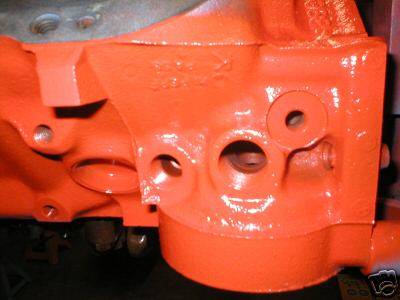

I finally got home long enough to get the 427 I got off Ebay. I think it may be a 2 bolt block that was converted to 4 bolt. How can I tell if it was a 2 bolt block? It is a 512 block with a cast date of Jan 15 1969. The block was decked at one time so there are no numbers on the pad. I can't find any numbers near the oil filter. Exactly where would they be?

The 4 bolt blocks should have the two big pipe plugs above the oil filter boss. These were used for an external oil cooler if required.

Keith is correct. Both pipe plugs above the oil filter will large and of the same size. On a two-bolt main, one of the pipe plugs is smaller than the other.

I thought 2-bolt blocks had 1 fitting for the oil sender
and 4-bolt blocks had one hole for the sender and a second larger hole for the oil cooler line fitting.

Thanks for the replys. Eric, I will call you shortly. The block has 2 holes by the filter. The one directly above the oil filter is larger that the one that is off to the side.

Sounds like a 4-bolt block

Aren't those bosses routinely drilled on conversions?
