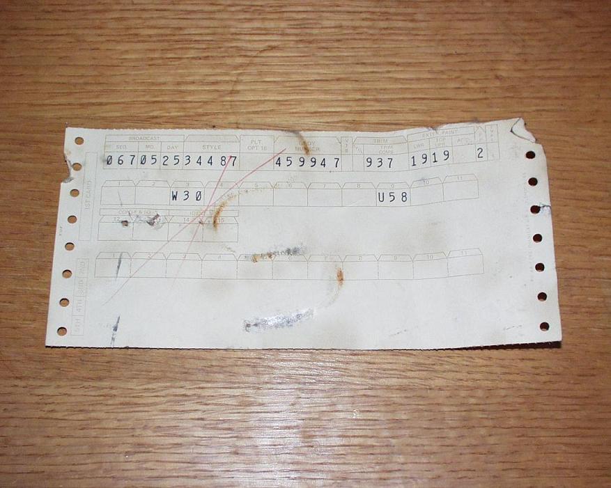

Do we have any experts on these - I really am fond of these cars and am looking at a 1970 442 W-30 project right now. What are these cars worth that are in need of total resto? and how do you verify it is real? Also what would be a correct motor 455? transmission T10? Muncie? How do I find out if they are numbers matching to the car?

I have a couple myself. What was mention above is correct. Red fender well...F-heads...ect. The big thing on these cars is documentation. The Lansing plant didnt seem to leave many buildsheets in the cars. Usually if you got lucky you found a broadcast card in the interior. See attached. This card noted W-30 and had the fisher body number on it. Just like all musclecars these days the correct parts are expensive so factor that into the price. If this car has no W-30 parts and no buildsheet then your price should reflect that. A complete documented 70 W-30 hardtop, 4 speed needing restoration will run you between 12k-20K depending on condition. No documentation, no W-30 parts deduct at least 50%. My opinion.
