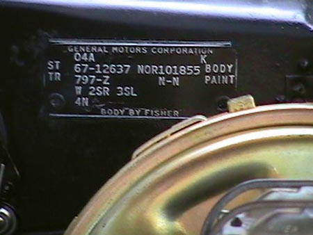

I was under the assumption that the L78 didn't show up in the 67 camaro till March-April 67, the trim tag/vin info on this car says the car was built 3rd week of November 1966 ???
Any comments?

would also like to confirm the date on the rear axel...cool car if its real.
http://www.camaros.org/geninfo.shtml#MidyearChanges
was the 4K car that sold as a roller real fast a long year ago on e bay a royal plum car??...kinda recall it was..I cant find the link I thought I had saved from that auction. wonder if its the same car done

This is a very questionable car. You are correct,L78's were introduced in Late March/April. The trim tag is very questionable.

at least the guy has a little taste and will put a spoiler on it ...the last word I read is somehwere in Dec was the first cars to recieve the traction arm, have not seen a car before then with a arm...thats why I really want to see some pics of the date and codes on the rear..hate bugging people when I am not buying but it could have some time line value if the car is somehow a pilot car of sorts and the rear is correct to that body.....things that make ya go hmmmmmmm...I am no bogus tag detective by a long stretch.....any experts see the text as being slighly off???

That car can't be an original L78.

I believe the car has a made up trim tag.On most 67 tags I've seen the GENERAL MOTORS CORP at the top and BODY BY FISHER at the bottom are stamped much lighter than the rest of the tag. I'm sure that they were already on the blank tags before the rest of the info. was added. That car tag looks to be all heavely stamped as in repro.

that is what I thought I was seeing..the whole thing looks like it was really stamped hard and it crowded the top and bottom text...
