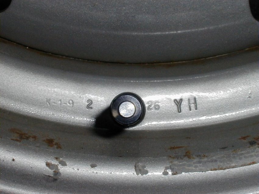

If you had the original wheels for your car you would see what I mean about the characters. A number of people who have had many YH wheels just have never seen any dated in March '69. Maybe they ran a few or none? Enclosed are some shots of YH wheel stampings. Do you see any differences?
Mark

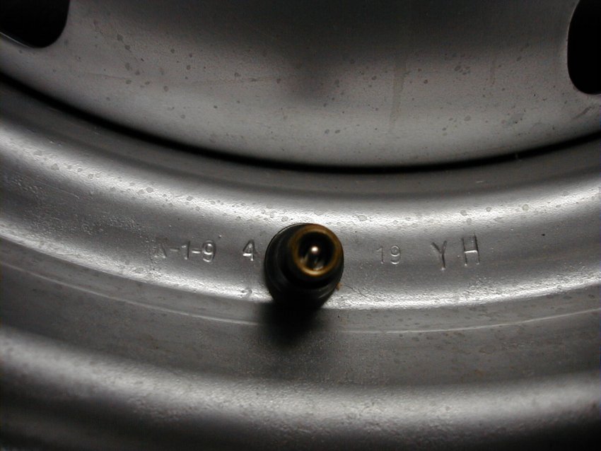

4 19 69 dated YH...

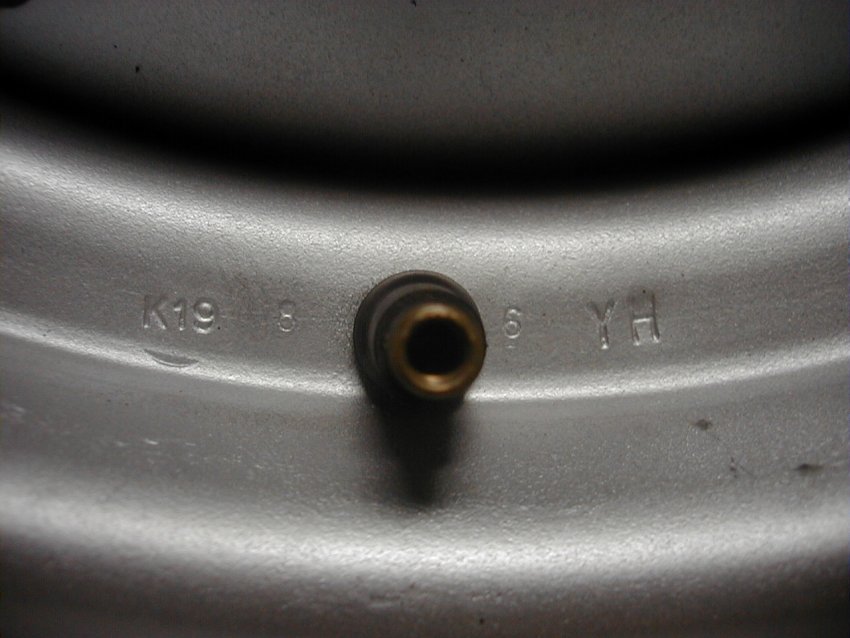

8 6 69 Dated YH.....

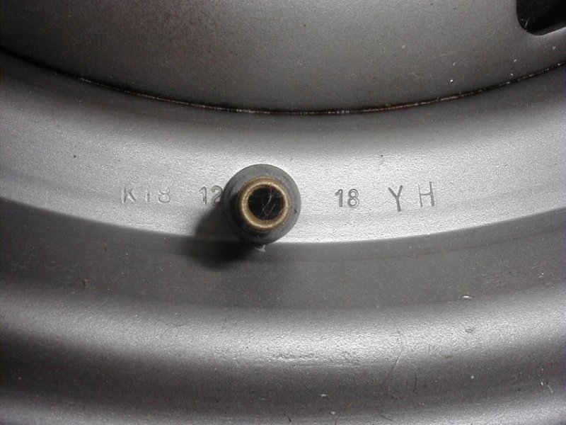

12 18 68 dated YH.....

I agree with Jeff... if you look at the K19 stamping on your wheels, and look at the date stamps, they appear to be in-line or at least parallel to the K-19 stamp, on all the wheels you posted pics of, on the ebay ones, it appears every stamp was done randomly and no 2 numerals seem directly in line with the next... There ARE definite variations to the stampings on your wheels too though, including the dashes between the K 19 on some and not on others, the depth of the stamps, etc... so I wouldn't necesarrily say the ebay ones are suspicious based solely on the stampings, but if you have any info saying there were no YHs made during this time frame, that may make me wonder... did you e mail the seller and ask any questions?

There certainly are variations in stampings on the production YH wheels but there are also a few consistant characteristics. The K-1-9 appears to be stamped in a gang holder, the edge can be seen on the 8 6 stamping. The dates and application (YH) seem to have been stamped as individual characters with varying depths. The only wheels without the dash between the K-1-9 I have seen are the august '69 dated wheels. Who knows why they used a different gang holder set? Later '69 dated wheels also exhibit the dashes between characters. Other than the fact that the E-Bay wheels don't exhibit the gang holder stamp characteristics, have different fonts on the Y and H characters than other original YH wheels, no dashes between K-1-9 characters, and have (rare?) March '69 dates; they seem quite like regular production YH wheels! A lot of money for some "unique" YH wheels!
