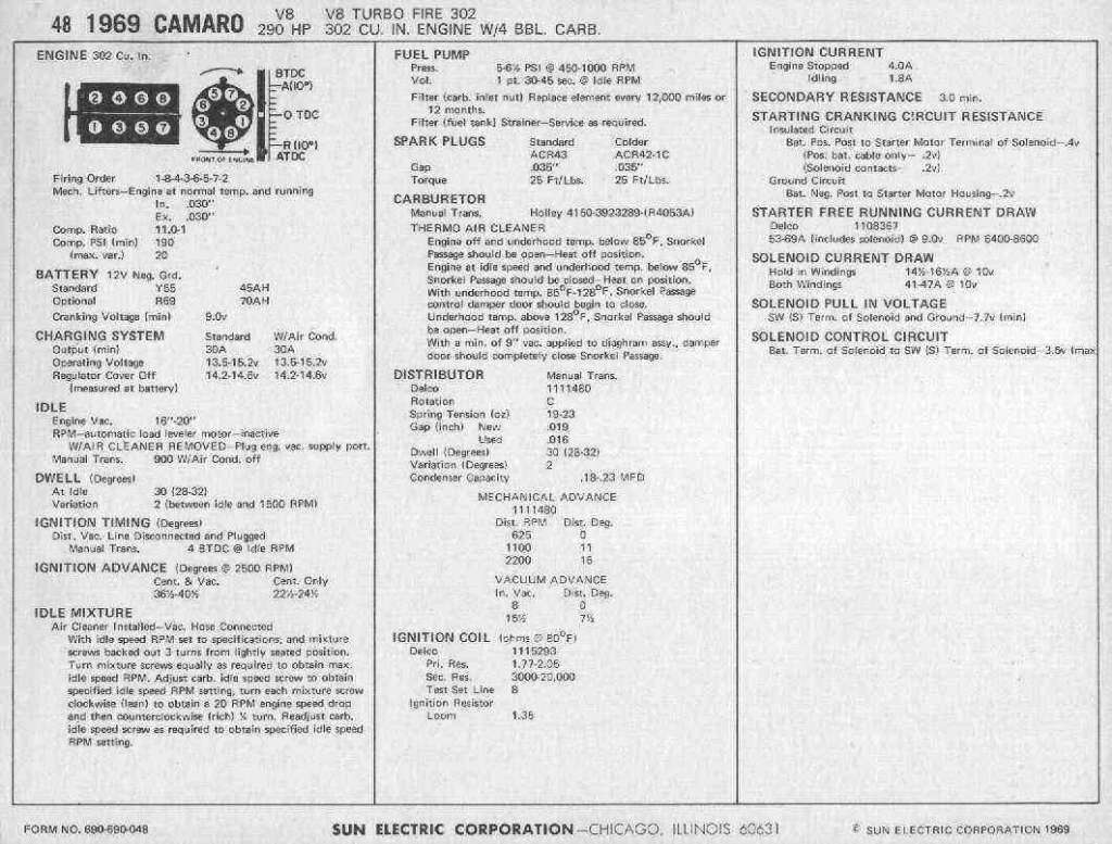

A friend has a 69 302 Z. The engine is stock. He is currently getting 10 pounds of vacuum at about a grand idle. Does anyone know what the correct vacuum should be at idle?

Here you go:

Good info Rob. I'll add it to my original shop manual collection even if it is Sun Electric info.
Best engine vacuum I can get on my 68 Z is 14" even after a stock rebuild. After exhaustive troubleshooting, no vacuum leaks turned up. I simply live with it. The power brakes and ralley sport headlight covers work just fine.

This is a little off topic but I notice the coil # listed on the sheet is the 293 coil which is the standard V8 coil for small & bigblock engines, except special high performance engines.
Z28 & high performance big blocks used high speed coils & I believe that '68 & '69 Z28's with flat hoods had 298 embossed coils in them. I can't recall what the '69 coil induction coil # was.
Can anyone confirm this for me? [img]/ubbthreads/images/graemlins/worship.gif[/img]
What do COPO 427's have?
Thanks [img]/ubbthreads/images/graemlins/beers.gif[/img]
