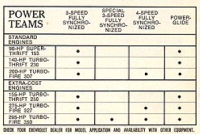

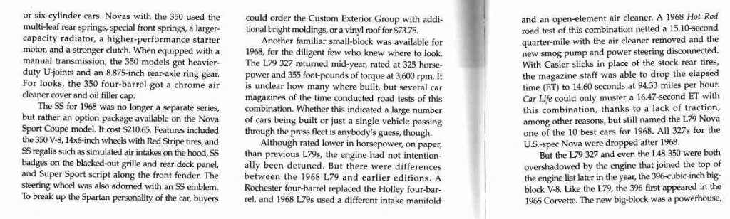

Default Re: Any documented 1968 Chevy II Nova SS "327" cars?
Here's an article from High-Performance Stockers magazine December 1967 issue mentioning the availability of the L79 in the '68 Nova's. Also very interesting is the fact that it says the L79 is only available with stick shift.
Tim "Hotrodchev"
