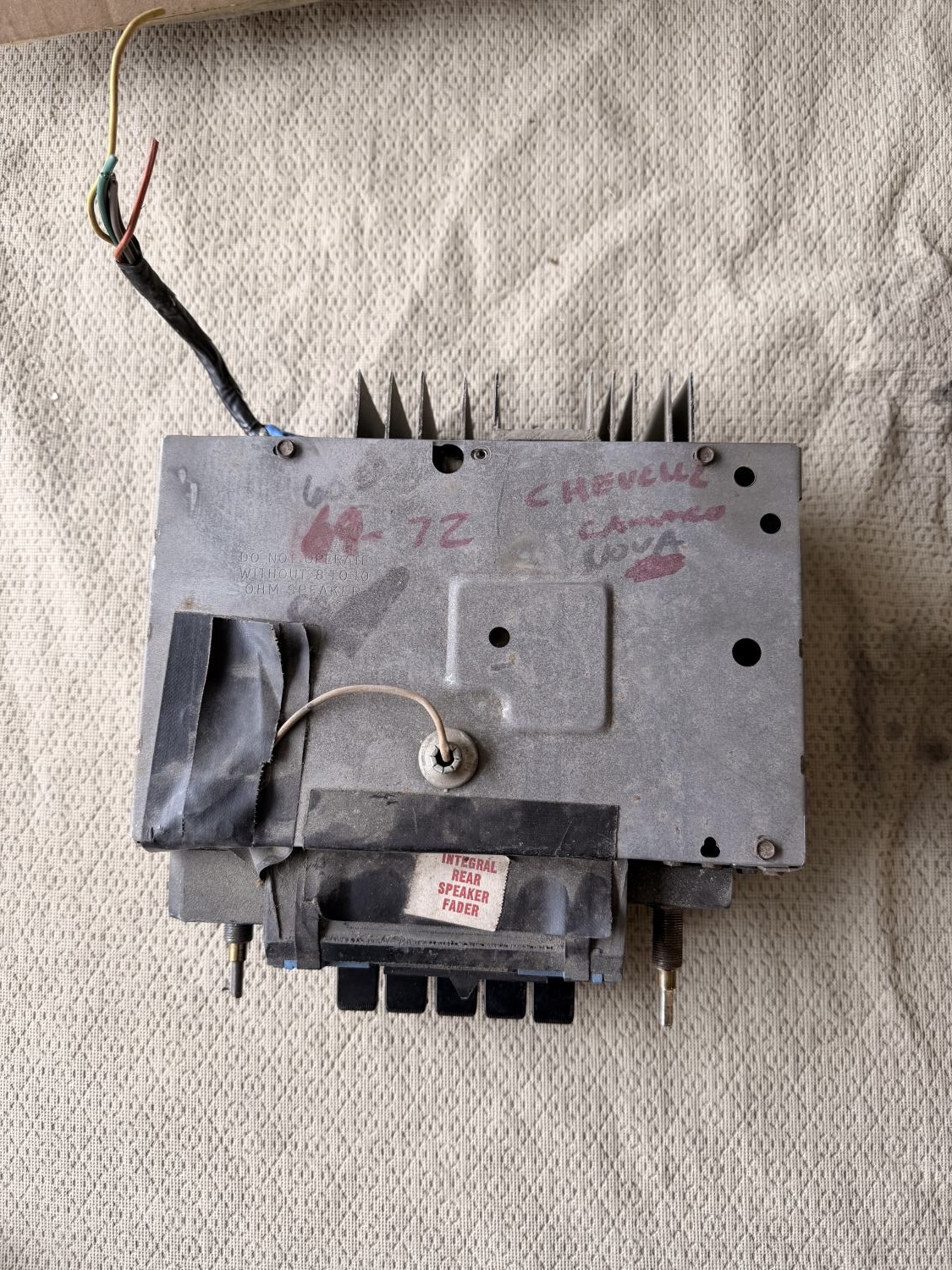

Hi Guys,
Been forever since I had an AM/FM in my hands. Confirming this is for a ‘69 Camaro?
Will be for sale soon
Thanks,

It’s original to a 76 Nova. A 69 Camaro used a very similar radio that had angled fins on the back, a different connector, and a number of other differences.

It's definitely not from a 1969 Camaro or any other 1969 model.

That sticker that says "Integral Rear Speaker Fader" also made me think it was not for anything 69, as I believe the 69s were still using the separate fader that slid over the tuning shaft. Not sure exactly when the integral faders came into use, but I'm thinking it was some time in the early 70s. I know that's what my 73 Camaro has.

76 nova or omega etc
