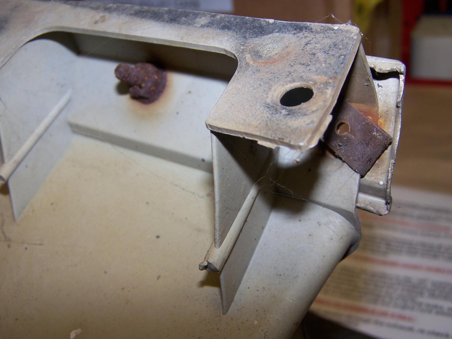

Anyone have a pic of the type of nut used on a 68 Camaro standard grille bottom molding. I see the part number in the AIMS 9419841, but when I research it I see two versions. One is a pal nut, one is a nut with integrated lock washer. I know the top molding uses the nut with integrated washer, just confirming the bottom molding nut. Thanks for any help.

here is a photo of my LOS Std lower hardware:
UPC 11-13 Sheet A6 Item #6 (9419841)
For Lower STD grill trim to Plastic center Nut used on trim 10-24 stud.
Phosphate stamped Nut, for a machine Thread..
AMK # B-13383 (#10 HX FLG PALNUT PHOS) 10 PCs.
GM Grill Factory & NOS both photos.
(Note Rev #1 Symbol it WAS a rivet and Engr Change Dated Nov 1967, I wonder if they had problems installing grill>?)
