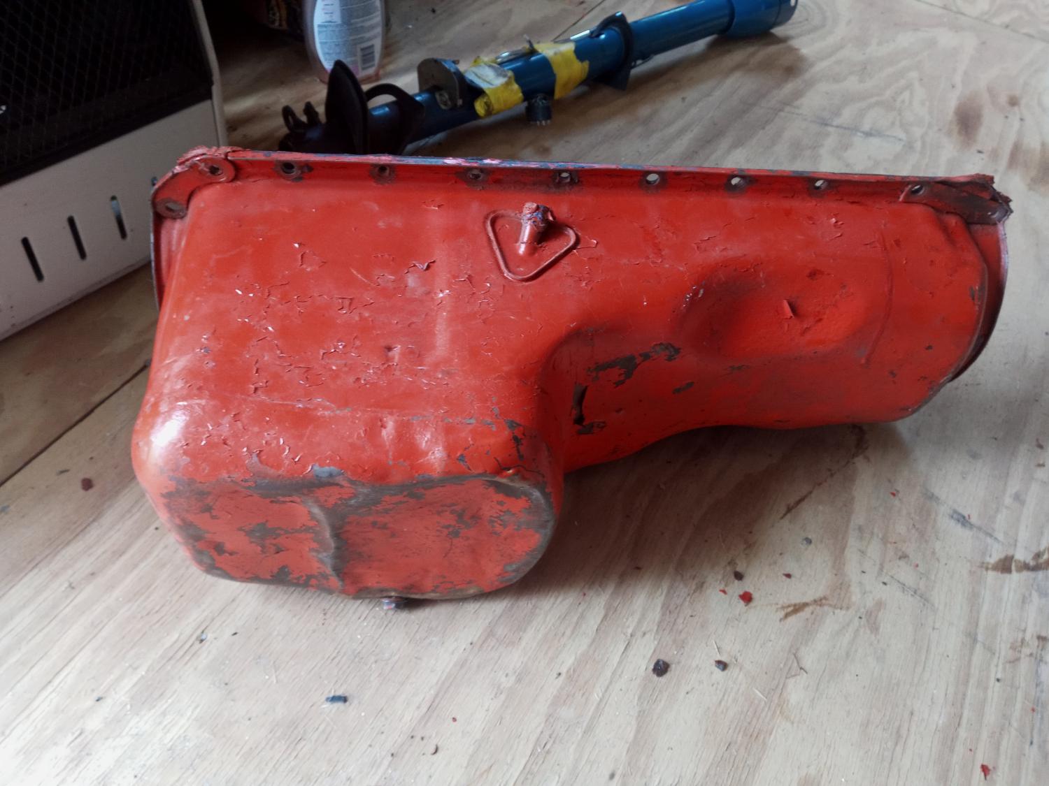

Any chance this is a over the counter gm pan simular to the l88 pan ?
Attachments - The Supercar Registry Screenshot_20250829_151016_Photoroom.jpg IMG_2681.jpeg IMG_2159.jpeg 20250520_150246.jpg

Yes
No, it is not! The factory deep sump oil pans have only one weld line going around the sump. It is close but not exact. Impala pan modified by owner by adding a strip of metal between the sump and the upper part of the pan.

jl8z28... What is that supposed to fit? 67-69 BB Impala?

Im trying to find out what it's for

That looks similar to the pan that I made for my car many years ago when I couldn't afford a deep pan.
I believe this oil pan was fabricated by someone.
