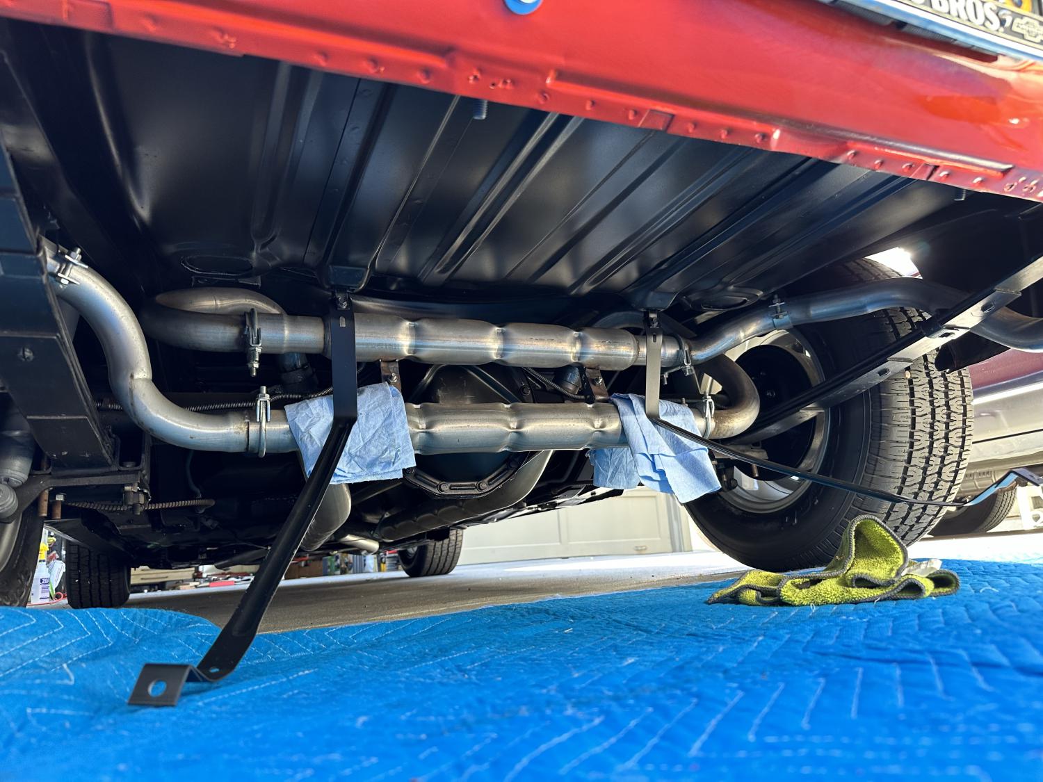

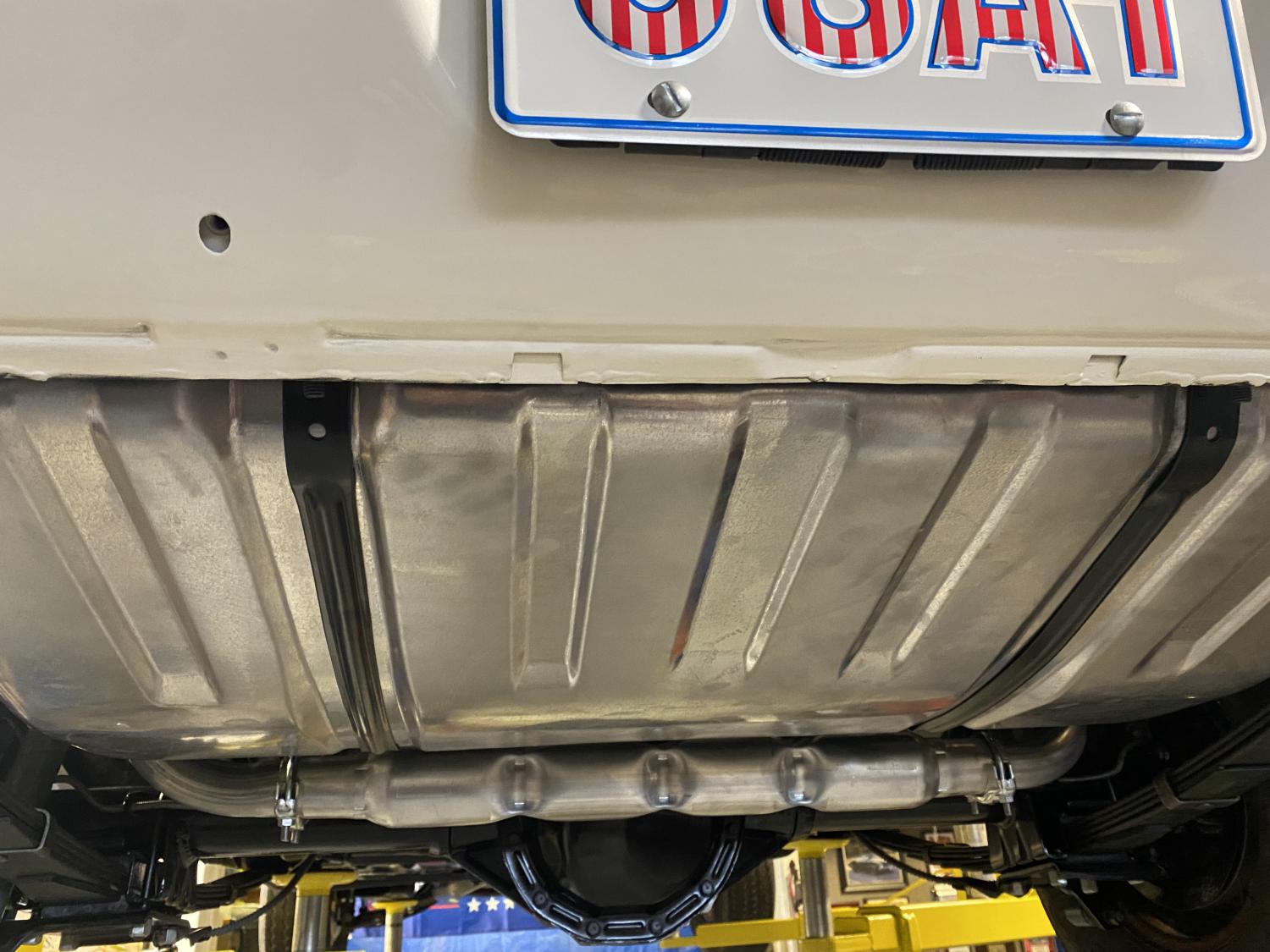

Default 1969 Camaro Chambered Exhaust Experts
I have a 69 Z/28 with a 302 (factory solid cam,11:1 compression and headers) a M22, 4:10 or 4:88 (TBD) gears, 15" Polyglas tires and no factory floor insulation. I would like to hear from some experienced members what it will be like running a chambered exhaust system on the car. The pipes are a factory 2 1/4" system and unfortunately I do not know the exhaust system brand.
1. On a scale of 1 to 10 (1 being quiet and 10 being insane), how loud will the interior be with the chambered system without any floor insulation, just a factory carpet? Will I need a bucket of aspirins after driving 20 minutes at 50 mph?
2. I suspect installing the factory heavy sound deadener will reduce the interior noise a bit. If so, to what percentage if you were to guess?
3. Would installing after market sound insulation on the complete interior floor area reduce the interior sound substantially? And if so, to what percentage?
4. If installing after market insulation helps a lot, who makes the best insulation kit for this purpose? Keep in mind I only would put the insulation on the interior floor compartment and not on the interior of the doors, quarter panels or trunk area.
5. Would I be safe to say that trying to listened to my favorite VH album with any form of insulation in the Camaro will be a pipe dream..... haha.
Paul

Chambered is a noisy system, not a performance system. Probably cost 30-40 hp.
IMHO, the 67-68 Deep-Tone system had a much better sound.

I have a ‘69 Z, factory setup 302, M20, 4.56, deluxe interior, 15” radials, and chambered exhaust. I’d probably say it’s a 5 out of 10 at 55-65 mph (though with these gears I don’t do a lot of long freeway cruising). It’s only at WOT / high RPM that it gets wake-the-neighbors / alert-the-authorities loud (9/10?). Not sure to your other questions.
I continue to be surprised how civil it is if you are civil with the loud pedal. It’s downright delightful at idle (even at 950 for the 302), and totally livable at cruise RPMs with windows down. At least to my younger ears I can’t imagine running a quieter system. I can barely hear the other Zs at cars & coffees, when standing next to them! So +1 for chambered here. I think Eddie would be heard with the right sound system (maybe even through the single under-dash speaker)

I installed a complete Gardner system on a customer's Z28 several years ago and hated it. It was obnoxiously loud. I would rather have open headers as that is what you expect to hear with headers, not with an exhaust system. It was very loud out back as well as in the cab. I have since talked a few people out of chambered exhaust since that time including the Chevelle owners.

I would not install chambered on a 69 Z28 as been stated you lose HP and it sounds like crap. One of my Z's has it listed on the WS so what's on the car is a Gardner system.
I sold a 69 Z years ago and the new owner insisted that I install a standard cross flow system prior to purchasing.
Big block don't sound as obnoxious as small blocks!!
