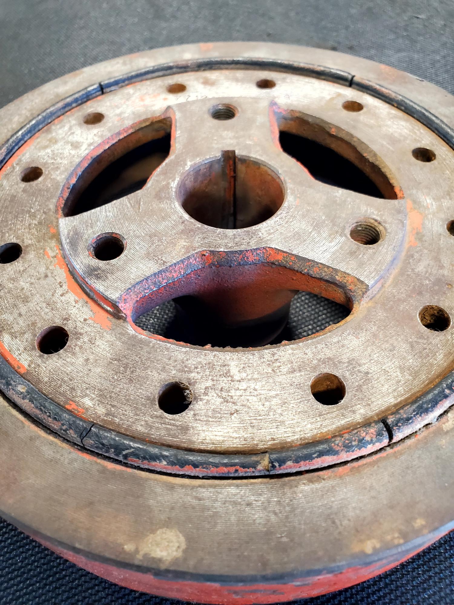

Default 7712 8" Harmonic Balancer Casting # 2942536 Dated F G 8
Dated July 68
1.75" thick
Raised center pulley mounting surface

It's not the same as the factory balancer on the Z28 the arms extend all the way down

would this be correct replacement for a 68 Z28

Where is the timing mark compared to the keyway?
I believe this to be a 1978 350 balancer but can’t see any reference
in the photo’s.
1968 and 69 balancers differ in the placement of the timing mark.
68’s are centered ( roughly) on the leg and 69 is just left of the leg that
Has the keyway.
Also jl8z28 is correct in that the “Windmill” should extend out to the rubber.
