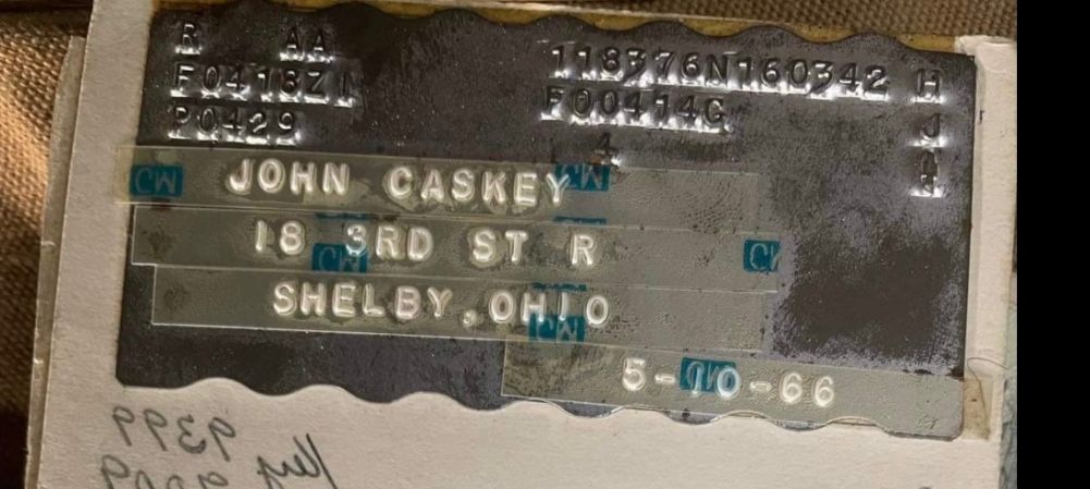

does anyone know of a good source to decode my 1966 Nova protecto-plate?

Thanks Joe. Attached is a picture

F0418ZI engine number
PO429 Trans
F00414G Axle
5-10-66 delivery date sold

Thanks Ralph but the ones that stump me are the J under the H for Holley on right side and the letter R next to the AA on the left and the #4 just above the tape with owners name.

Here's the breakdown of your POP. It takes a while to go through all the pages in the parts manual. From left to right, top to bottom;
R= bright blue interior
AA= black exterior, top & bottom
118376N
11= Chevy II
8= V8
37= 2 dr HT
6= 1966
N= Norwood
118 combo is Chevy II SS
H= Holley
F014ZI engine
F= Flint
04= April
18= 18th day
ZI= 327 spec HP
FO0414G axle
FO= 3.73 posi with metalic brakes
04= April
14= 14th day
G= Chevrolet Gear & Axle
J= May 1966 built
P0429 transmission
P= Muncie 4 speed
04= April
29= 29th day
4= U63 AM radio & U80 rear speaker
I think I got it all. Very nice car.....Joe
