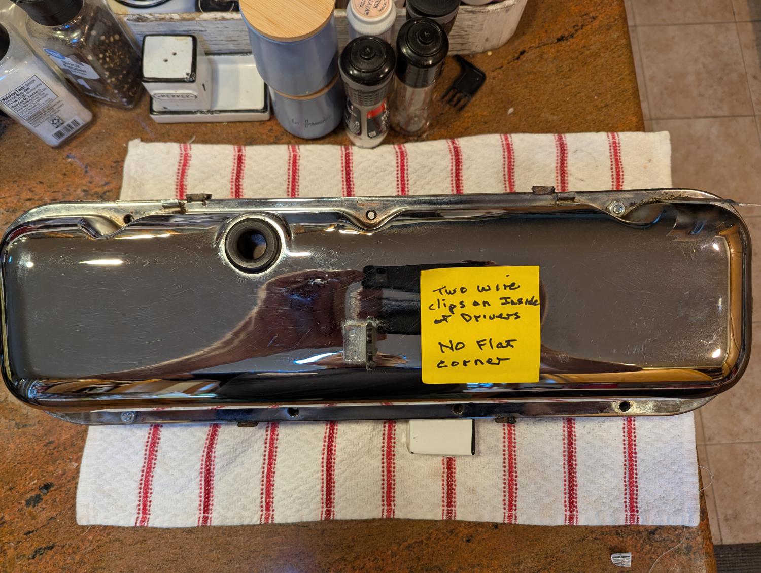

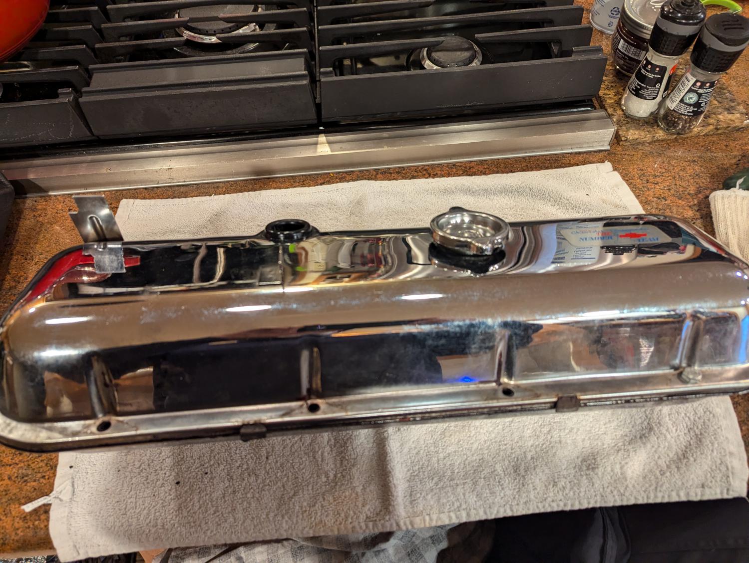

			NO Flat Rear Corner
			Drivers Side has two wire holding clips on Inside Edge Passenger Side has NO Wire Clips GOOD Driver Quality

			Drivers side is not 69 Chevelle.
			Clips are wrong and no spring tab on rear plug wire stand. Last edited by daveg; 06-03-2025 at 12:09 PM.  |
			I'm thinking full size. The arrangement of the wire holders and wire clips looks like my '66, except mine aren't chrome. Chrome would've been '67 up. No need for the brake booster flat corner on big cars.
	Mark 1966 L72, 4spd Caprice 1974 Z28, M40 Camaro  |
			Guessing the passenger side looks like it could have a few different applications, full size, Chevelle, etc. 1968 and up.
	The driver side I would say 1967 full-size Chevy, both low horsepower.  |
