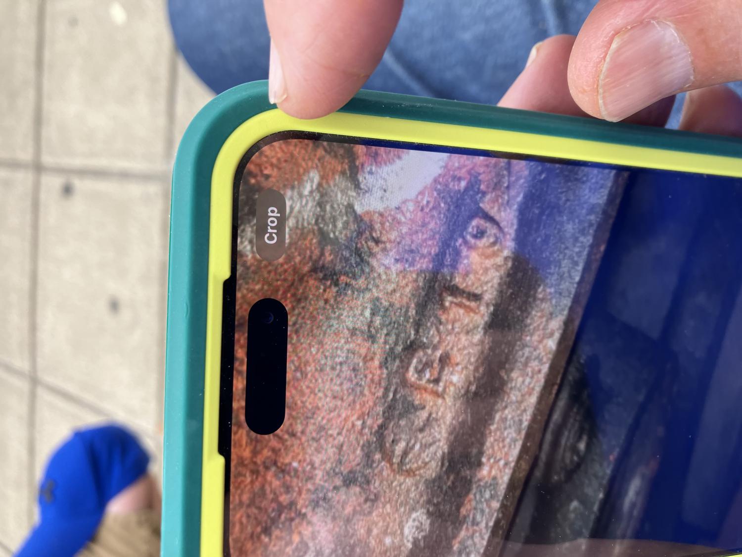

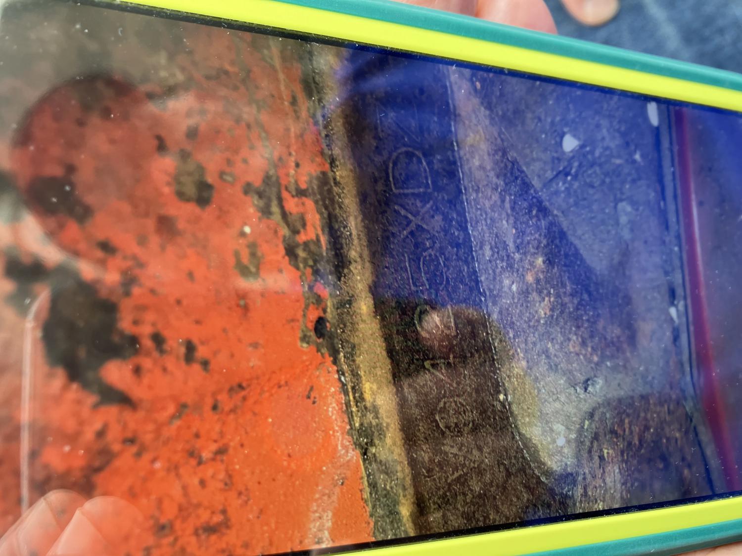

Is this pad stamp real?

Never seen one like that.
Casting number on block?
Casting date on block?

What's up with the 'X'?

Two pics, cast date and cast number

It doesn't compare with other April '69 DZ pad stamps. Last 618 casting I am aware of is D119.
Unusual for a block cast May 1st to be assembled April 25th...

Doesn't make sense.
E 1 9 is May 1 of 69 if it is a 618 block. But....
Casting sure looks like 3958818, but I don't think that is a good number.
Closest thing would be 3956618, which was phased out in April 69 in favor of the 3970010 blocks. I suppose there could have been some overlap but.....
The assembly date of 0425 would be April 25. Could not have been assembled BEFORE being cast (May 1)

The X has Bill n I puzzled also, I’m like Lynn block cast looks like 818 but that’s not a good number according to Colvin. It’s probably 618.
I agree with you guy about block cast date not corresponding with assembly date on pad. Colvin explains the possible over lap you guys mentioned.

I'm thinkin' it's probably not worth driving to TN to look at, unless it's priced absurdly low (unlikely). Block casting p/n is iffy based solely on those cell phone pics, but the block cast date is pretty clear and makes no sense compared with the stamped assembly date, as others have said here.

Bill n I discussed it last night and decided too many things aren’t lining up for it to be a real DZ motor.
