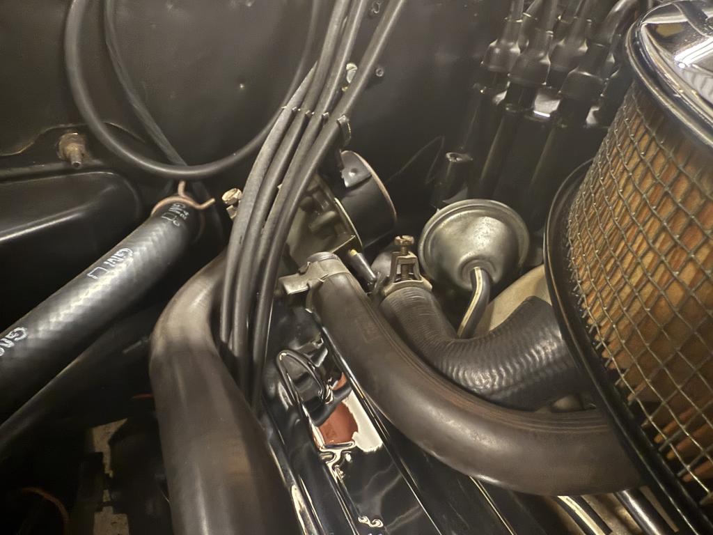

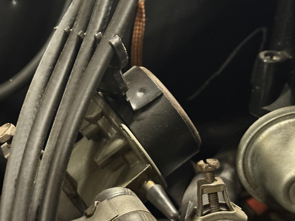

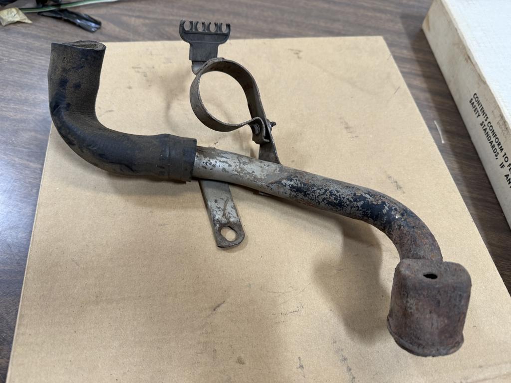

Default ID this road draft tube ?
as the title says.
Attachments - The Supercar Registry IMG_4219-1024x768.JPG IMG_4218-1024x768.JPG IMG_4206-1024x768.JPG IMG_3697.jpeg

----Wow,,, Got to be a small block and, I think, smog. Has to be early smog if I'm right. Hopefully someone can get you closer, Charley.
----Just saw your second post on the dizzy so maybe California early smog truck stuff....Bill S

Crankcase vent tube 1967 Camaro Chevelle sm blk w/Ca A.I.R.

My 67 Z has A.I.R. I'll go compare.

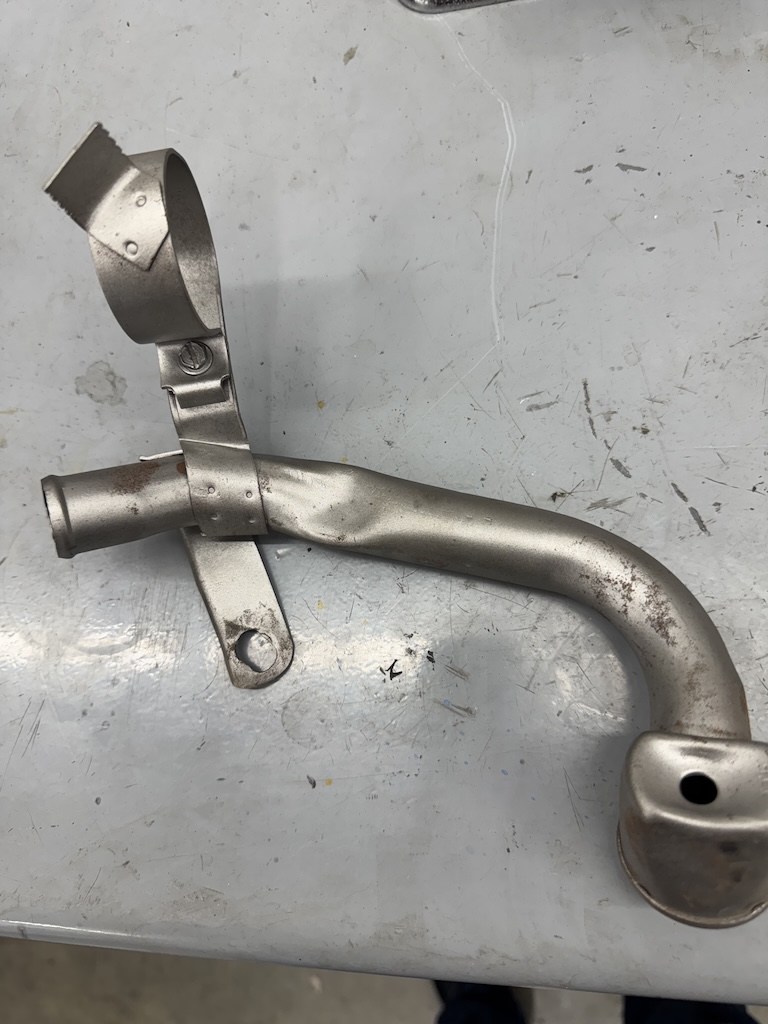

The basic tube is the same as '67 Chevelle with L79 and L30, EXCEPT the valve support and plug wire stand are at different angles, different pieces actually Examples posted for comparison.
But, Camaro may be different??
