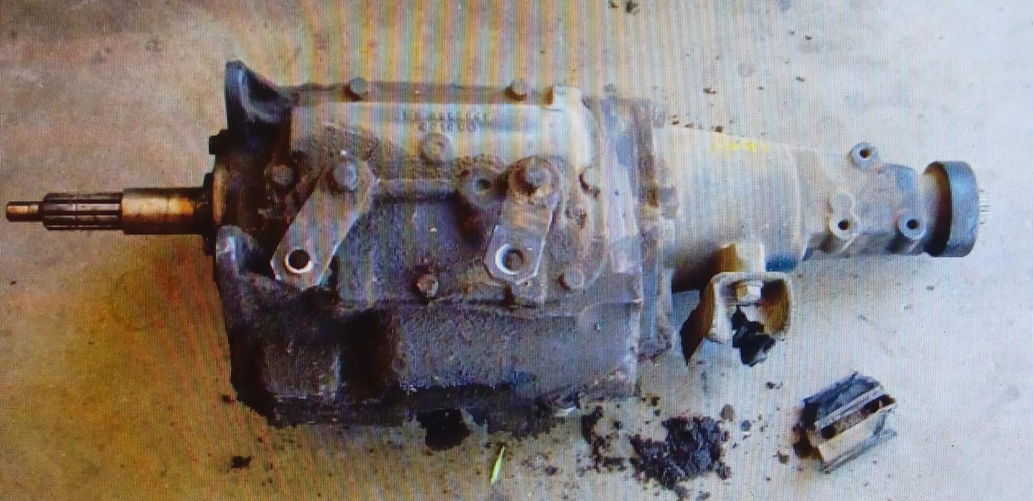

I’m trying to find the number for the SB lower rod on a Nova. The lever and upper rod were shared with the four speed. My parts books and AIM are vague. The 3sp in the AIM is a Saginaw. Anyone have better info, setup in a car or parts in the stash?

Curiosity kicked in.
Top pic is Muncie
Bottom pic is Saginaw.
First- reverse levers are in same place.
Your pics above show 1 Muncie and 1 Saginaw.
First- reverse lever shows same part number for both.
Why would the rod be different?
Top pic is Muncie
Thanks for these. That is what I’m trying to verify for sure. Perhaps the shift levers are different on the Saginaw? I’m pretty sure the frame mount lever is different.

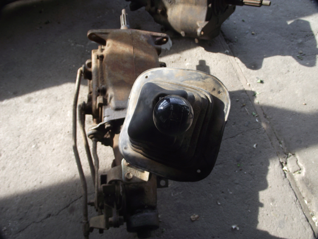

Is this the setup you are talking about? This is a 69 Saginaw 3 speed HD from a big block Chevelle.
If that is out of a 69 that is a Muncie MC1 3 speed. I don't believe a saginaw was offered for the chevelle that year either. There was a saginaw that resembled the muncie. Does the one pictured have the 5/16" two piece ball? Flat side shifter? Bench was flat buckets said muncie, I believe.

Default sure looks like a Muncie to me
Looks to be a Muncie.

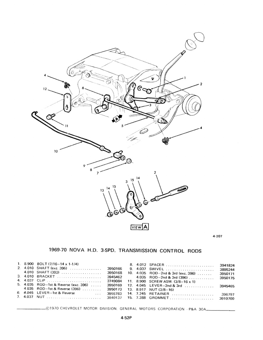

Rsconv68 Rsconv68 is offline
Join Date: Jul 2022
Posts: 308
Thanks: 15
Thanked 159 Times in 86 Posts
This?

Old 04-05-2025, 03:25 AM
Grim70 Grim70 is offline
Join Date: Mar 2012
Location: United States
Posts: 120
Thanks: 9
Thanked 43 Times in 22 Posts
Originally Posted by Rsconv68 View Post
This?
See how everything is (ex HD). Also those are the shifter control rods.
