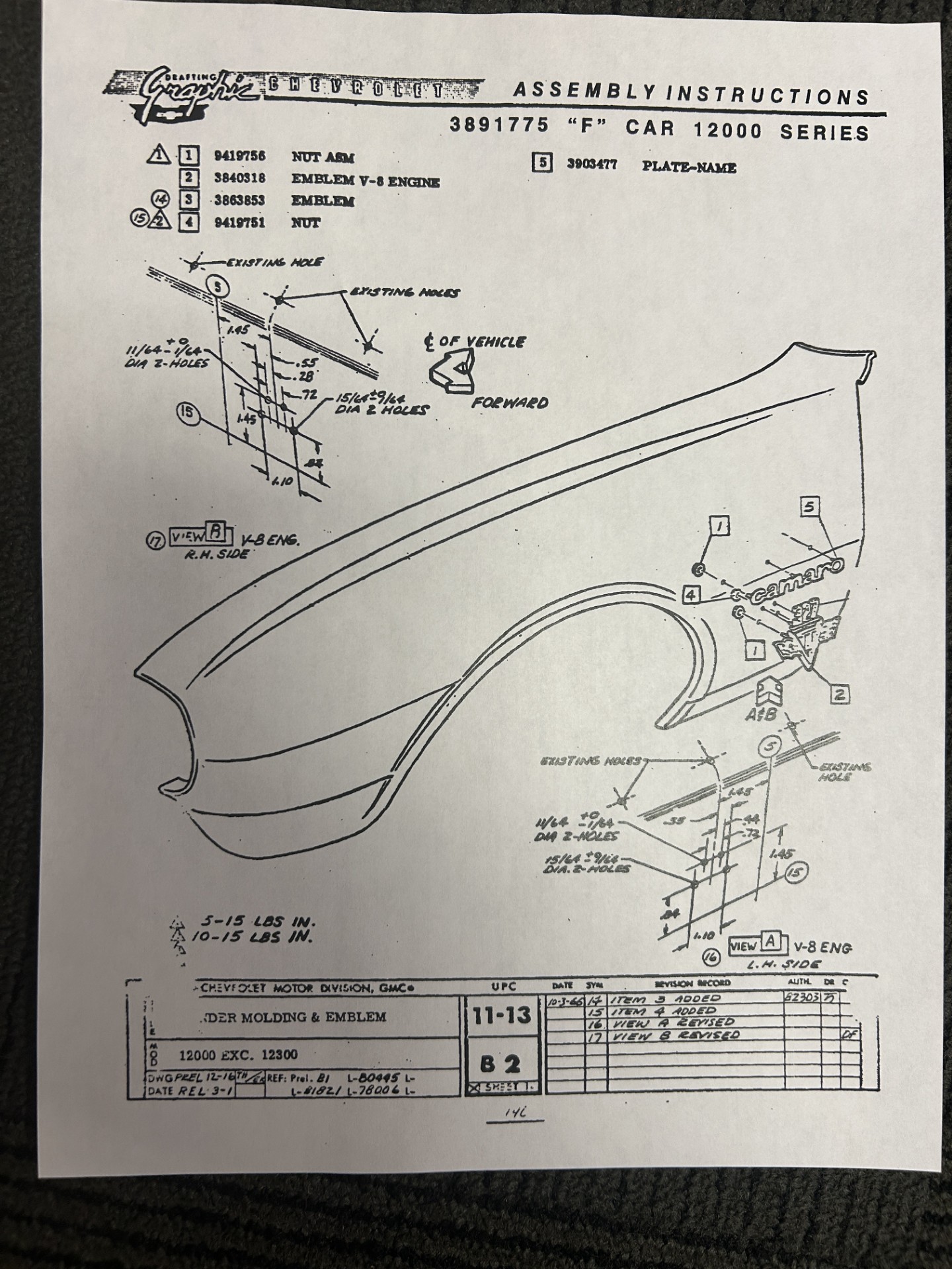

I've spent about an hour now and gave up finding the dims for placement of the V8, 350 and SS emblems on my '67 SS. I have NOS fenders and need to, accurately, locate these and I thought I had seen this in the manual, but I can't find them now. Anyone know the page(s) numbers I'm looking for ???
Thanks in advance for the guidance...
