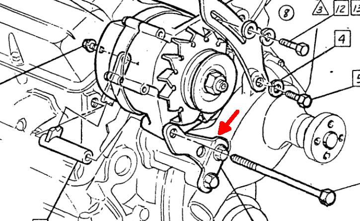

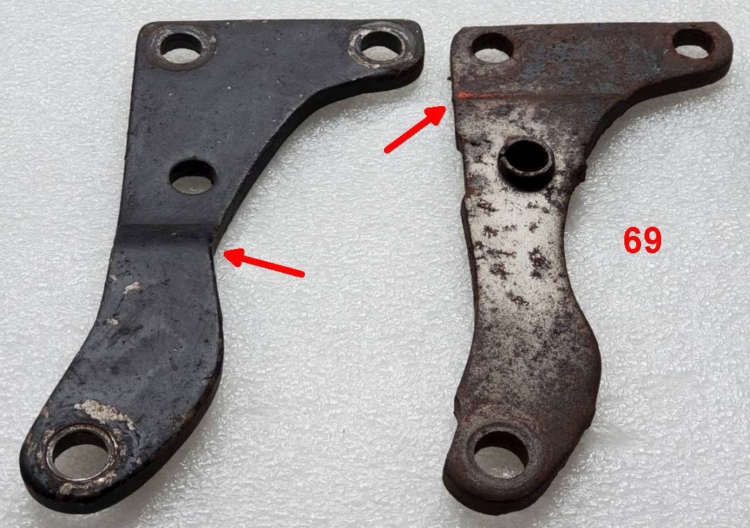

There are 2 versions of the 69+ small block lower alternator bracket. The stamped offset is in different locations. Part # is 3951500 and it is used at least until 71, if not longer.
I know the one labeled 69 is from a 69 SB and, with the offset by the two mounting holes, it matches the AIM drawing.
Is the other version just a later version? I have several of both styles.
