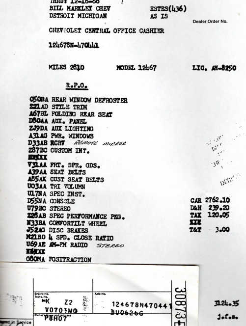

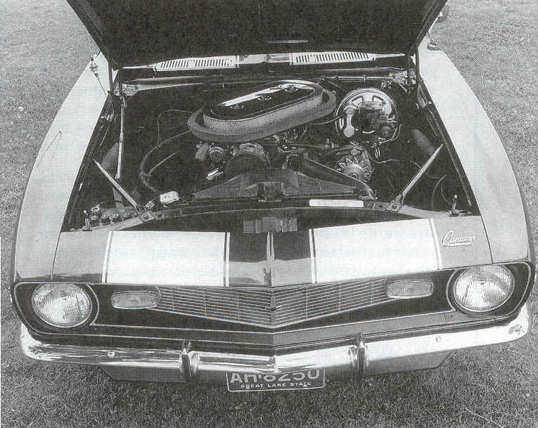

Just some food for thought..
It is well known that ‘all’ x-rams were non-factory installed, but would this car be considered a factory installed X-ram car ??
Was that car totally built and ‘finished’ inside GM ??

The Pete Estes convertible Z did not have a cross-ram on it. It was a stock high rise and single 4-barrel with a cross-ram air cleaner. Look closely at the original picture. Three wing nuts.

Just a used car by Dec 1968. Looks to have regular tags.

By the time this video was made, they had the cross ram set up installed on it.
https://www.youtube.com/watch?v=leilxEyW6SI&t=3s

Yes, cross-ram and 4 wheel discs added years later but was not built that way by GM back in the day. Regular BU axle as shown on William's attachment.
