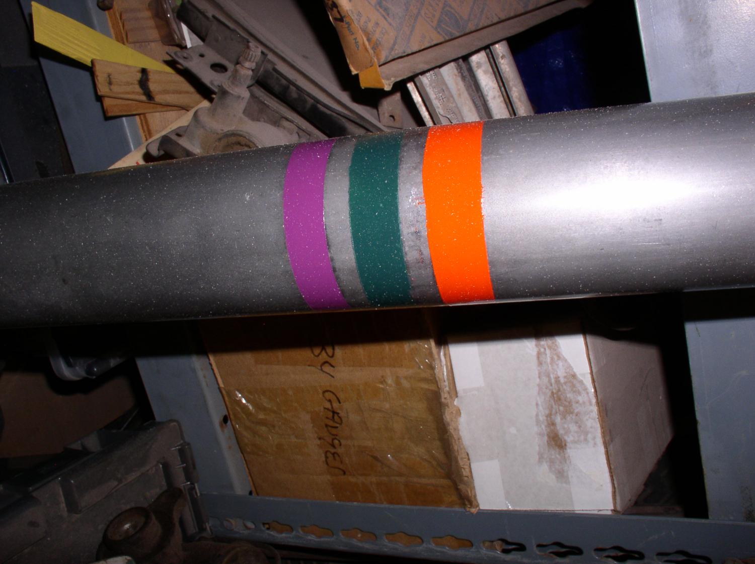

Any of the items I needed to look like raw steel, I used a satin clear on after I made the steel look correct. This is my drive shaft...Joe

...............And, HOW did you make the Steel Look Correct........?????

It would depend on the part. That driveshaft was soaked in eveporust for 24 hours, rinsed, dried & then 0000 steel wool. Stripes painted & then clear coated everything. Some parts needed to go in the blast cabinet. I use black oxide & lower preasure so it doesn't scar the metal. Another thing is I live in southern Az so we don't have the rust problems other states may have. I can't afford what the pros may do so I have to experiment at home....Joe

I forgot to add that sometimes I would need to go over the parts with a wire wheel on a drill after blasting to almost polish it before clear coating. Trying to remember all the details....Joe
