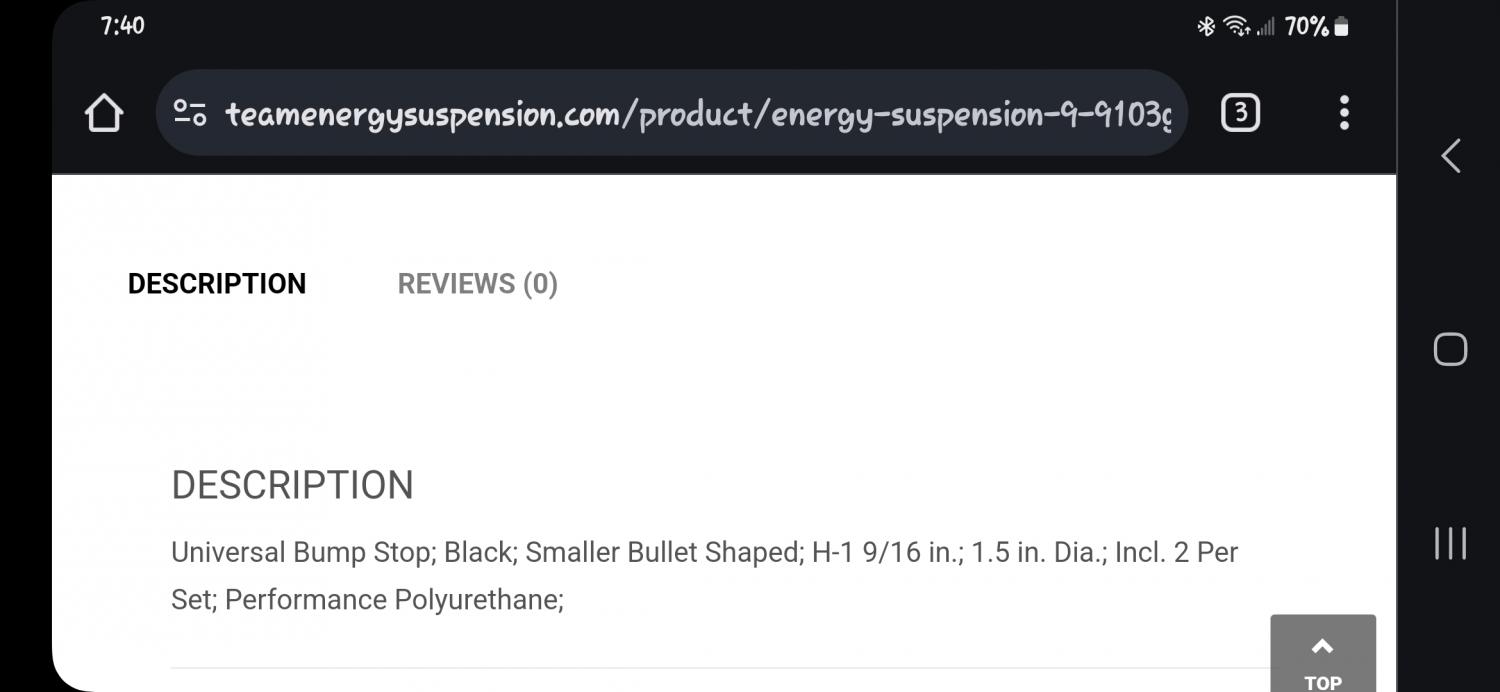

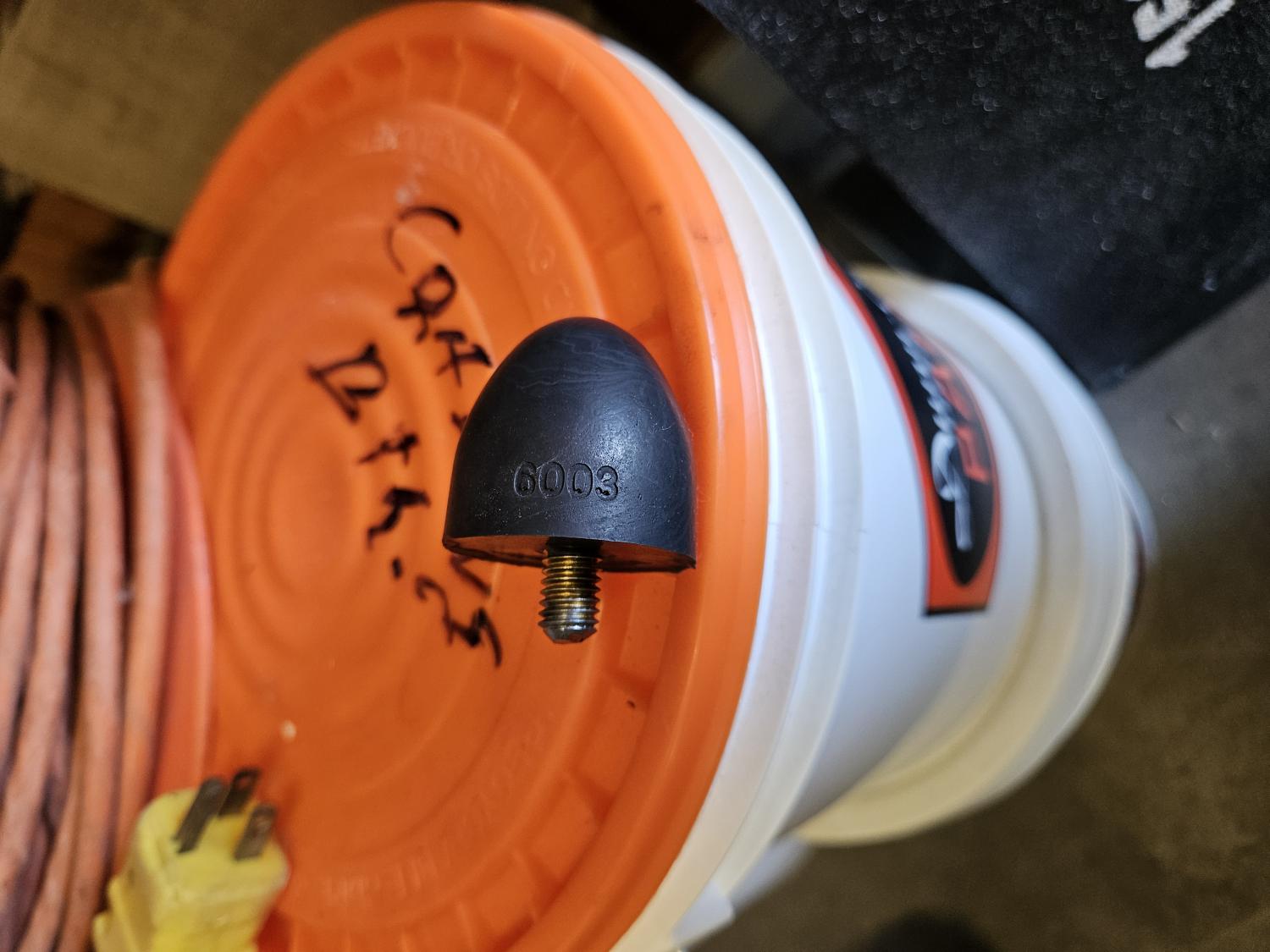

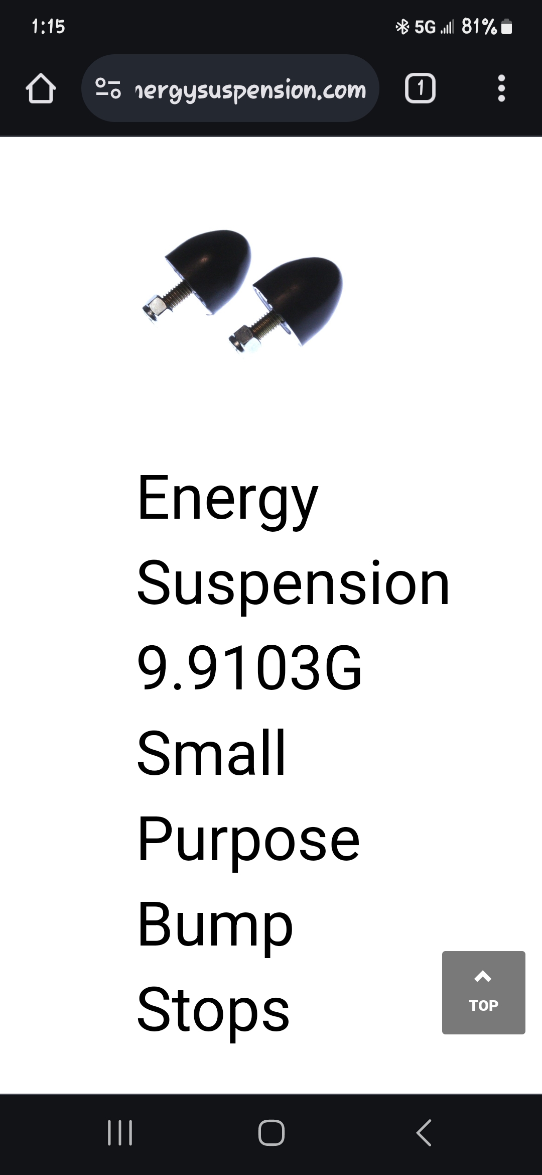

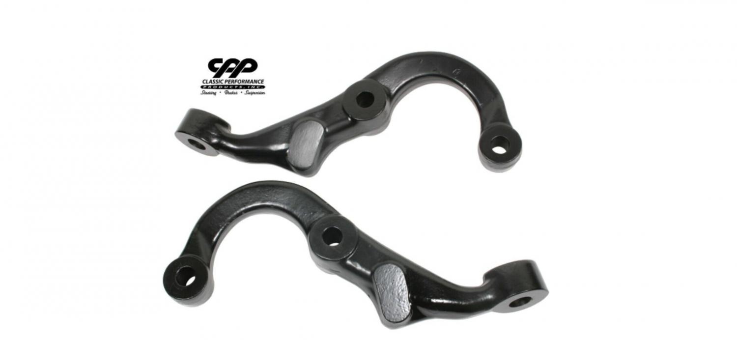

How about drilling and tapping the steering arm itself. I'm not sure how much that would "compromise" the arm, but it wouldn't have to be too deep? Here are a couple pics of what I'm thinking. Drill and tap the arm where the flat area is on the arm and install this Energy Suspension bump stop with plenty of Loc-tite!!?? And, again, it wouldn't have to be too deep, just enough to hold the bump stop in there? The stop wouldn't be contacting the a-arm that much during regular driving, right?

Tapping the steering arms is a better option, but you may want to go all the way thru and use the stop threads as filler. I would look into repop stops made of rubber, as urethane doesn't really give on contact to soften the force of the steering arm against the tube. If you find a good solution, I may have to "borrow" it...

I'm thinking of just drilling and tapping them about 1/4"-3/8" deep, and using Loctite to keep it from backing out. The stock steering stops are little "bumps" on the lower a-arms, metal to metal. So I think the poly stop I'm thinking of using would be adequate and not too "harsh"?

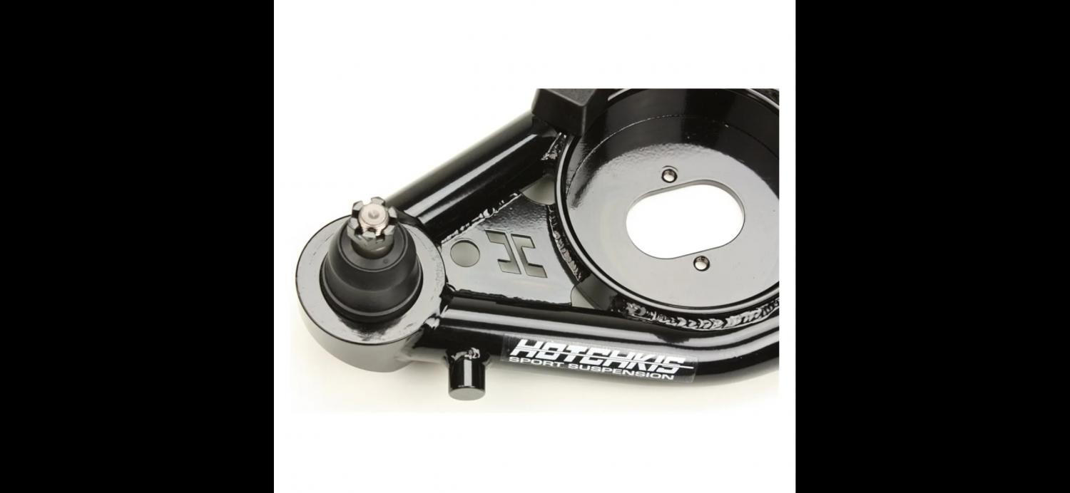

Well, would you look at this!! At least one company gets it!! I'm still not sure this would even work for me since I'll need close to a 1 1/2" bump stop!!??

That is interesting. I'm thinking that since they installed the stops, they would have researched how long they needed to be for stock, original steering arms. If you have aftermarket steering arms, they may be different than original too.

Here's an update, in case anyone was wondering what I did!!
I decided to drill and tap my steering arms to accept those polyurethane bumpers (it was actually my neighbor who did the drilling and tapping!!) I finally reinstalled the arms and it looks like it should work perfectly!! I'm a little curious as to what the "stock" turns are for the steering wheel, lock to lock?? Can anyone check and let me know?? The tires are about 1- 1 1/2" from hitting the frame now, which is a big improvement!!

Good of your neighbor to do that, they look good. If you want less turning radius, you can shave the stops down some too, plenty there to take a 1/2" off, if needed.
