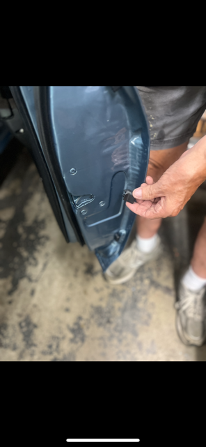

Hopefully someone has an original 68 nova. Does anybody have a picture of what the retaining nuts look like that attach the trunk emblem from the factory on a 68 nova? Also on the front parking lights the screws that bolt it to the bumper. Lastly the rubber bumpers that fit on the door that attach to the door there seems to be a bigger one and a small one not sure if one is the upper or lower.

there is 2 bumpers one of them is bigger than the other not sure which one goes where

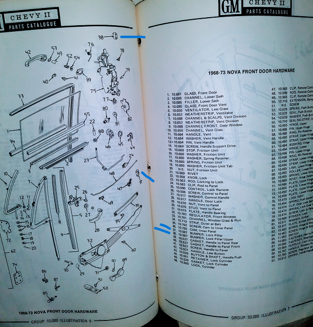

9566BA I found this note in GM product info program,#38 smaller bumper on top of door & #37 larger bumper on bottom of door.

Where did you source the reference book you are showing pictures of?

Good day, crossbreed383 this info is contained in the master parts catalogue for chevy 2 & nova. If u need some pages copied let me know. Thanks for your interest. Marc.

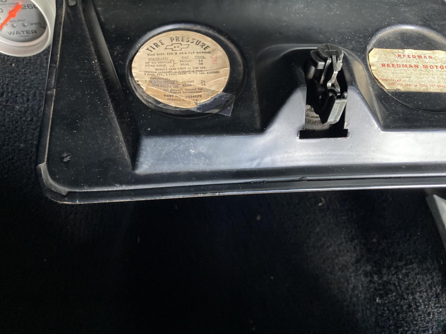

Anybody have a 68 nova with the original tire sticker in the glove box and which side is it on ?

Mark just now sent me this pic of the tire pressure sticker on his 68 L78 Nova. He doesn’t get this car out to often but says it’s a real L78 car. It has a CE block in it. White with black vinyl top car. He says it has had a kinda rough life being raced a lot.
