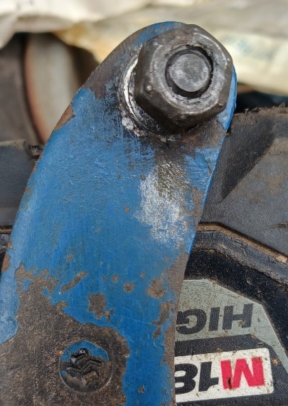

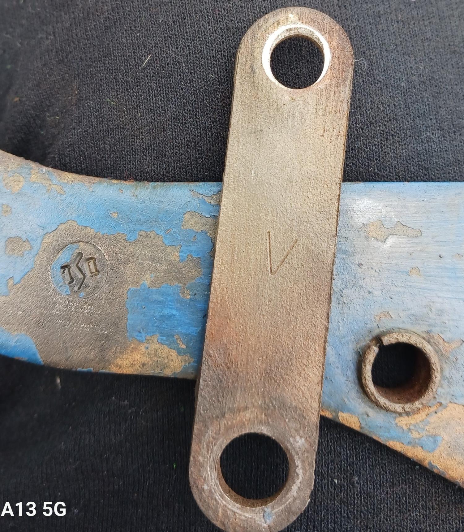

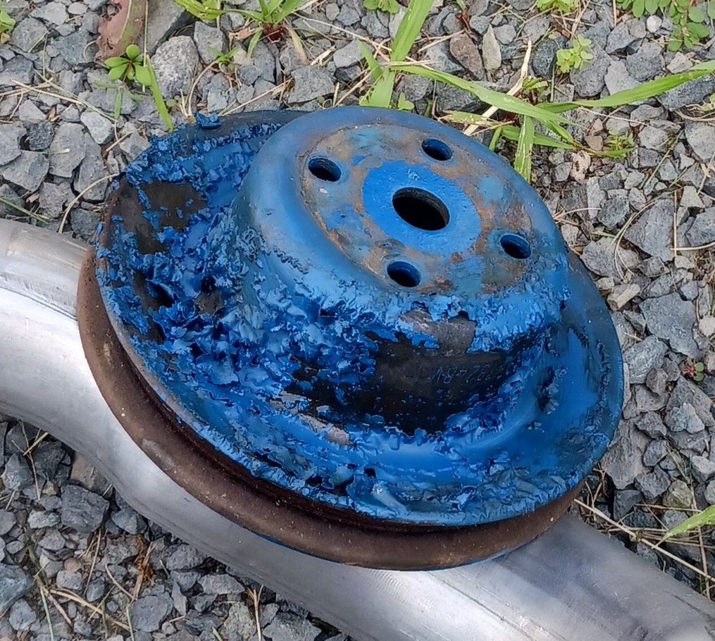

third week Feb Baltimore 69 Chevelle L78 M22.
The original owner brush painted the motor assy lemans blue lacquer.
This included pulleys and alternator braces.

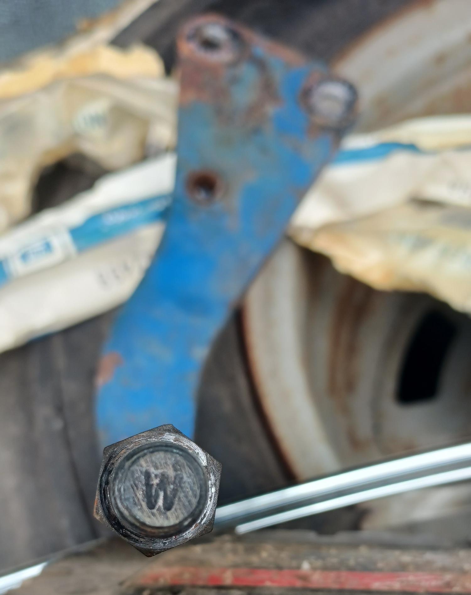

Cleanup time and it was discovered the pulleys- alternator braces were not painted.
Aircraft paint stripper took the lacquer off easily but did not touch the finish on pulleys or braces.
Did a thread on Team Chevelle on this.
Seems the pulleys- and hood hinges, throttle cable bracket, alternator fan, hood latch assy etc. are phosphate.
Alt braces seem to be black oxide.
What say you?
I always thought they were painted but it does not look that way.
pics of the work.
note defective die on smog and water pump pulleys.
Re- pops are much prettier .

Default for sure not painted
Looking for info on how they were when new.
Not what judging standards are.
I always assumed they were painted. Now that I am paying attention it is obvious to me they are not.

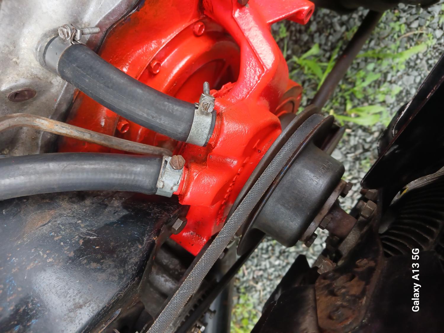

Car does not have power steering so no pulley to look at there.
The pulleys- braces were preserved with Lemans blue lacquer and are in pretty nice shape.
Pulleys are a match for the finish on hood hinges, hood latch [ both lower and upper], alternator fan, throttle cable bracket etc.
Finish is greyish- green and textured.
Alternator braces are satin black and textured a little. Almost looks like runs on upper.
Starter finish resembles this some but is much more weathered.
Thread on Team Chevelle suggested iron oxide on alt braces. Looked into this and "black oxide" sure looks like a possibility.
Some forms can exhibit runs.
Thought folks here would be all over this and I am not doing anything with the blue car.
Her other cars are why i am looking for verification on this. Will be doing this to parts on them and just want to be sure. Will be taking examples to platers to see what they say.
Thanks for the reply

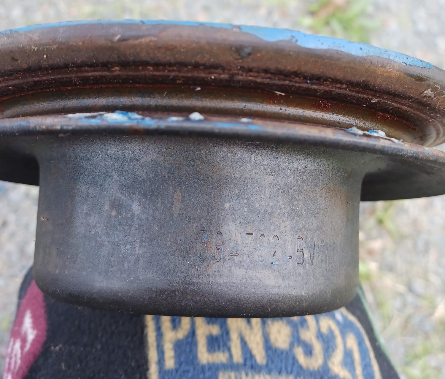

Thanks Kurt,

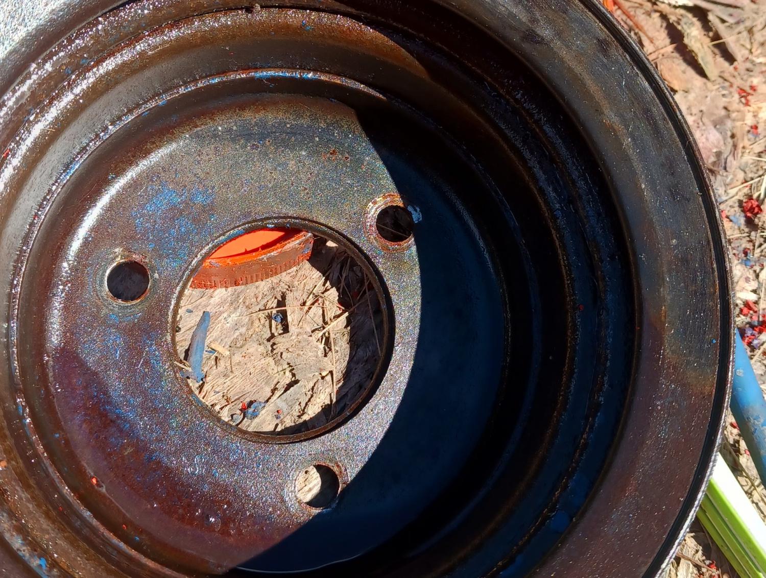

This is front view of lower pulley.
The part number is weak and could not get a readable pic of it.
The S is clear though.
Front area did not have as much blue on it and it suffered more.
Sides are good and it is the same finish as wp and smog pulleys.
I have seen painted pulleys also.
This was a surprise to us.

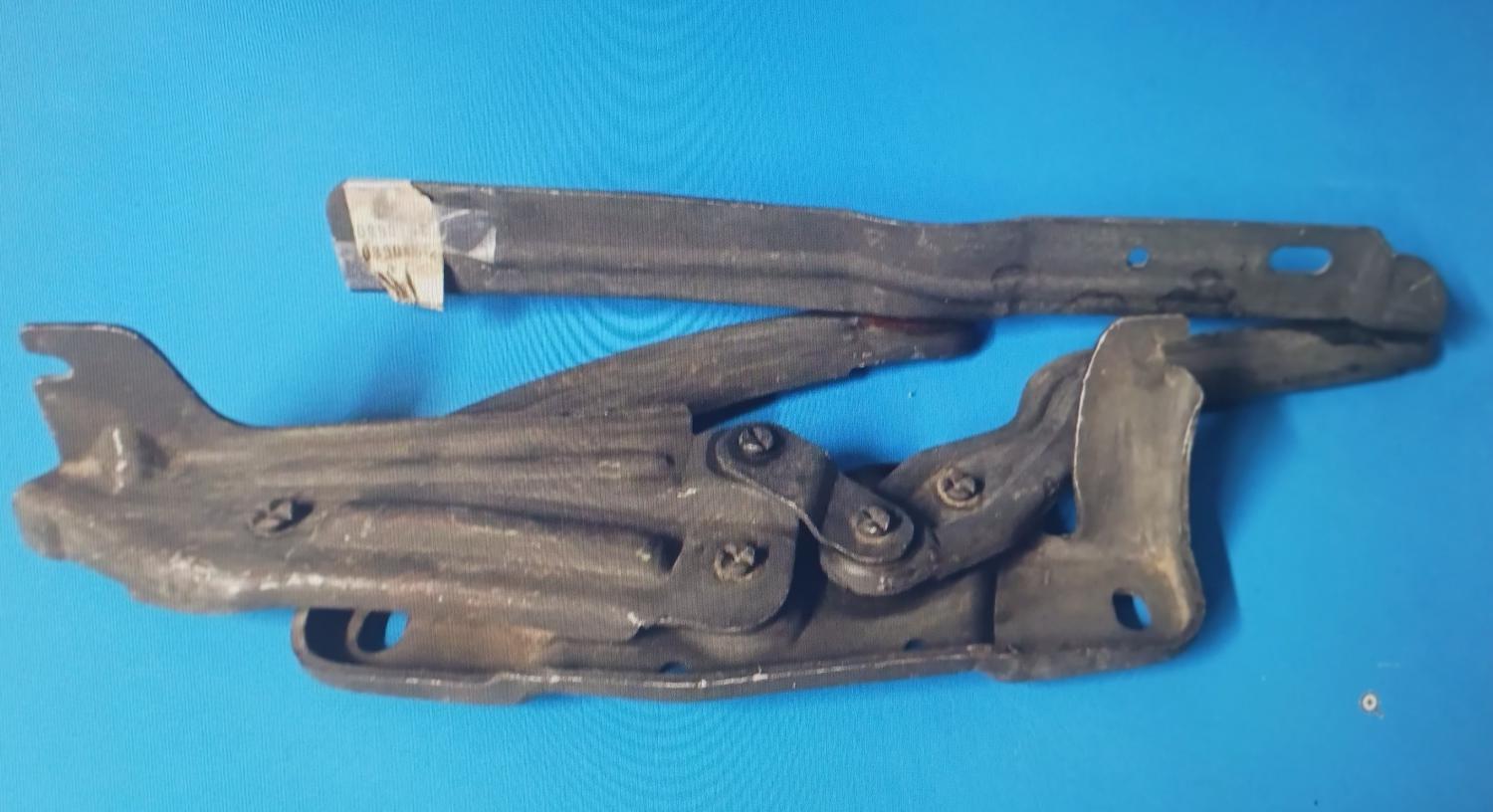

Example of same finish on an NOS 68 hood hinge.
