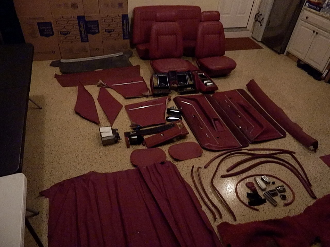

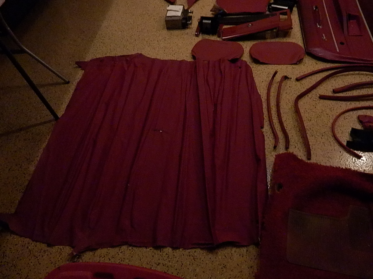

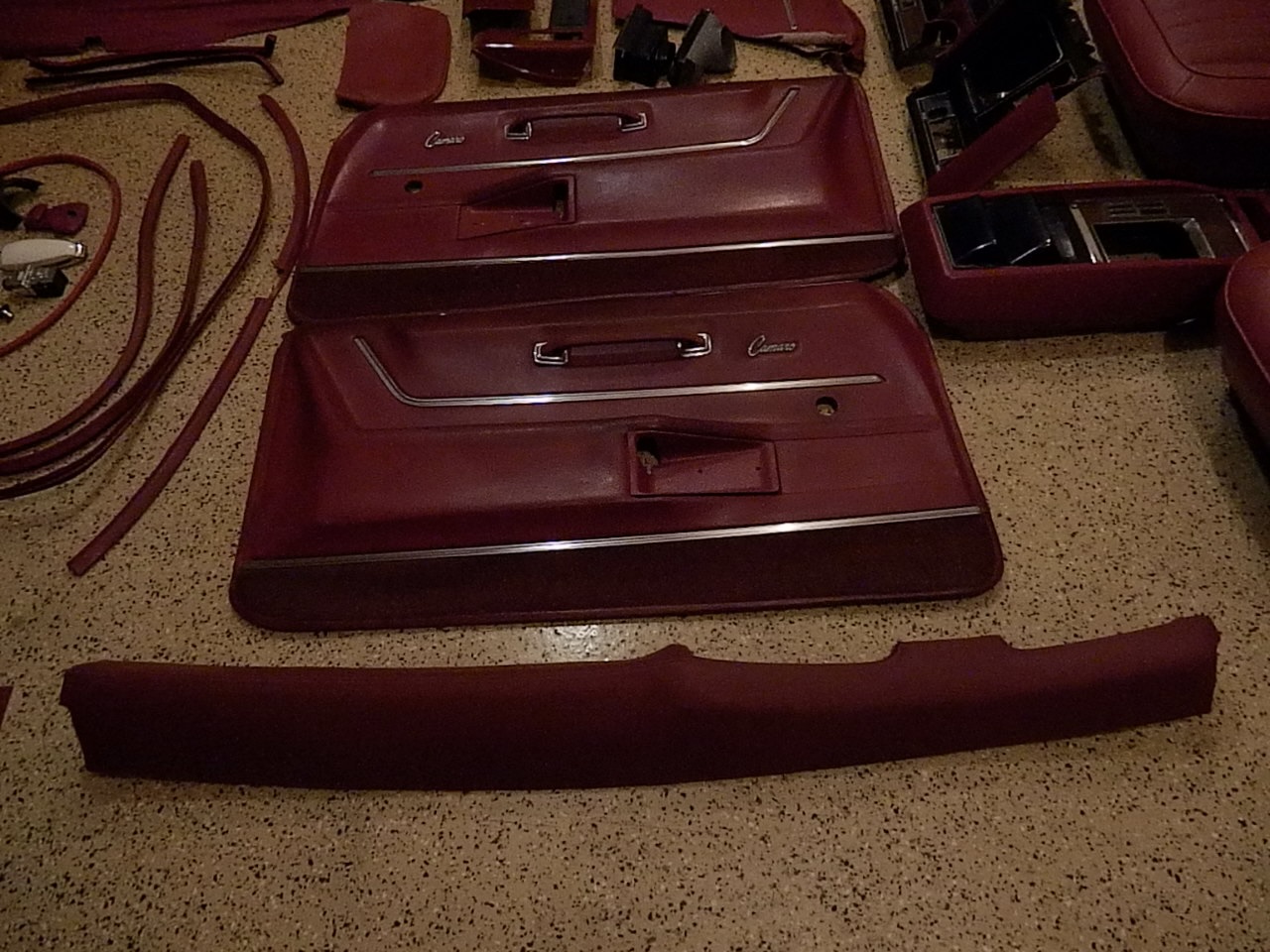

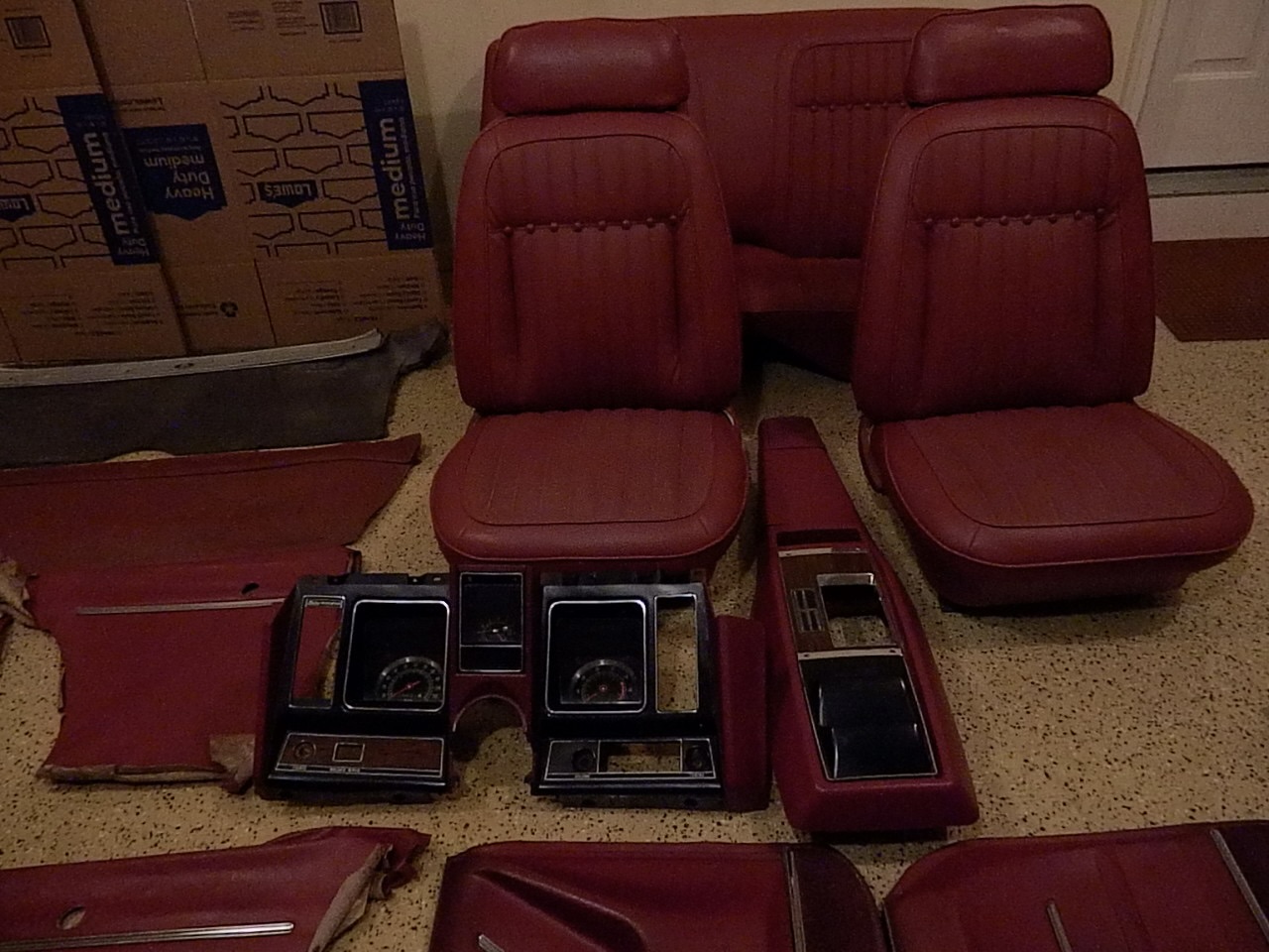

It is hard to believe what is still out there for sale. I got a phone call on April 23rd after the Spring Carlisle Swap Meet, the gentleman told me he took one of my business cards from my display at Carlisle. He asked me if I would be interested in buying any interior parts from a 69 SS Camaro red/red car. He bought the Car in pieces in 2009, the previous owner removed everything & was going to make a resto-mod out of it. The current owner since then finished the car & kept all of these original interior parts except the kick panels.
There is a certain member on here (Fred Schempp) who we all know has a red/red 69 L78 car who has been looking for red interior parts forever. Long story short, I went to look at the parts on Friday & was amazed at what all this guy had for all these years sitting in his basement since 2009. This is NOT a for sale ad, Fred will have the 1st opportunity to own these parts.

Wow looks in great condition. Too bad that car was taken apart

great find Jeff. you don't find interior parts that nice especially Red.

Deluxe interior must have gotten the jute padding on the rear seat divider? My standard black interior car was just plain cardboard

Mine too.

That's not an original 69 Camaro package tray. Seats have been recovered. Carpeting does not look original. The rh dash trim should be woodgrain along with the ash tray receiver and glove box door.
Head rests covers are aftermarket; originals were molded.
Nice find, just not survivor original condition.
I thought the same thing. Great parts regardless.
