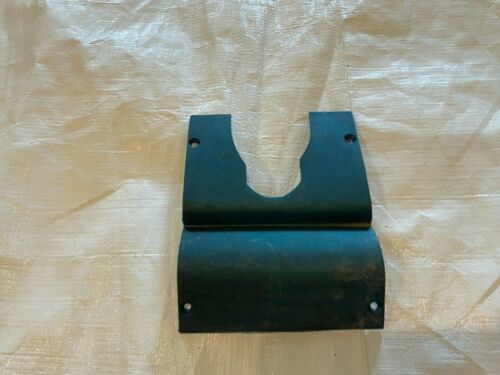

I do recall that Mopar frequently used specifically located screws that were the grounding screws for the dash. The pass through metal tabs on the printed circuit and gauge pod frame to the dash metal. IIRC it is one of the upper two screws of the four screws that hold the lower square panel below the steering column.

Thanks Steve. I will check that out. I have that piece installed with the four original fasteners. I will make sure they are grounded.
