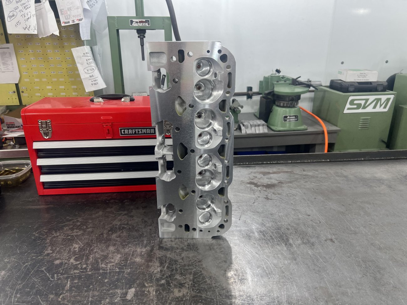

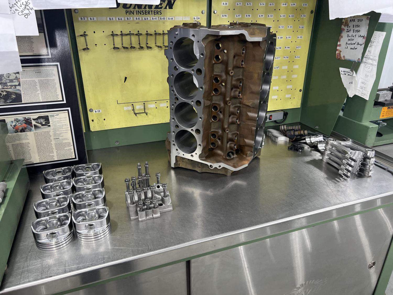

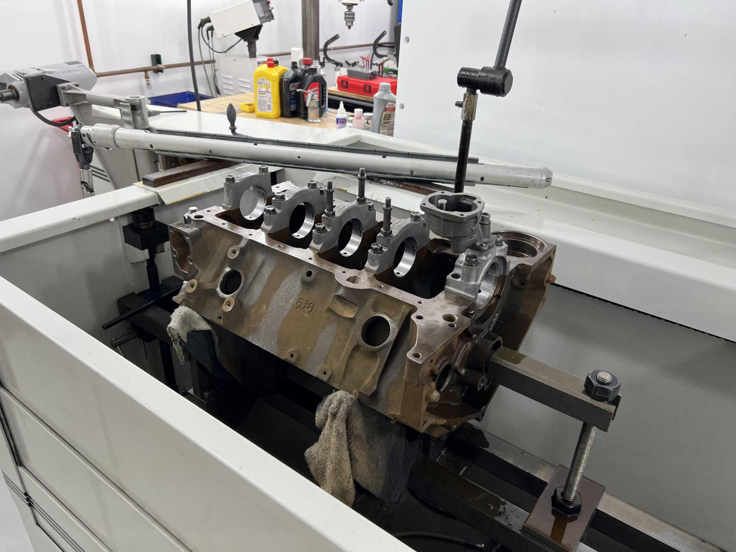

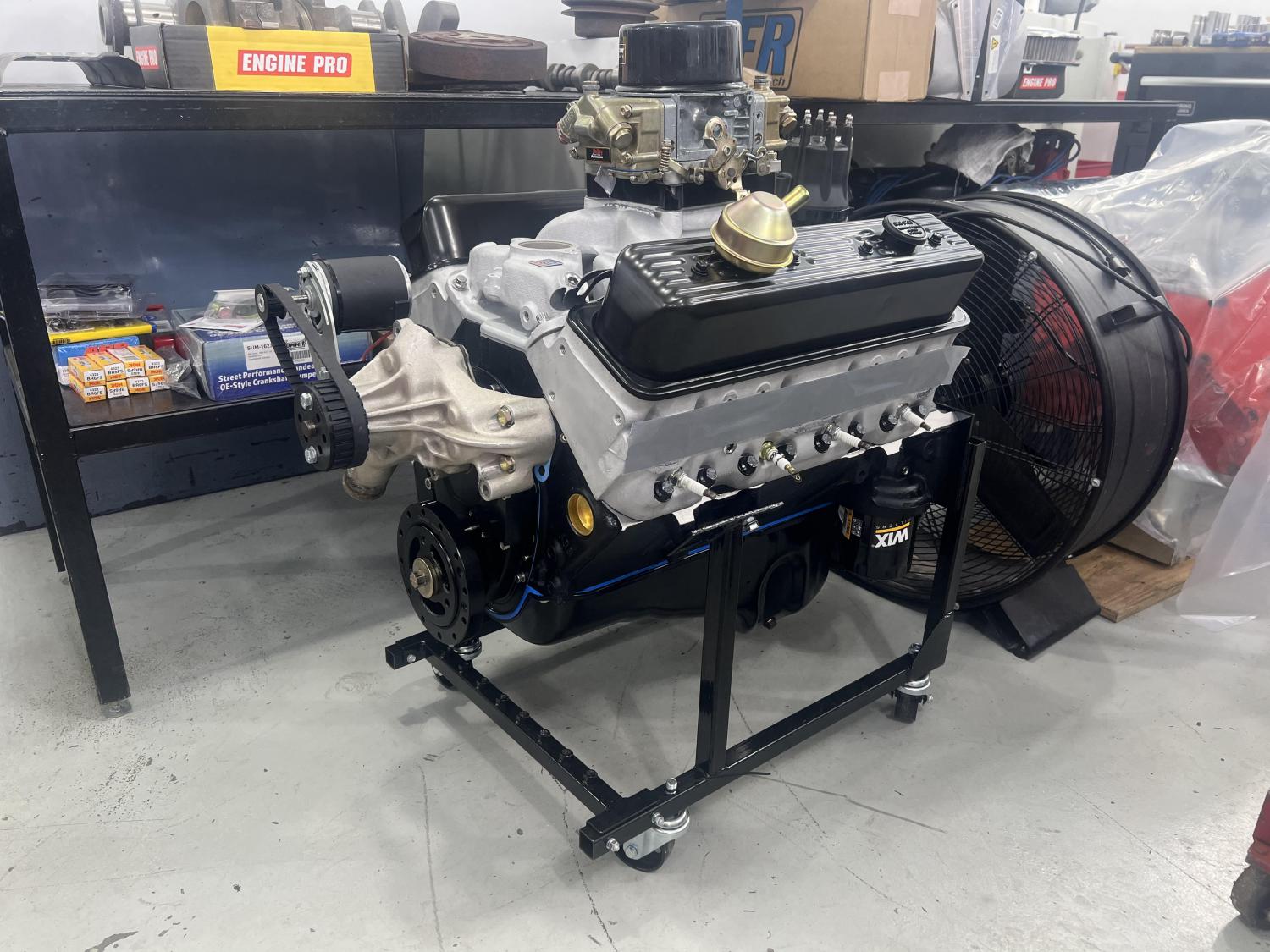

Dyno time with only 7 passes down the drag strip to verify performance. Mild 350 4 bolt, pump gas, 224 @ .050 .502 lift hyd roller, very mild, excellent vacuum. L98 GM aluminum heads, Performer RPM air gap. Would be just as happy in a truck or muscle car. Here's where my 350 is different than the others, it ran 10.88 @ 121 MPH in my Camaro NA with a 750 RPM idle.
