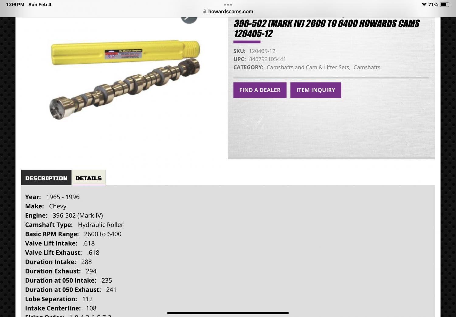

I think* I’ve got it narrowed down to three choices after talking to the fellow at Howard’s Cams.
In my other 1969 L71 corvette, I’m running a Howard’s roller and I love the way it sounds I’ve yet to drive it, but it sure sounds good.
So that exact cam is in the running.
Even though I don’t know too much and this is my first engine build, I realize that what vacuum the cam produces is an important factor. Not only for the vacuum operated headlights and wiper door, but for the distributor vacuum advance.
I’m running the original TI system that has been rebuilt to factory specs/advance by Dave Fiedler the TI “expert”.
Muncie M21 with 3:70 rear end gears.

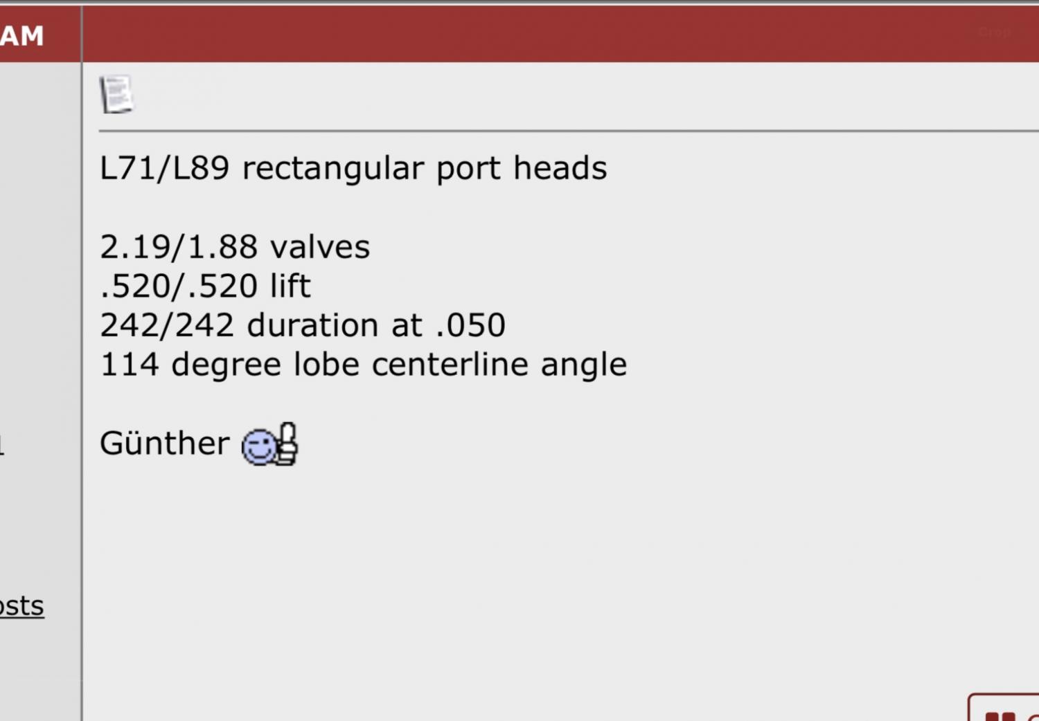

I’ll post up the factory GM cam specs ( Cam p/n 3863143) and then the 3 Howard’s roller cams I’m considering..
Any advice or input would be greatly appreciated.
