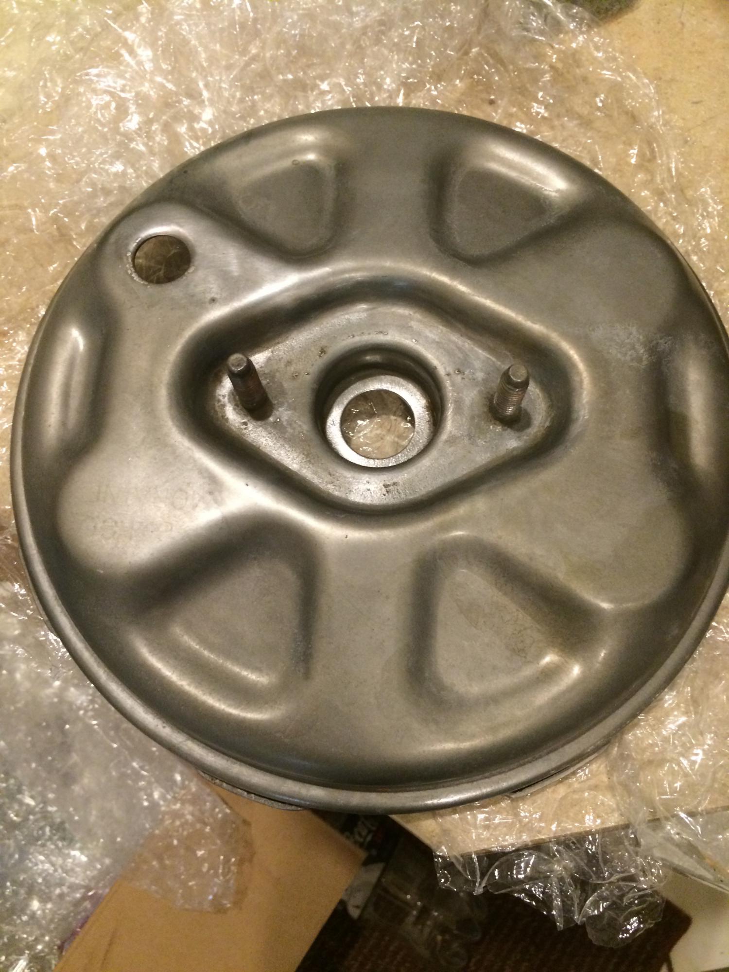

Old 01-26-2024, 01:28 PM
Join Date: Sep 2016
Location: Dayton Ohio
Posts: 945
Thanks: 330
Thanked 474 Times in 259 Posts
Some were very faint. My 1970 booster cover prior to send to BrakeBoosters.com for restoration. Look closely at the lower left corner. After plating, it completely disappeared.

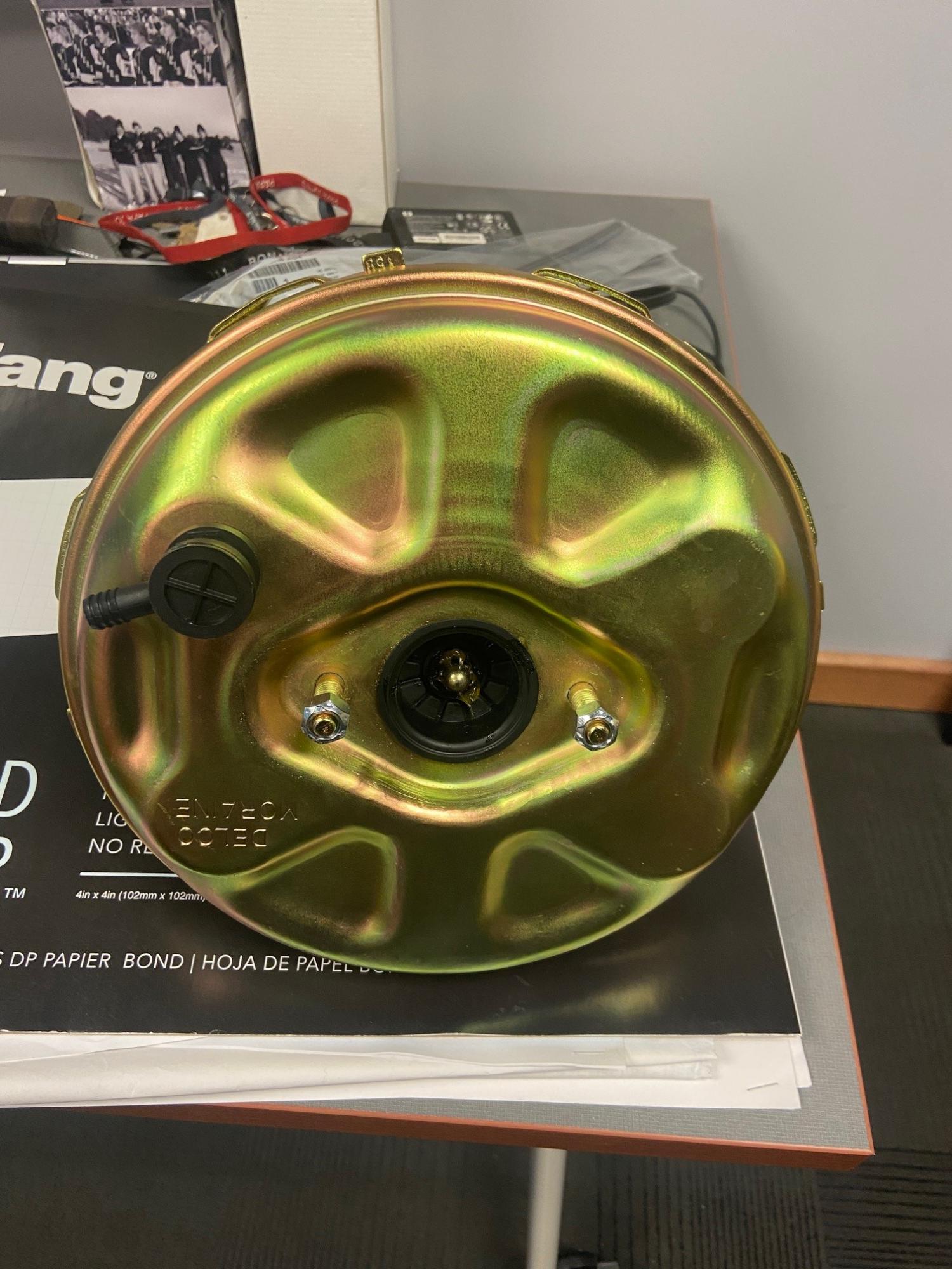

Old 01-26-2024, 02:48 PM
Jonesy's Avatar
Jonesy Jonesy is offline
Location: Duluth, Minnesota
Posts: 3,174
Thanks: 368
Thanked 839 Times in 518 Posts
I had Mike do a Brake Booster for me that had a very faint stamping that was almost unreadable. I opted for the engraving service he offered to get that back. It was for a 72 Chevelle SS454 Convertible.
