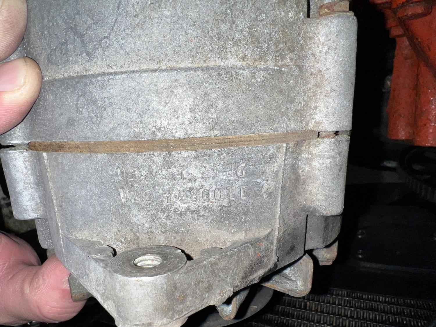

Is 9H17 a known date?
Thanks

Yes instant red flag. The first research I did showed 8/17/69 was Thursday not Sunday. Here is a pic.

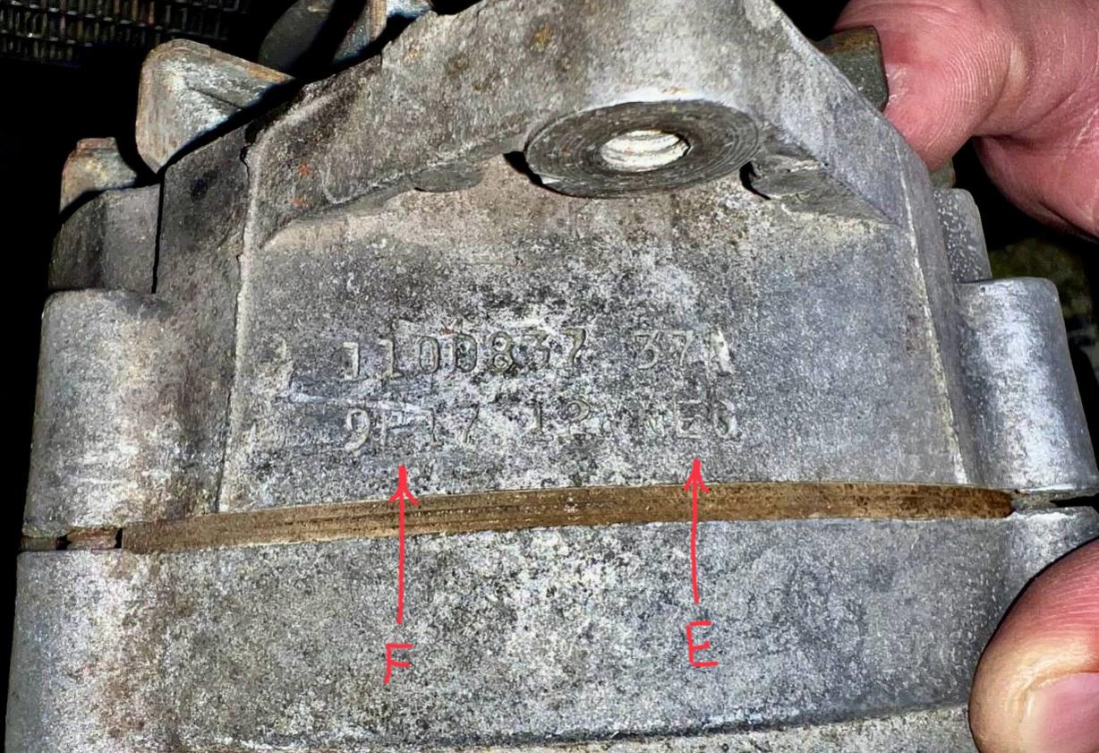

You sure thats not a 9F17??? Thats what it looks like to me and that would be a good date.

Default Alternator pic rotated.
Good catch Jonesy. Also the original stamping can become unrecognizable/change due to screwdriver gouges/marks when used as leverage to tighten the belt.

It’s a light stamp and I don’t have the car at my disposal yet. Will post more info after I get her home. Thanks
