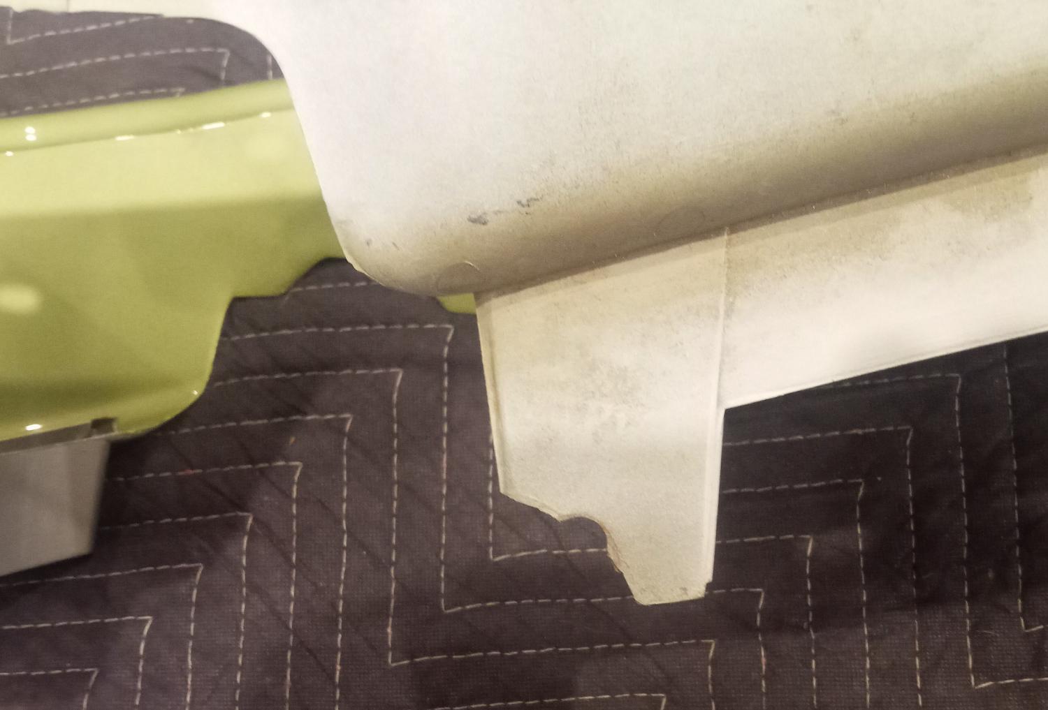

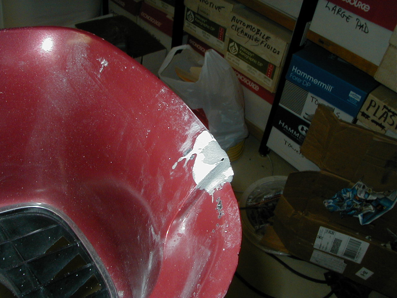

My painter accidentally broke one of the tabs of my original 1969 Camaro grille. He was going to "fix it" but the piece that broken off is now missing. Does anyone have a damaged 1969 Camaro original grille that the tabs are good that I could buy?

Thanks for the rely. I need an original factory installed white plastic one. Is yours an original factory white plastic one or the later black plastic grille?

Mike, I rebuilt large chunks of missing grill sections (much larger than yours) with JB weld. Believe it or not the dried JB weld is very close to the "bone" color of the plastic. I just used masking tape as a backer to fill large missing sections. And your break looks to be the bottom, so it would not show much anyways. My .02
