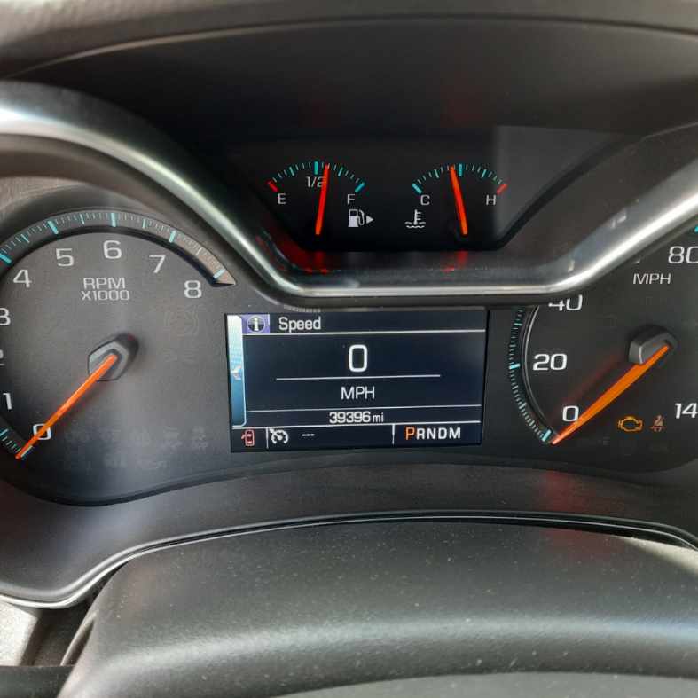

I just picked up this gem yesterday to serve as my new DD. To say it is in incredible condition would be an epic understatement. It's literally one of those "one owner little old lady" cars that's spent the vast majority of its life in a garage. It's a 2014 and only has 39K miles on it--when we put it up on a lift during vehicle inspection before I bought it, the undercarriage is damn near showroom fresh--there's barely even any surface rust on the exhaust system.
