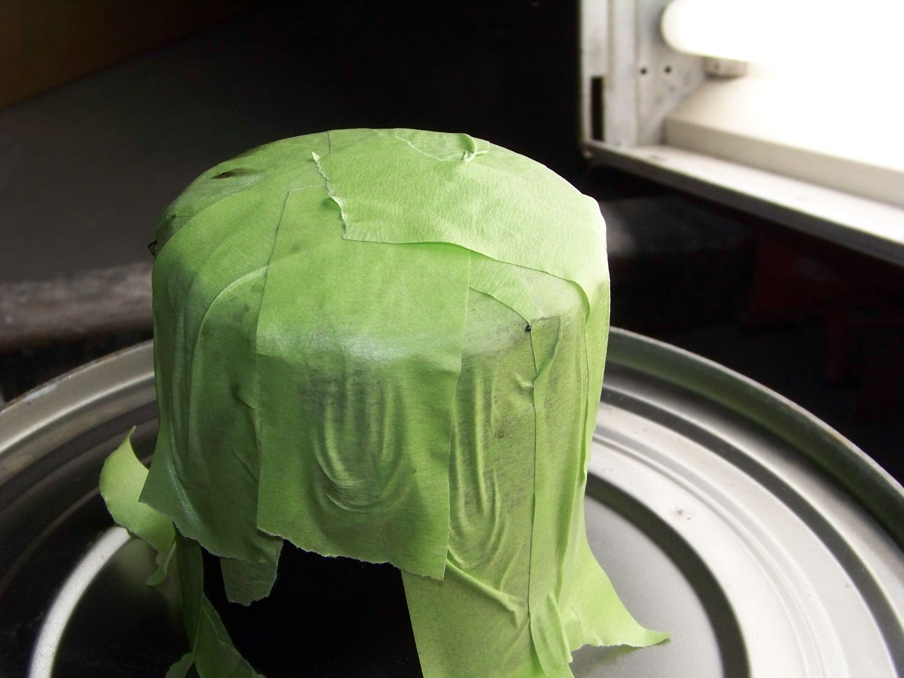

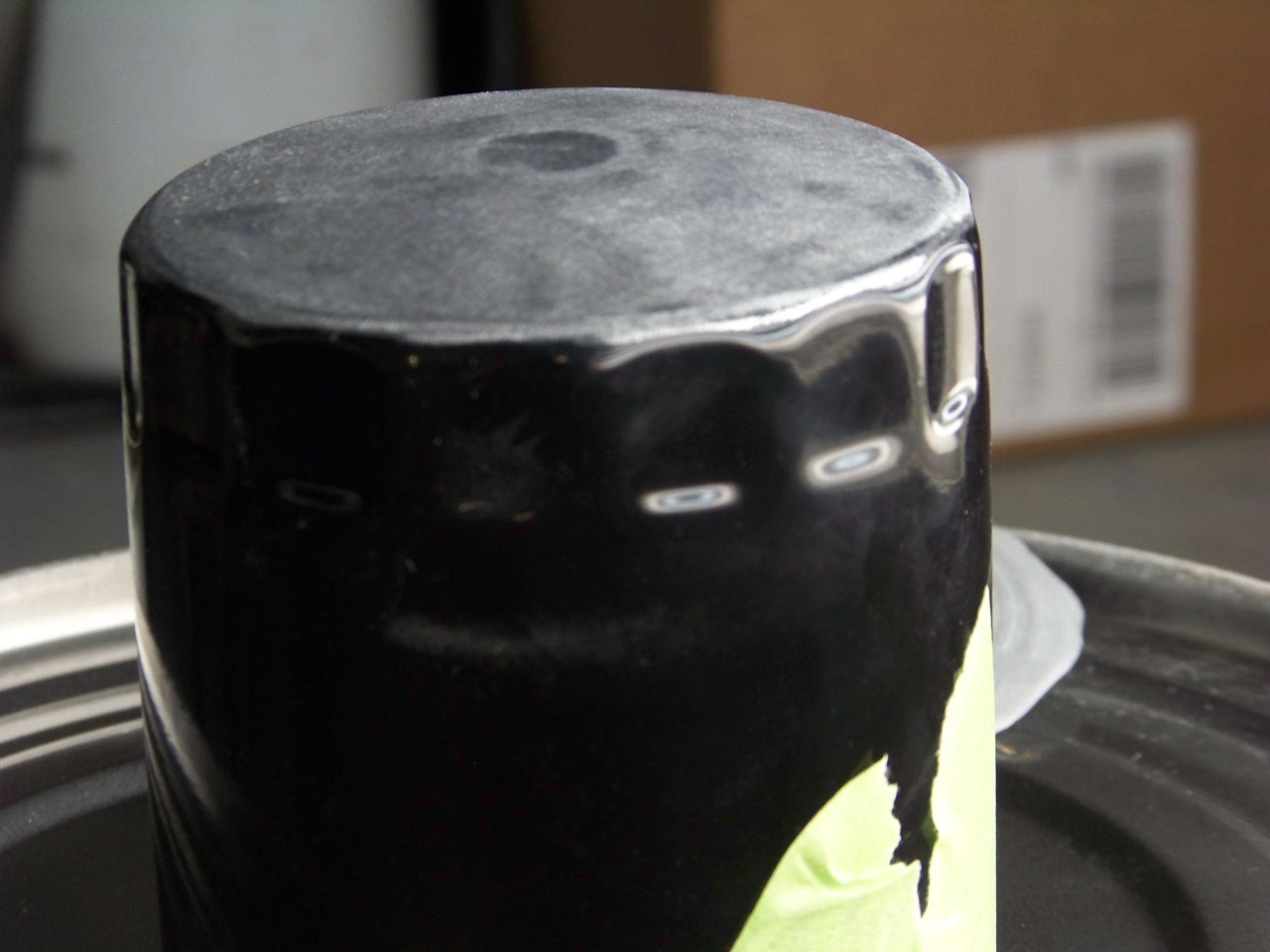

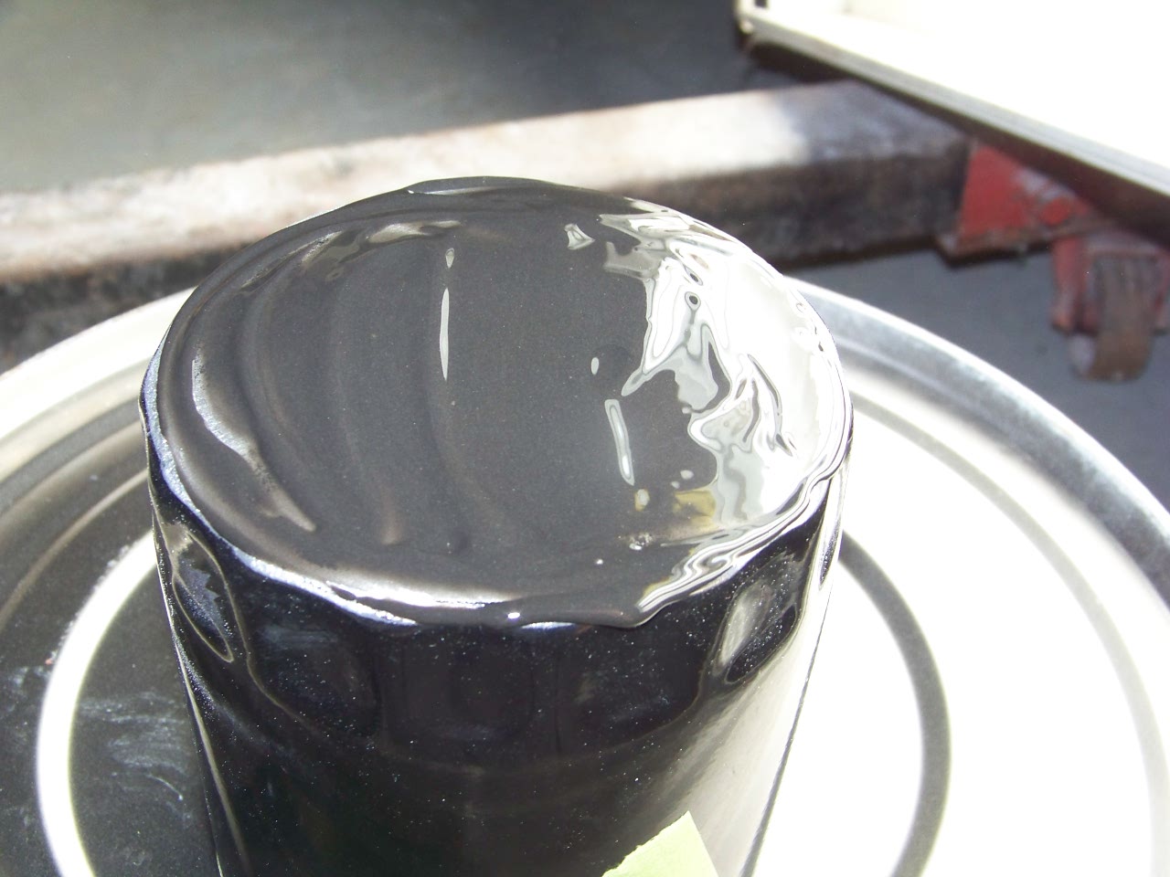

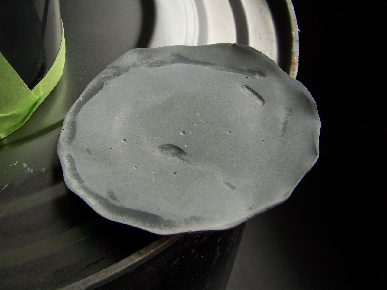

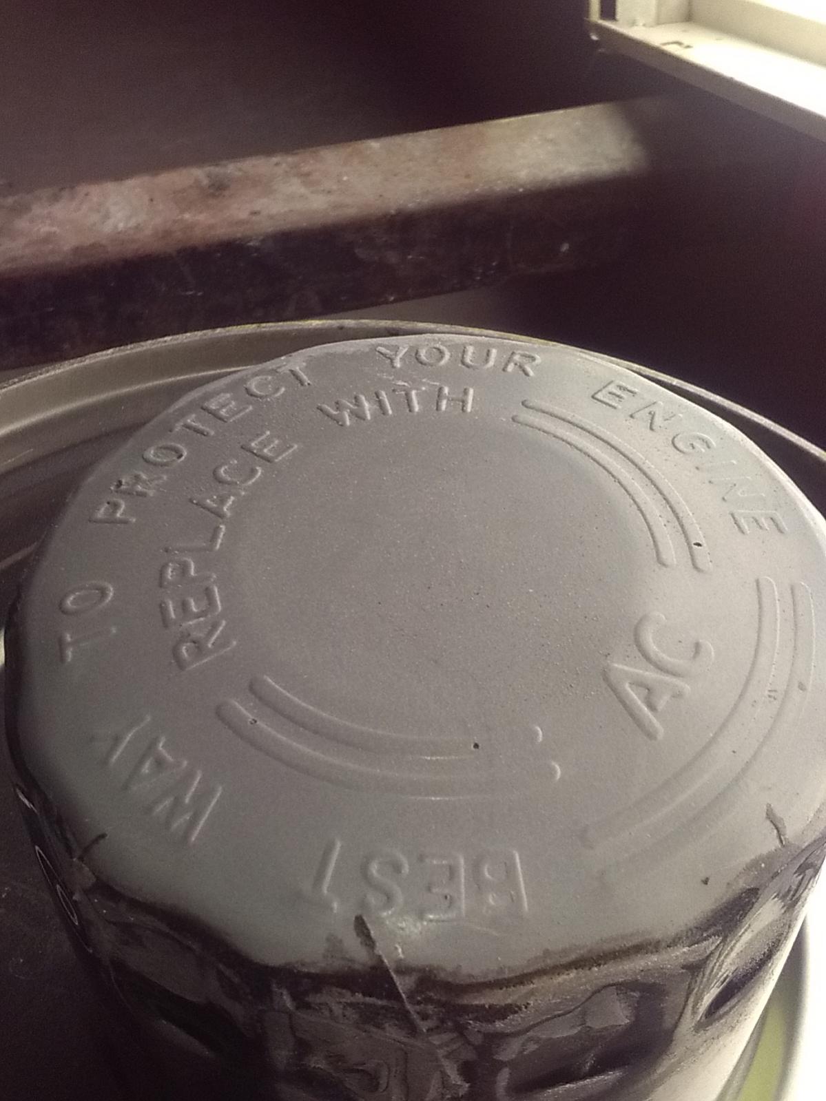

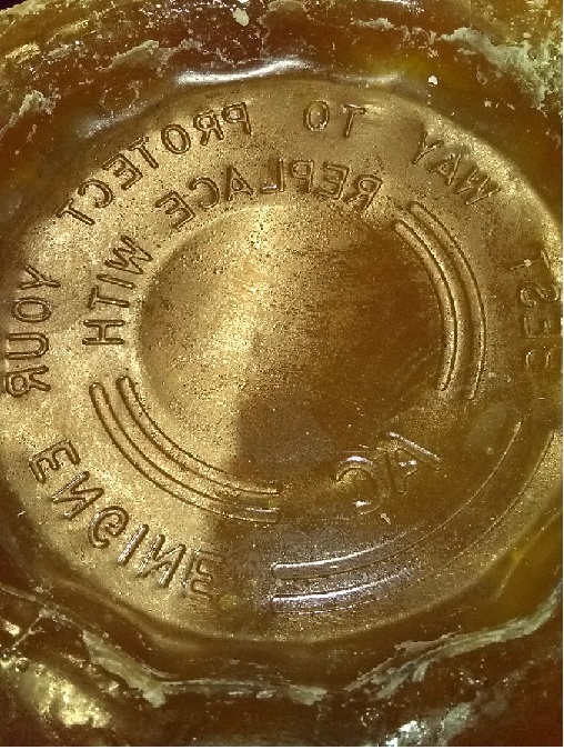

I pulled a fiberglass mold from the bottom of an original and pulled a relief and bonded it to the bottom of std WIX oil filter.
I have not finished it off as of yet.

Brilliant Plans to do the logos around the side as well?

Yes sir... I have a sticker from PARTS PLACE which is the red and blue print... however I am planning on doing the black ac logo like was on the 1100 mile 70 Z28 Charlie had.

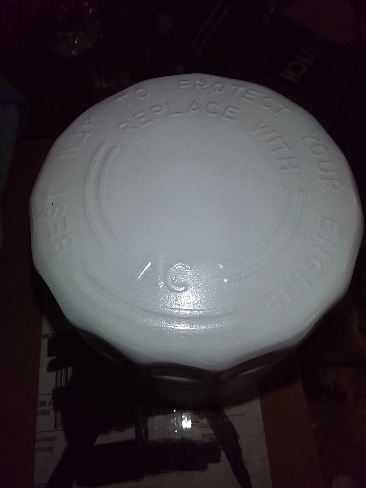

With a quick coat of white paint...
At about 2 hours plus materials... $350 oil filter. lol
