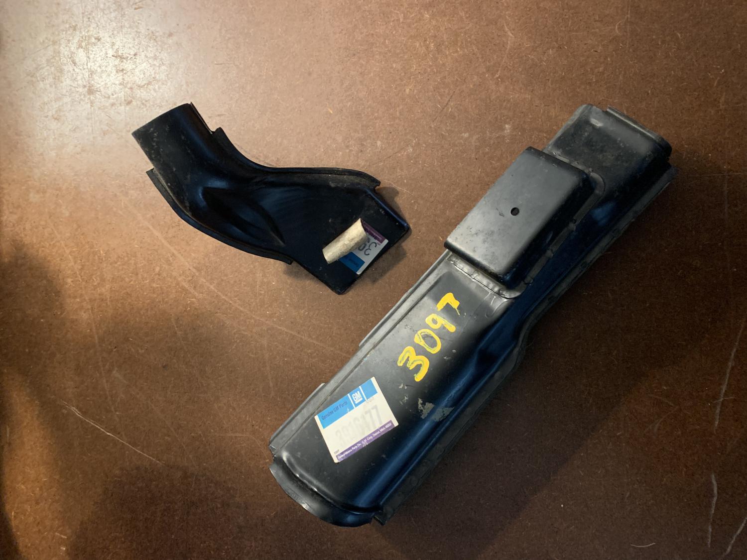

I have the following 2 pieces, the upper and lower “heat stove”.

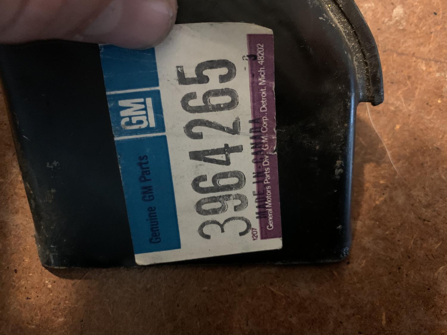

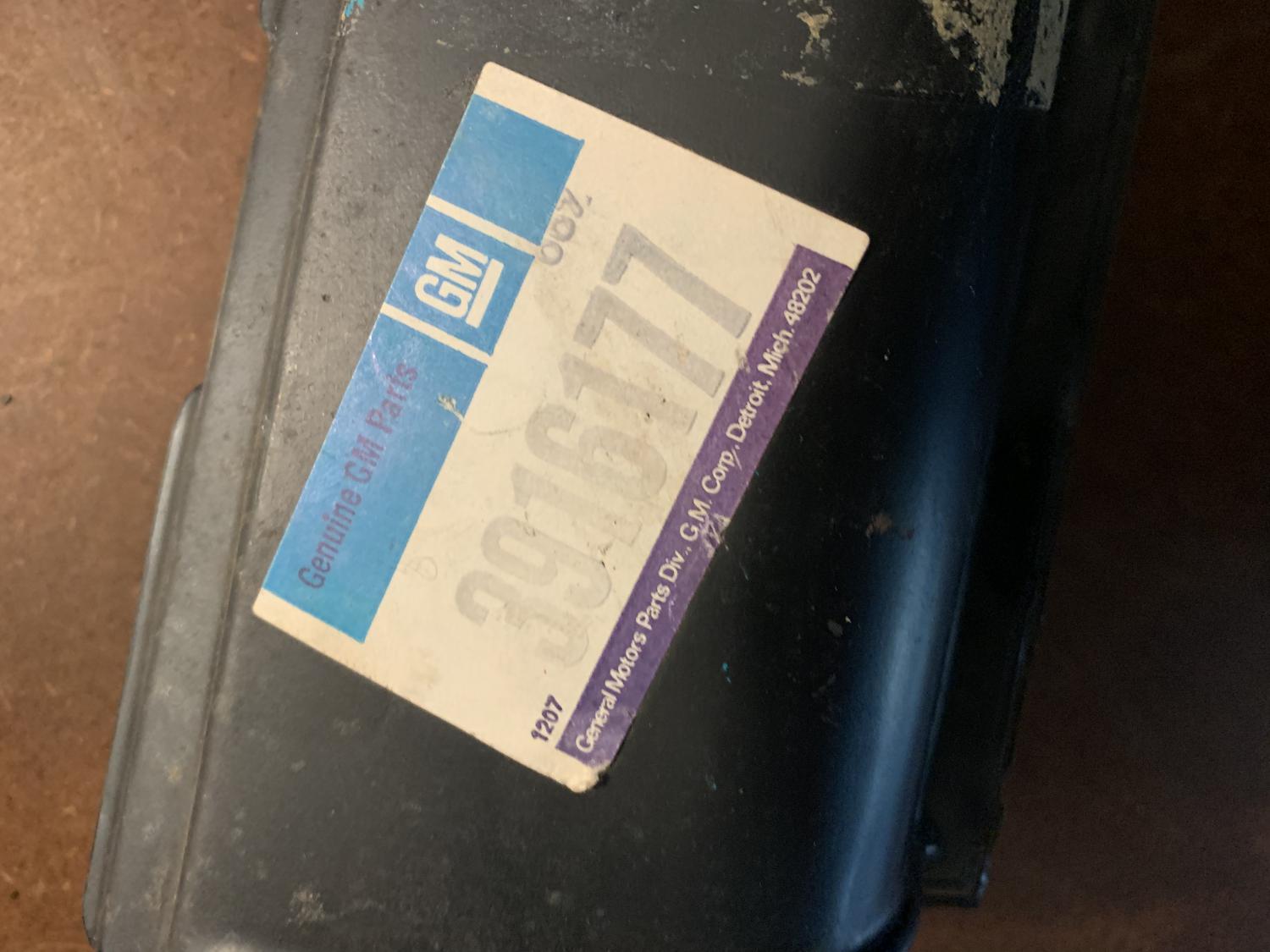

Part numbers
3916177
3964265
I am trying to figure out what models it would be correct for. From what i understand its all BBC 68-72 Chevelles EXCEPT L78, LS5, and LS6 and any 427. Anyone have any insight?

Use this site to look up your parts. They're both listed...Joe

Thanks Joe, got it!

I believe they are 1969 Full size 427 Chevrolet heat stove parts that connect to the air cleaner snorkle, but that's my memory by looking at them.

Casey, I looked in my 1982 parts and accessories book and part #3916177, duct carb to air cleaner fits 68-72 Chevelle, 68-70 passenger, 70-72 Monte Carlo with big blocks except special high performance. Part #3964265, extension carb air heat duct fits same models as the other part. I hope this helps you.
