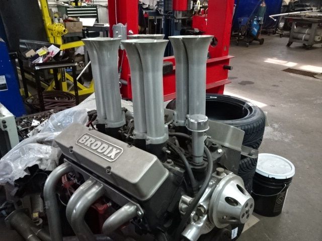

327 engine he ran in it. Genuine vintage Enderle mechanical injection system. At the end of the '71 racing season, he pulled the engine to rebuild it and have the body restored. Sent it to a local place that blew the car apart, lost/sold much of the hard to find trim and then went out of business. He had the engine and injection system rebuilt while the body was being molested. It's been sitting around the shop in various places for the 13 years I've been around. He told me yesterday, it hasn't turned over in 50 years.. I thought he was doing that every so often. Monday, I will pull the plugs, spray some oil in the cylinders and turn it over.

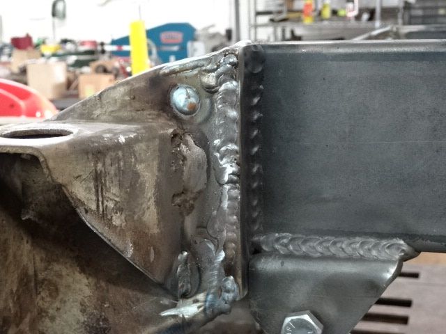

He had bought a straight axle stub about a year ago, and acquired a 1957 rolling chassis about the same time. We got the chassis on the frame rack and I cut off the front and, after MANY hours of measuring and leveling, finally welded the stub on.
After I cut the front off, the frame acquired a slight diamond, with the left rail moving ahead about 3/8". I put a porta power between the rails and easily pushed it back before welding.
