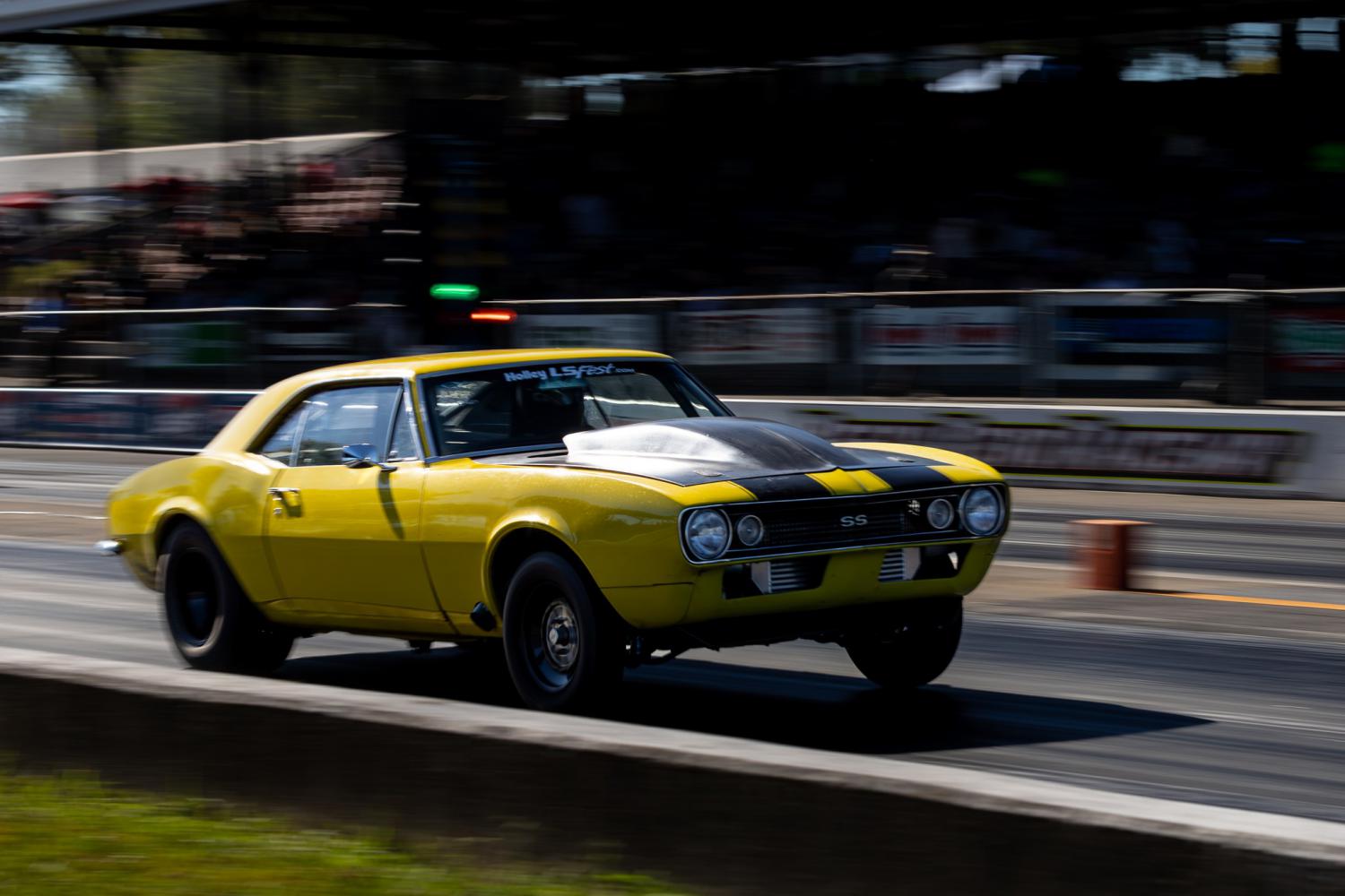

This is what I started with, I did a trade + got some cash to me, and picked up this 1967 Camaro that was a pro street car. Bought it near Rockford, car was supposedly from Lisle though I've not come across anyone who knew the car.
As it sat, it had a 502 later crate engine, 8-71 supercharger, T350, and a 9" with 31 spline guts. Has full tubs, ladder bars and a 10 point cage.

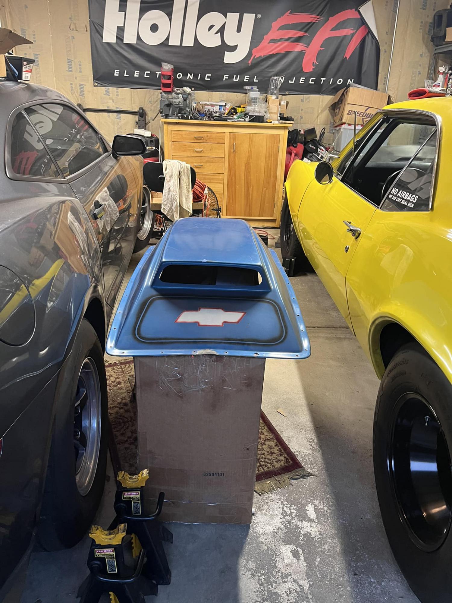

Thanks, it's been a lot of work and have gotten great help from friends.
I love the look of 1st gen Pro Stock cars, so I'm interested in any leads for a Grump lump style hood (bolt-on) and even some driver quality Cragars (15x3.5 fronts, 15x14 4.5 rears), maybe would consider Centerlines too.
